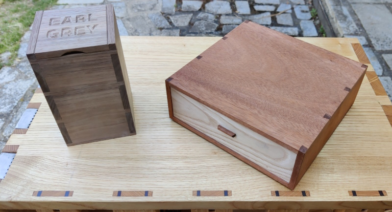

For background, the primary reason I did this project was to practice hand tool woodwork without having to worry too much about aesthetics (which are not my forte). Less significantly, I also wanted the ability to take a tool kit on holiday and be able to make small boxes and such-like. Since Carolyn has had M.E., she often needs to spend a reasonable amount of time resting and I'd go spare if I just had to sit around reading all day, so having a little project kit with me helps keep me sane.
This chest (made out of Sweet Chestnut, American Black Walnut, brass and stainless steel) gives me the ability to carry all the tools I need to make boxes and such-like, while also providing plenty of different work-holding approaches.
All the woodwork (with the exception of a few "resawing" cuts on a bandsaw) was done with hand tools. All of the metal bits were also made by me, but not with hand tools, because hand-tool metalworking is just silly
Front view:
Front open, showing the doe's feet tucked in place:
More views of the oiled drawers in place (you can also see the brass number plate in the drawers that are sticking out - the drawers are intended to be removed when the chest is being used as a workbench, so the numbers make it quick and easy to put the drawers back in the right place):
Planing stops; the little brass pins at the bottom are used to push the planing stops up and down after loosening the brass knobs:
The photo above also shows the leather lining on the vice jaw.
Back view:
Close-up of a vice screw and a wedged tenon (the knurled stainless steel knob holds the cross-bar in place; the steel screw has a small brass wear pad on the end to stop it damaging the cross-bar):
View showing the whole of the back with the anti-racking piece (which stops the chest twisting when planing stuff on the top):
Work holding:
Holding a piece in the vice for sawing (similar set-up for planing the end/edge):
Removing the middle vice screw and holding a wider piece:
The vice jaw can be completely removed and then really big pieces can be clamped to the back for sawing to length or edge planing:
or clamped to the top for sawing or chiselling or whatever:
The planing stops can be used for simple face planing:
Or for a bit more robustness, a doe's foot can be clamped to the top:
The vice can also be flipped round (so that a solid face is against the chest rather than a leather face) and then moved up and down (this photo shows the upper limit):
That allows boards to be fully constrained while still giving complete access to the top surface:
Finally (I think), there's the chest front / shooting board, which goes on top and pushes against the planing stops (this is the main reason for having three planing stops - so one is far enough over to support the shooting board near the working side)...
...which can be used for shooting ends square (with a block plane I also made, including the blade, as part of this project):
... and shooting mitres:
