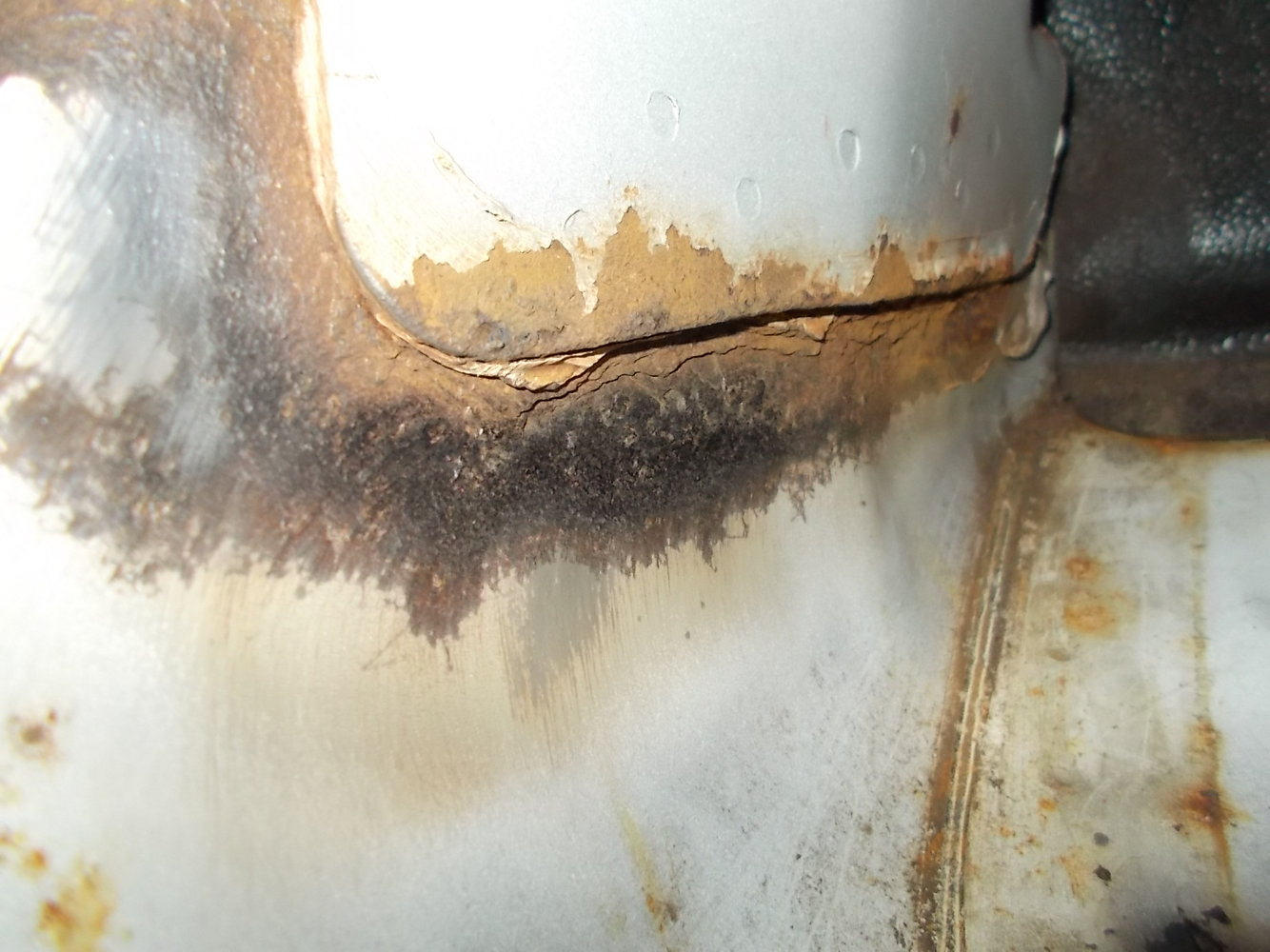

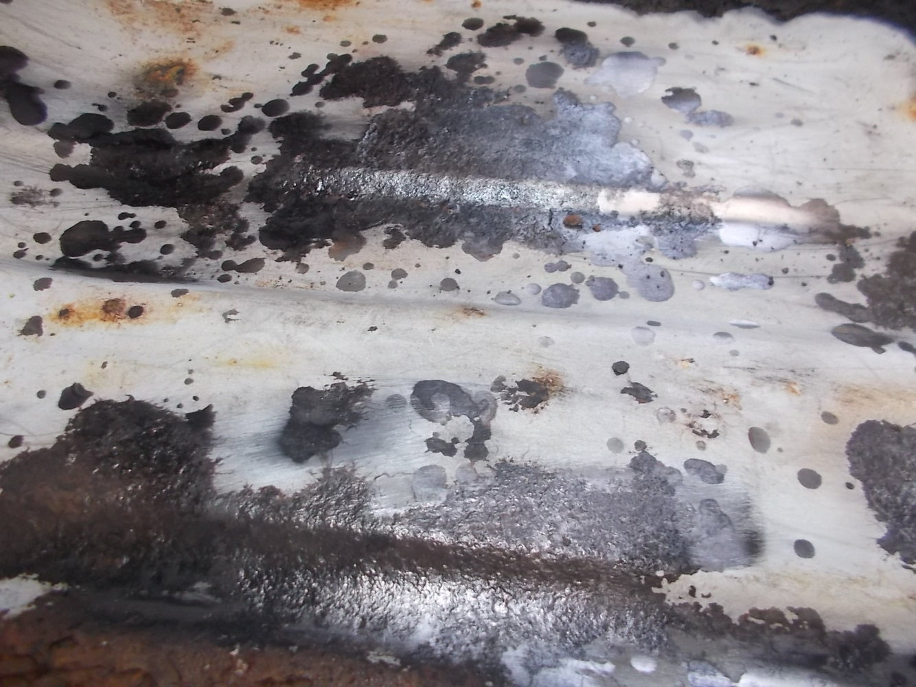

It's a bit pricey but if the floors that bad, it looks like you can get the whole floor as a panel, which you could then just cut the bits out of you need. Although it's expensive it might be cheaper in the long run as you won't have to try and fabricate the strengthening ribs etc.back to an earlier question i asked, part of the floor will need welding but rather that doing little patches would i be better off making a larger plate for the floor which would deal with more rust holes and areas which are heavily pitted which would probably turn into a rusty hole 3 years down the line? next question same subject, the floow is not a flat floor it has like grooves or valleys so when i come to do it how do i get a sheet metal onto a floor which is not flat? or is this where fabrication comes in which means loads of little plates in different places, i would rather cover a larger area and just have it done with!
That's no problem. Treat your Mrs to a few nights away in the van before you cut the floor out of it. Just don't tell her the final destination until you've picked up your new panel, by which time it'll be too late for her to do anything about, and she'll have had a nice holiday anyway.found a full floor pan but its pick up only as its to big for a courior to transport so

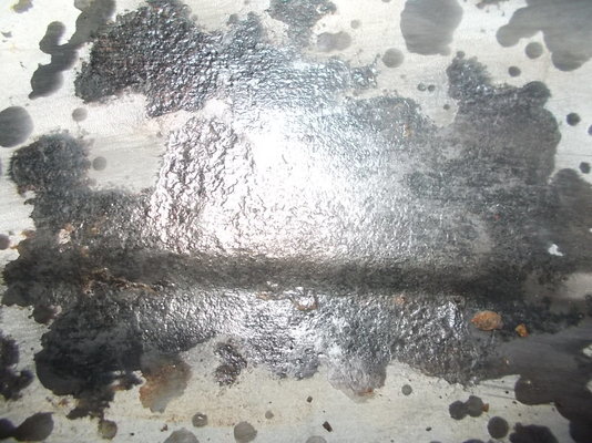

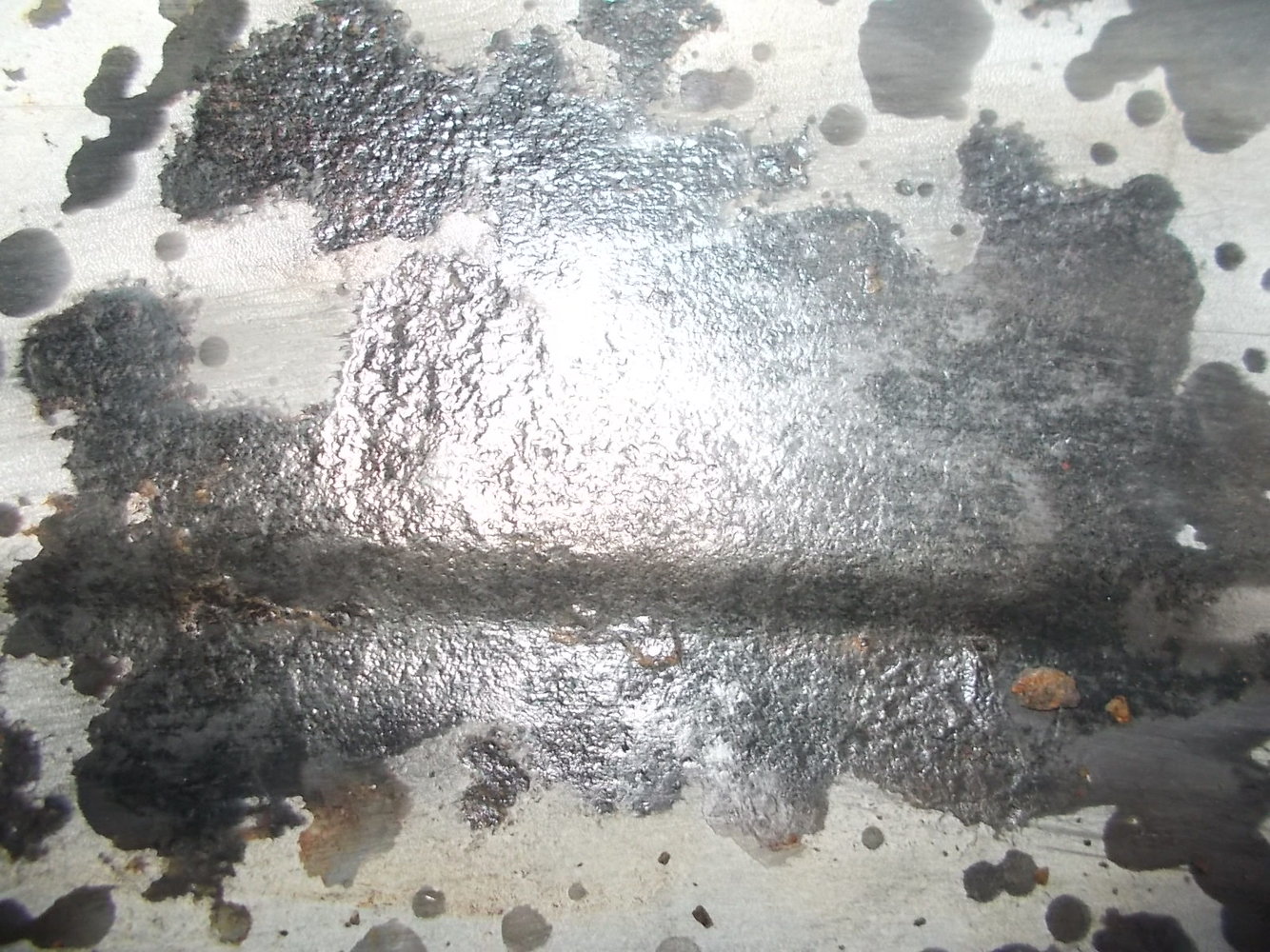

Could get away with this back in the day. Concrete also !Bit of mesh some fiberglass filler and some hammerite MOT in a can.
job done.![]()
job done.![]()
amazing what some try to put t through an MOT..Had a mini years ago, previous owner had made /fitted a sill using timber and gagged it in underseal. that made the mot guy chuckle.
