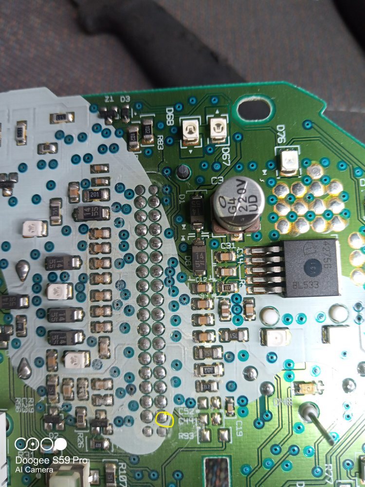

I had exactly the same on our mk6 campervan some years ago, all just died. I sent it to Cluster Repairs who mended it & charged me £100. When I spoke to them prior posting it, they knew straight away what was wrong. Never given any trouble since.

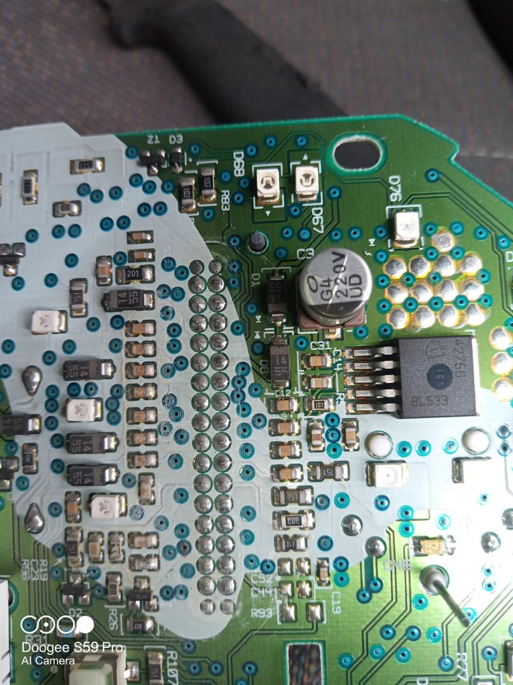

Haha yup that's itIt's a common fault just bash the top of the dash and they come back on The joints need reflowing and add a bit more solder.
£100 Owch.
Total time to fix inc taking it out less than an hour.
Time to fix once out less than 5 mins.
