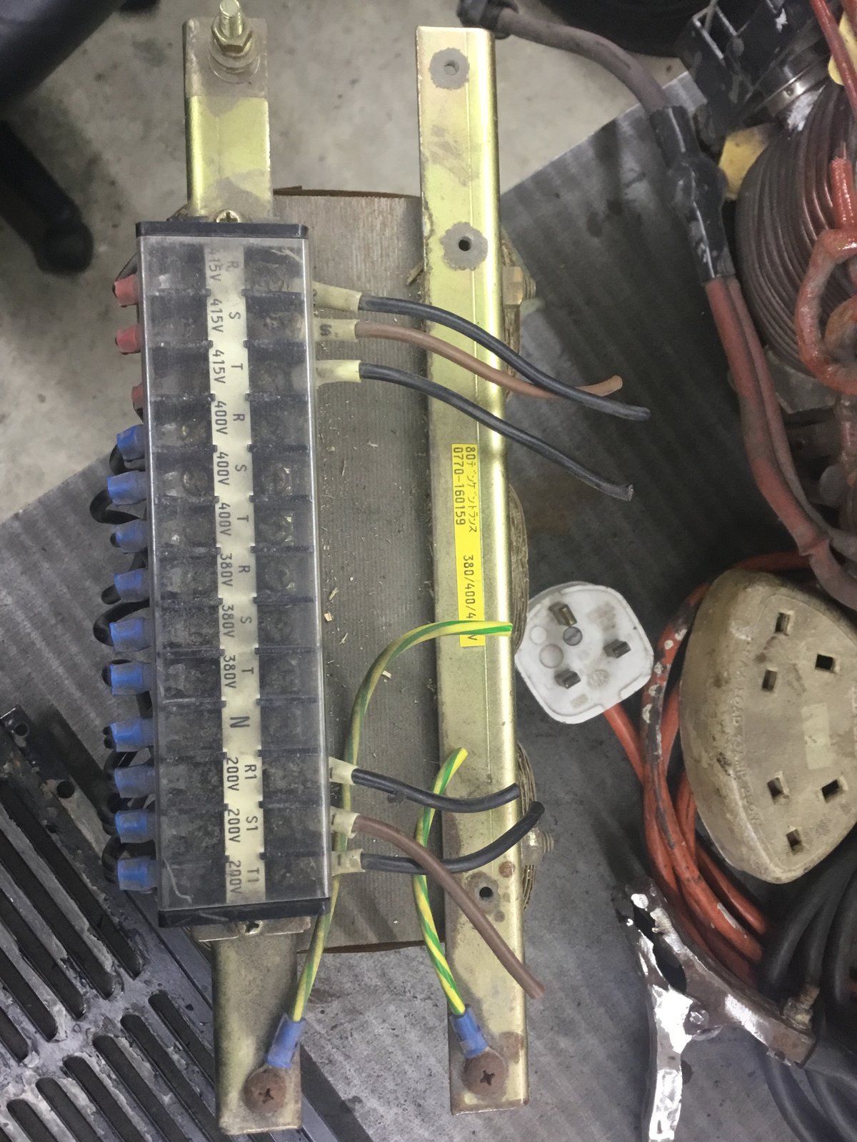

Most will state that you can’t have any reactive load.
They do. But what is an induction motor if not a reactive load?
Have a look here, not sure if it’s much help as the guy never replied with what he did.How about powering it via a VFD would it harm the vfd
Some good points mentioned about the frequency and harmonics, if I were to try it I wouldn’t run it as a vfd by adjusting the speed but as a “fixed frequency” converter at 50 hz.

I’m not advocating that connecting a vfd to the transformer will work, as I’ve never done it myself but there’s a good chance it may.
