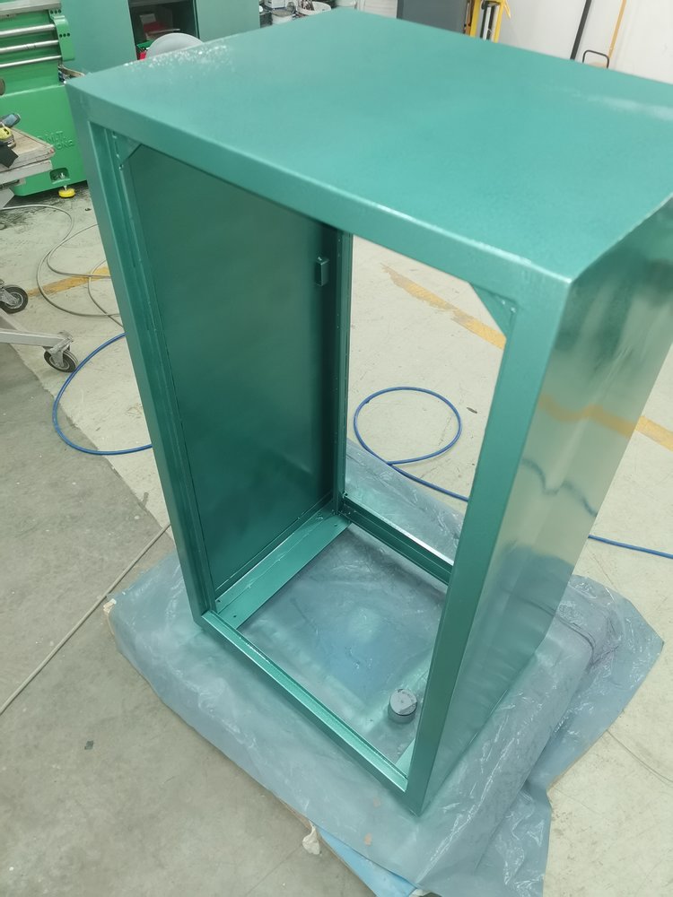

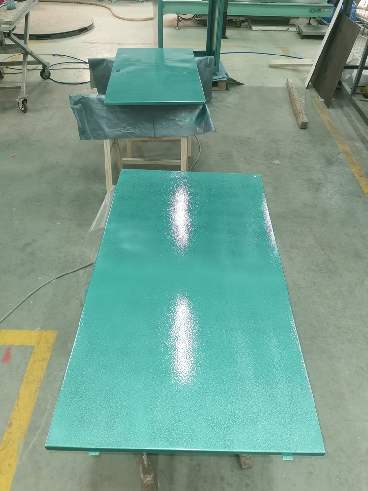

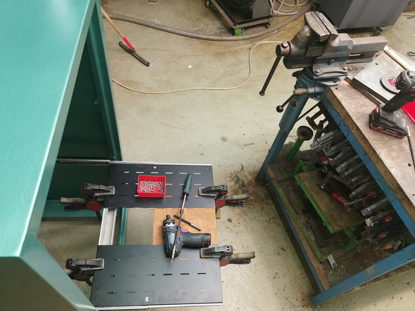

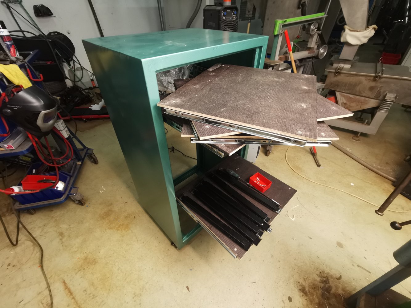

Sergei Slovenija Member Messages 1,256 Location Slovenija Ljubljana Nov 24, 2022 #22 Almost done. I will redo the shelves. Cold, alkyd paint dries for a long time.

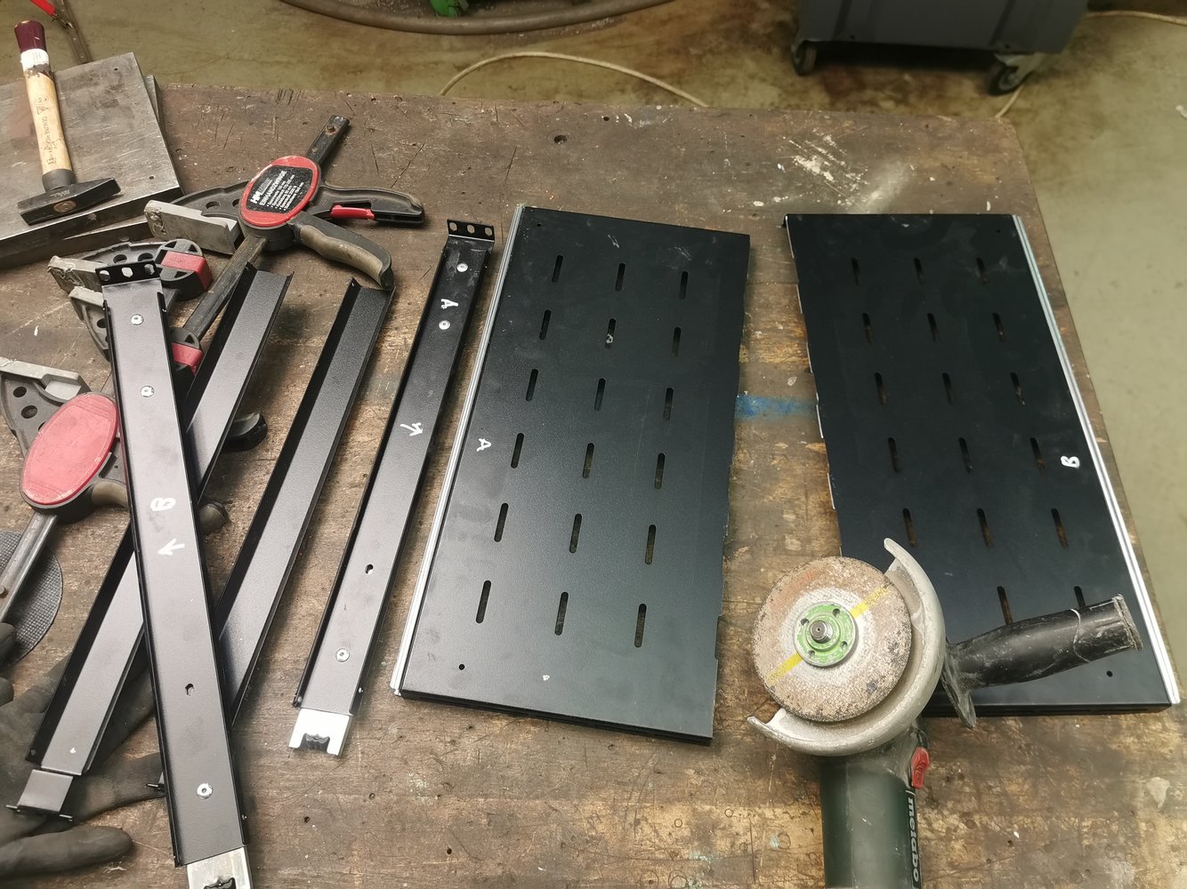

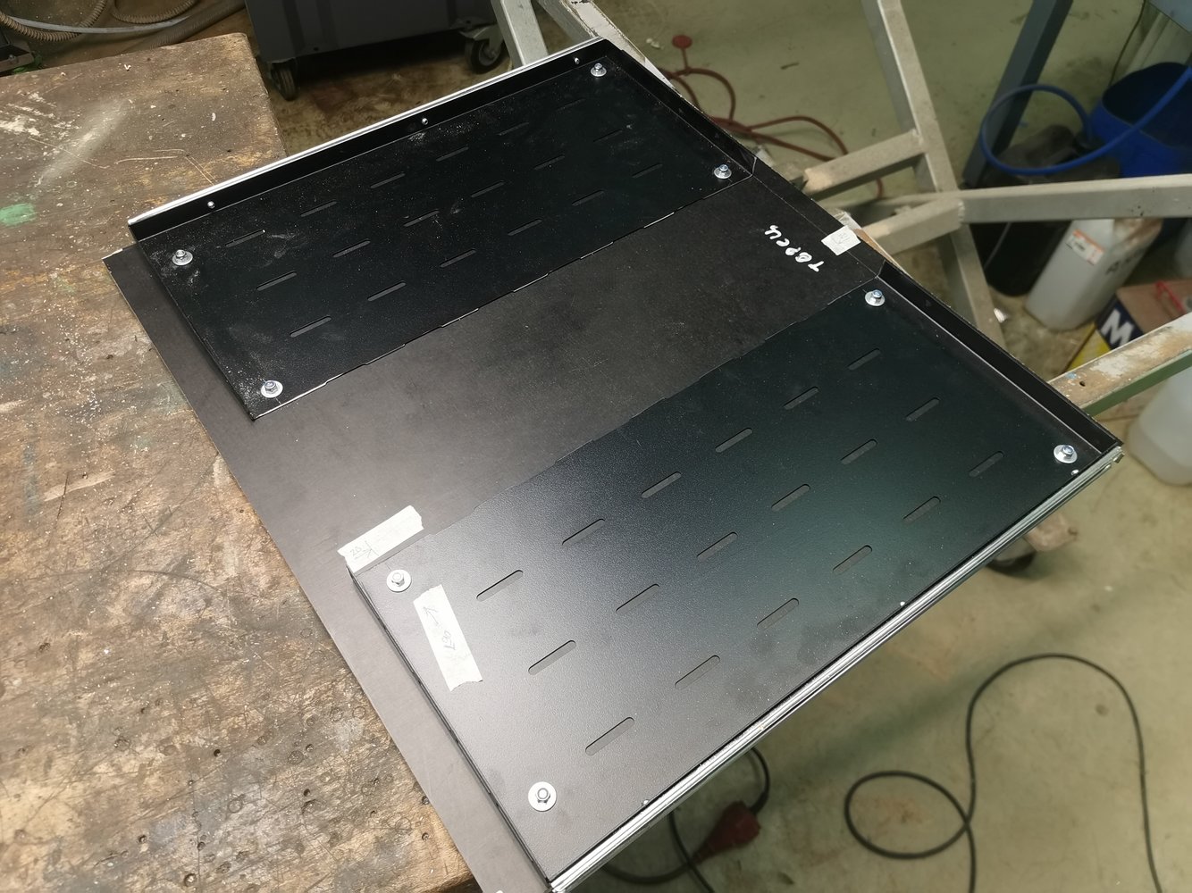

Sergei Slovenija Member Messages 1,256 Location Slovenija Ljubljana Nov 26, 2022 #23 Modeling and resizing of sliding shelves.

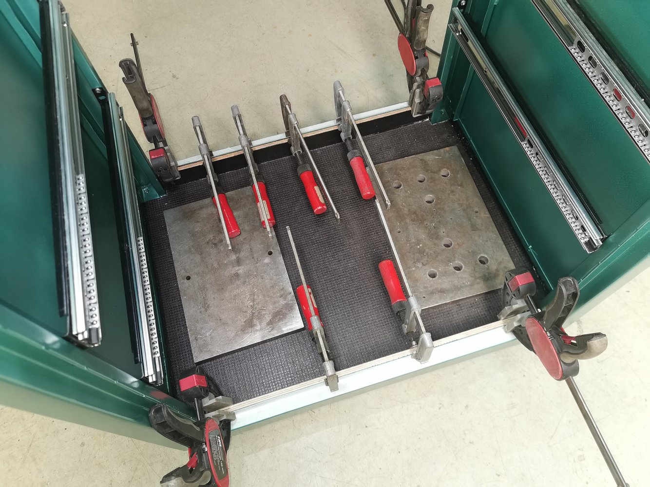

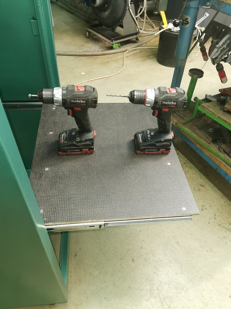

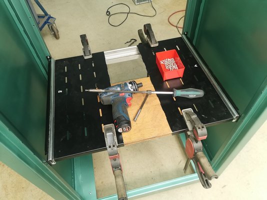

Sergei Slovenija Member Messages 1,256 Location Slovenija Ljubljana Nov 26, 2022 #25 I am waiting for the delivery of a jig for oblique drilling, for a 6 mm screw head. I'll try to make the sides of the box on three sides. Shelves are ready.

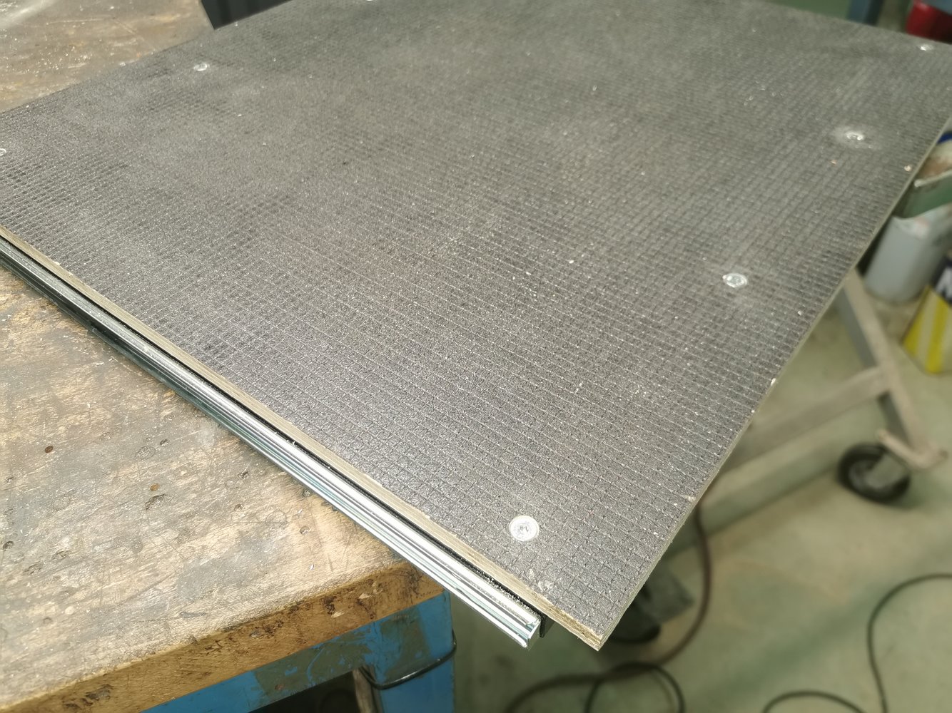

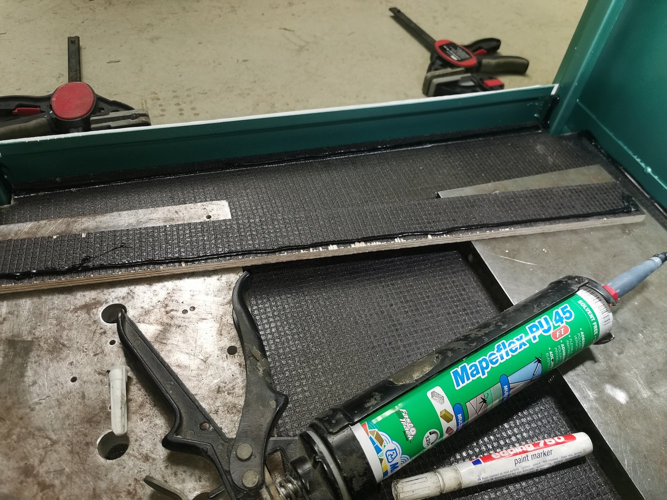

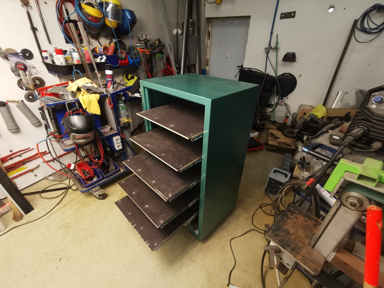

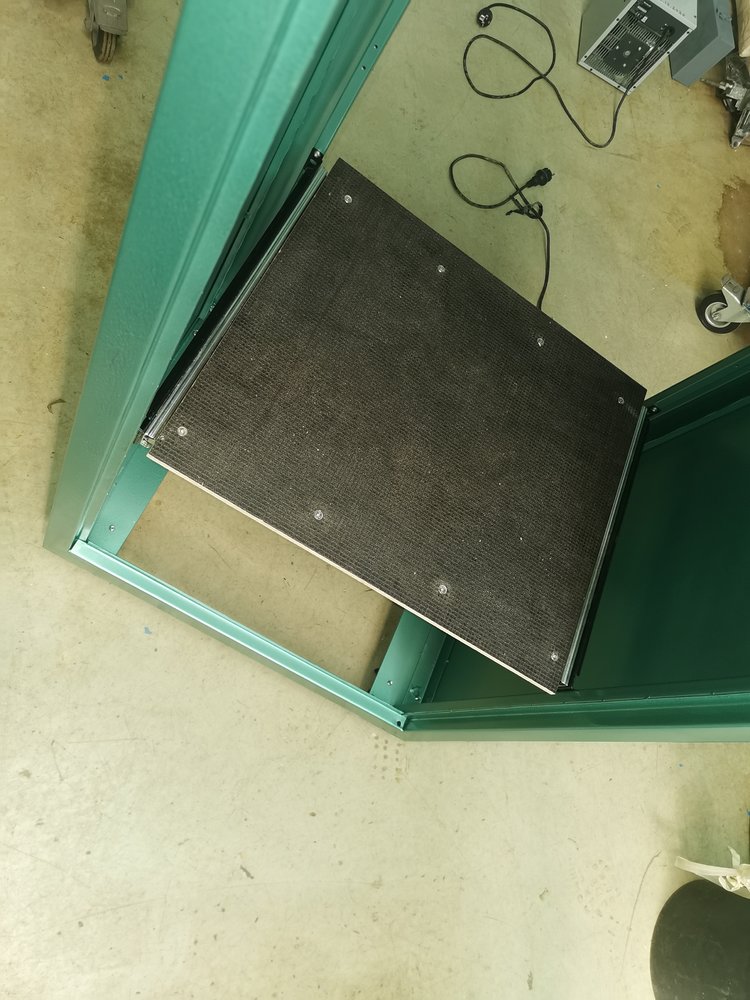

Sergei Slovenija Member Messages 1,256 Location Slovenija Ljubljana Nov 27, 2022 #26 Inserted the plywood bottom into the chest using PU sealant + two side vertical slats. So that the little things do not fall into the cracks. In the lower compartment I will store rarely used tools.
