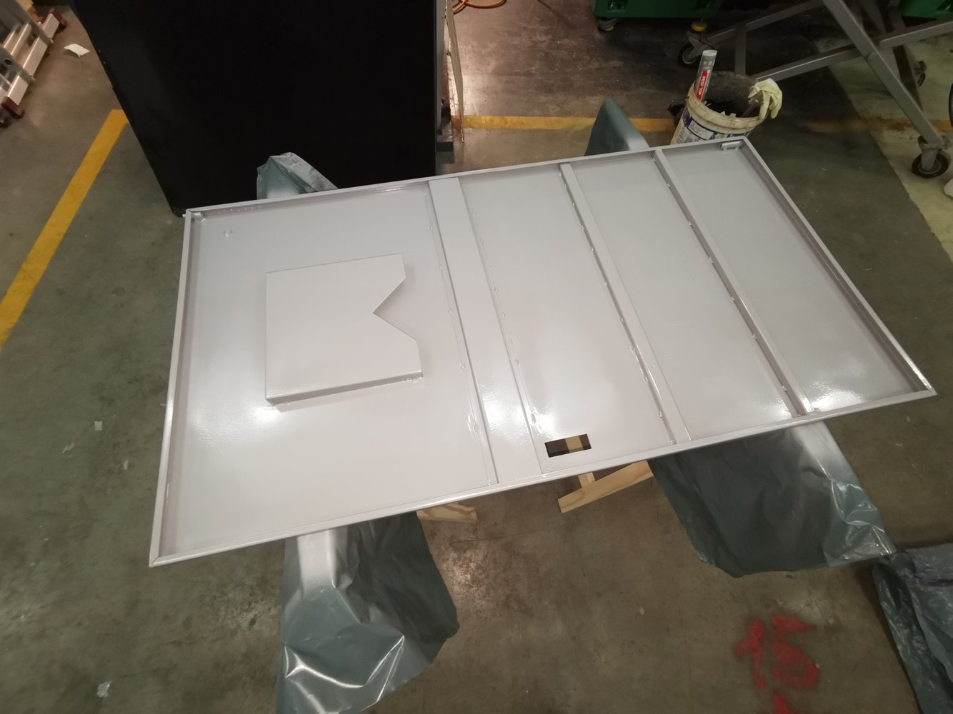

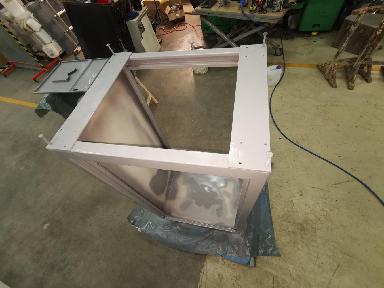

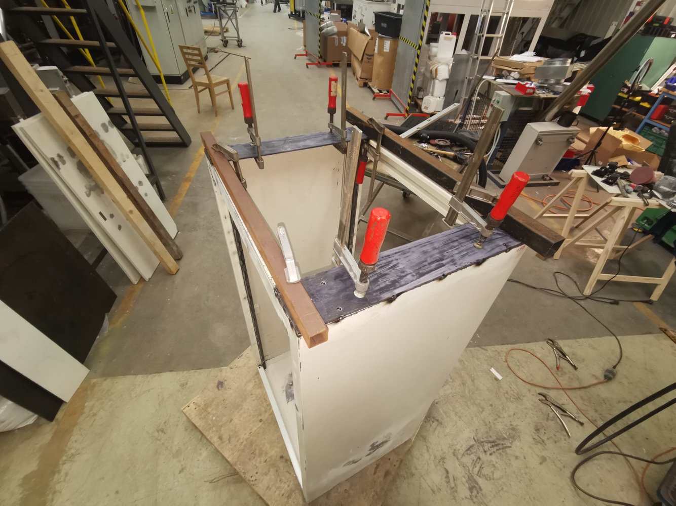

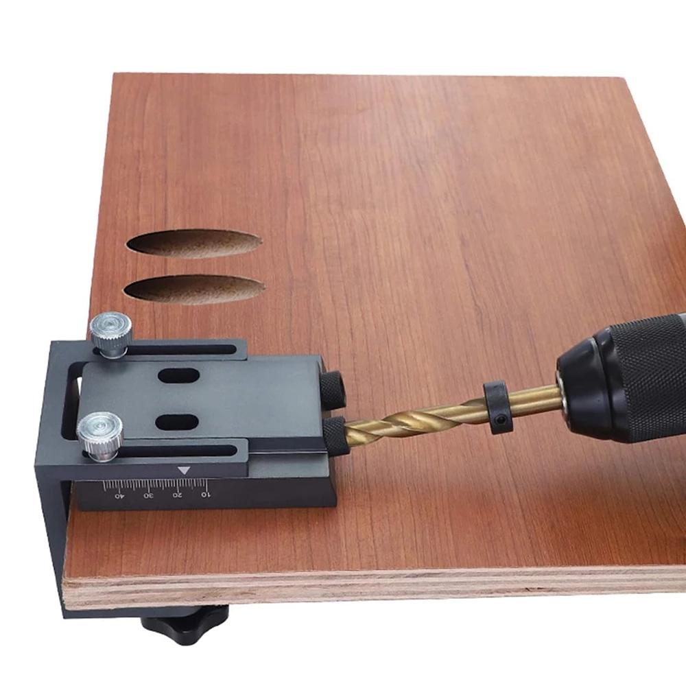

I will have to cut the 19" shelves in half. The width of the shelf is about 10 cm short. And implant a sheet of marine plywood, 9 mm thick, on hidden screws, connecting the halves into a monolith. It is a pity that there is no jig for sale, for using oblique drilling, for such a thickness plywood.It was possible to make the sides of the box / shelf on three sides, with reasonable strength... The shelf forward projection is excellent, 50 cm and there is a margin in depth.Looks good man

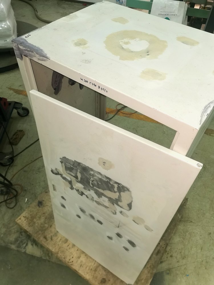

Spent 2 hours picking up a jig, a 6mm step drill and screws from various sources. Krag screws for a length of 12-15 apparently do not exist. Spax has similar ones, we'll see.That’s it![]()
