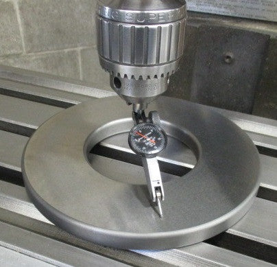

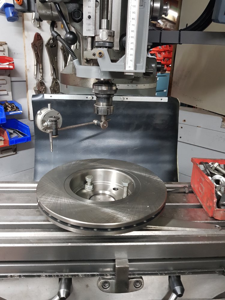

Just wonder if any one else has used this method I have used parallels before but this was dead easy took less than five minutes to get less than 0.01mm movement in x and Y
just in case after i checked with disc at 90 degress and 180 degress in case of error and in another area of table , Not bad for a £25 disc !
