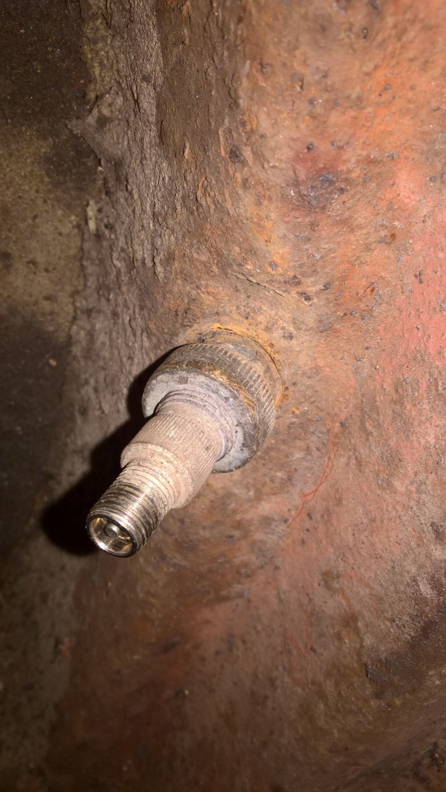

What about getting rims galv'd ? They will be pickled in acid to remove rust and then you'd have a sound base to paint.

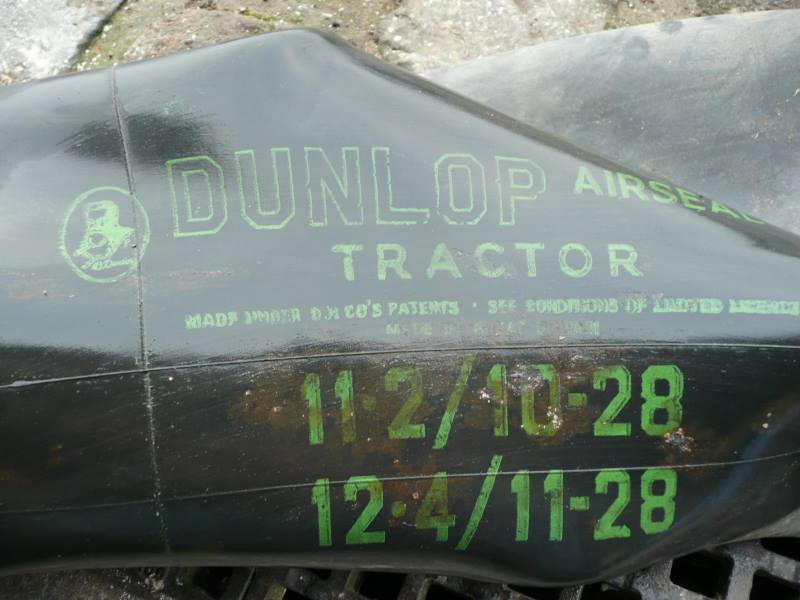

Think you will find 11.2 is tyre width so 12.4 are for boy racers???Thanks everyone...and thanks Mr brewdexta for dragging them out
@brewdexta (Or anyone else..) what is the difference between 11.2/10-28 and 12.4/11-28? Looking on ebay they are listed separately, and at different cost by the same seller so is there a difference?..or does it matter?
@Welderpaul - unless you've got a mate with blasting gear, you could end up almost as cheap getting new outers (if the inners ain't too bad)
Outers £134 the pair
http://www.ebay.co.uk/itm/FORDSON-D...557586?hash=item1a1f7edd52:g:gxAAAOSwo4pYIRuH
Whole rear wheels - £240 the pair
http://www.ebay.co.uk/itm/Fordson-D...535392?hash=item3cff7ec360:g:rtYAAOSw9N1VuMXg
is it corrosion or just paint in terrible shape?
They beyond needlegunning?
The 12.4/11 tyre is a little bigger both in height and width. If you're looking at tube sizes it won't matter, they're very flexible and usually dual marked with different sizes anyway. Last time I looked eBay was a very expensive place to buy tubes.
