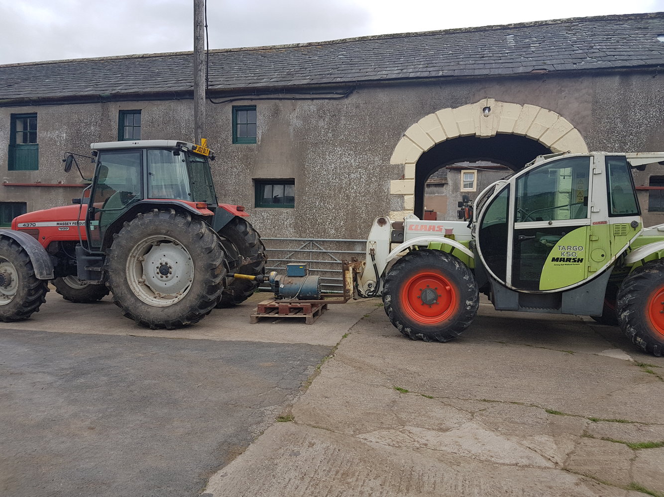

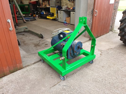

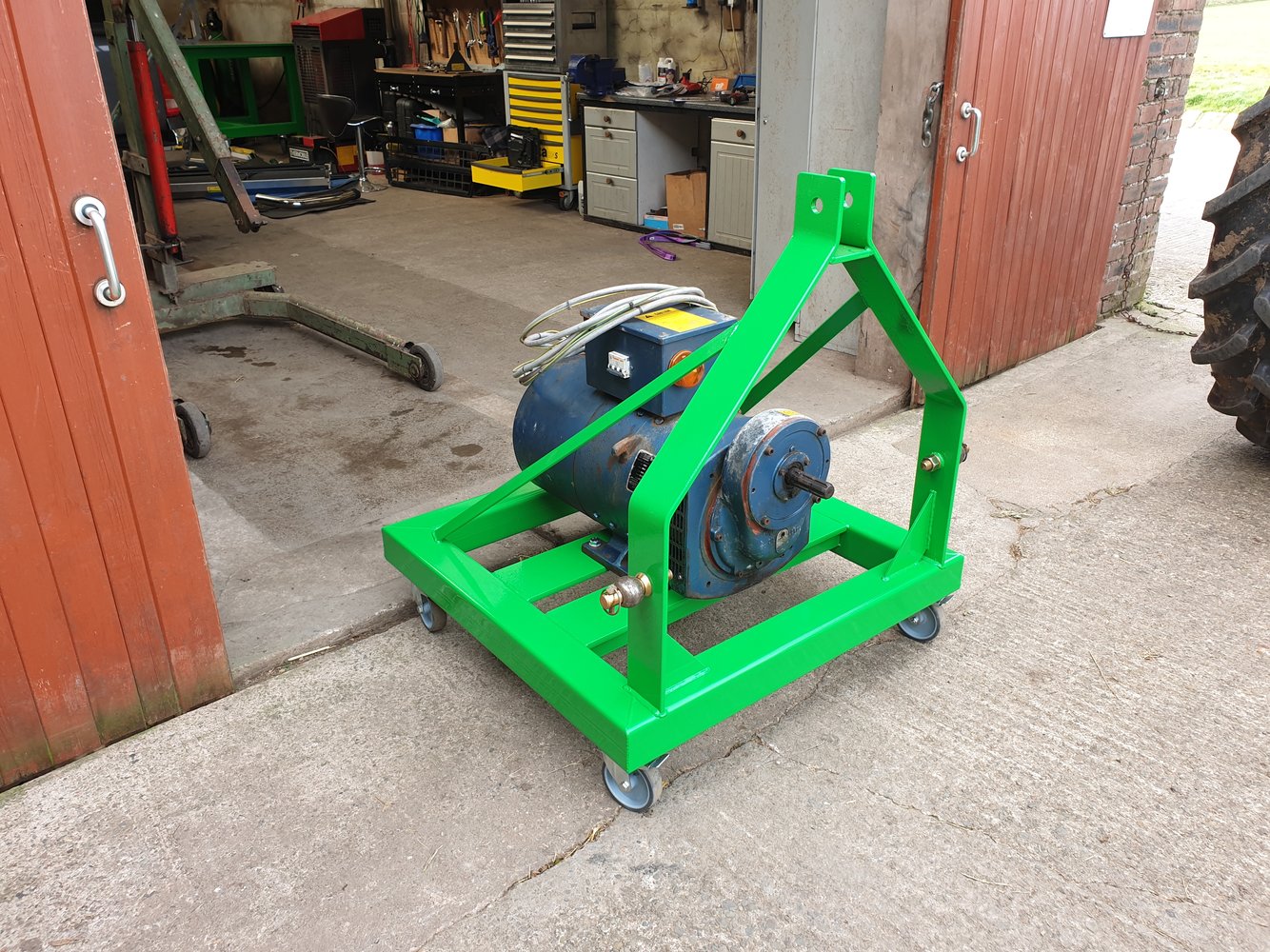

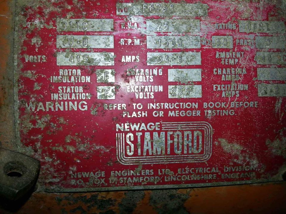

Seen a tractor driven genny for sale, £200.00, I don't have a tractor, I want a genny for the power cuts just around the corner, I do have an old Thwaites dumper with a half decent petter / Lister twin cylinder diesel engine, looking at the data plate this looks adequate to me, what is the DOR of a PTO shaft, would a twin cylinder engine described above likely run this, The dumper is rusting away and getting in the way, am I stupid............
To be fair, we only used to run the thing around 20kw ish as the supply cable and plugs were only rated to 32 amps. We gauged it by the temp of the cable...
