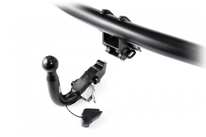

Same here Norm.
Guy bought an early Grand Cherokee V8 in Spain. Factory fitted towbar. Tried to pull a load at an angle and it bent. Asked me to sort it and I found the removable ball was locked by a bar running through the shaft. The hole had removed around 80% of the section and the bend was one side of the hole stretching to a waist. Completely unfit for use, but approved ??
