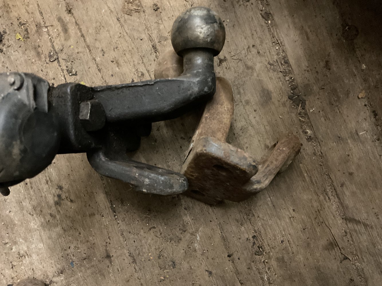

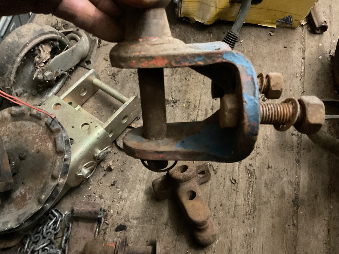

Cheers thanks for that.Can still be done with a pin/ball combo fizzy, got a couple that have about an inch more clearance behind the pin than the standard set up you can have.I am at Eds in a couple of weeks, can bring it with me.
Bob
Standard
View attachment 458937Wide jaw
What is a standard jaw designed for? 40mm?Can still be done with a pin/ball combo fizzy, got a couple that have about an inch more clearance behind the pin than the standard set up you can have.I am at Eds in a couple of weeks, can bring it with me.
Bob
Standard
Bob
Standard

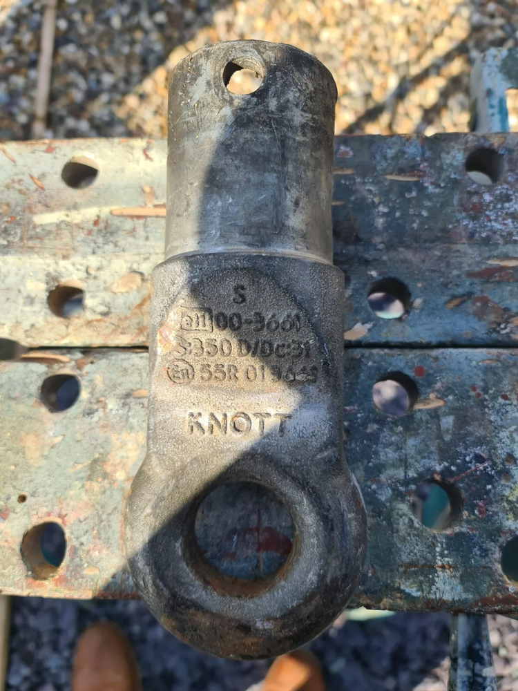

Not had much to do with ring hitches apart from using my home-made solid drawbar in my rally recovery days so been doing a bit of reading up and apparently the ring should be big enough that it contacts the back of the jaws before hitting the pin to apply the trailer brakes, every day a school day.
) make a slip in & out the tow hitch pulley so it nestles against the ring then use a bit of hydraulic ram as the pin , there must be some hydraulic cylinder refurbishers locally . Get them to put the top flange & handle on it and taper & drill the bottom end as required then specialist coded weld it for you . They might also have some already made pins for excavators etc. that are not cheap Chinese mild steel stuff.The over run brake friction sleeve might need adjusting as well as it is a new unused chassis trailer that has only had it's first run out journey . Adjust it so it take a bit of effort to slide the tow eye in and out of the trailer mounting tube .That's right, pull on the pin, brake on the jaw.
