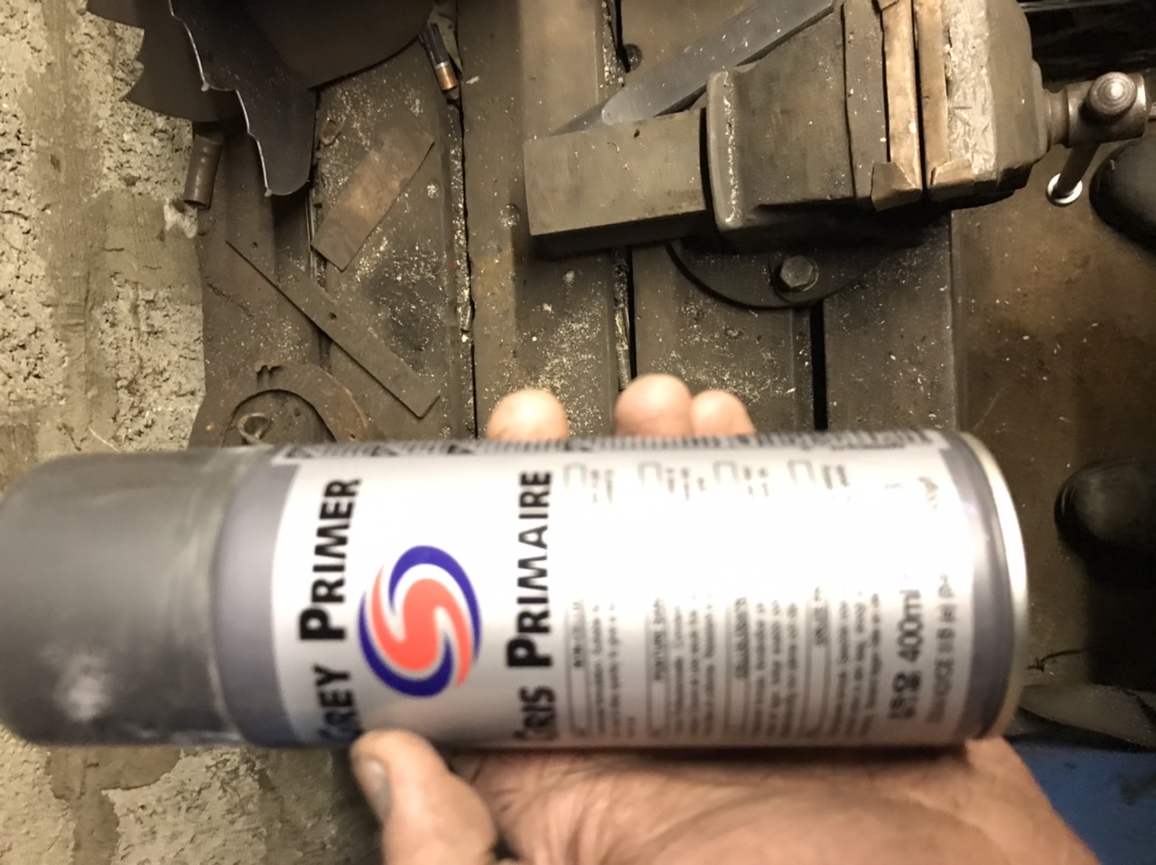

Had some issues where masking tape was left on for about 6 weeks when stuff got delayed in the mail, post b-word, going abroad but that’s a first. It says you can use it no primer if you have clean metal which is well keyed but I prime it. It’s fussy about primers, wrong one and you get blistering.
I was using tygris grey acrylic. It’s good but if it’s not 100% dry you get bubbles. I found better stuff a month or so back. Give me a minute and I’ll nip out and take a pic as I can’t remember what it is calledGoing to order a couple of cans to try then.
Which primer do you use for it then? I tend to use upol acid 8
