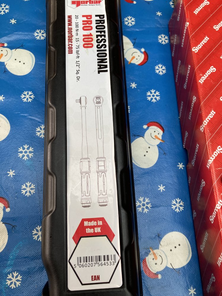

I’m sure mine is, I’ll grab a pic of the leaflet that came with it shortlyLooks like they're made in the UK unless anyone knows different.
