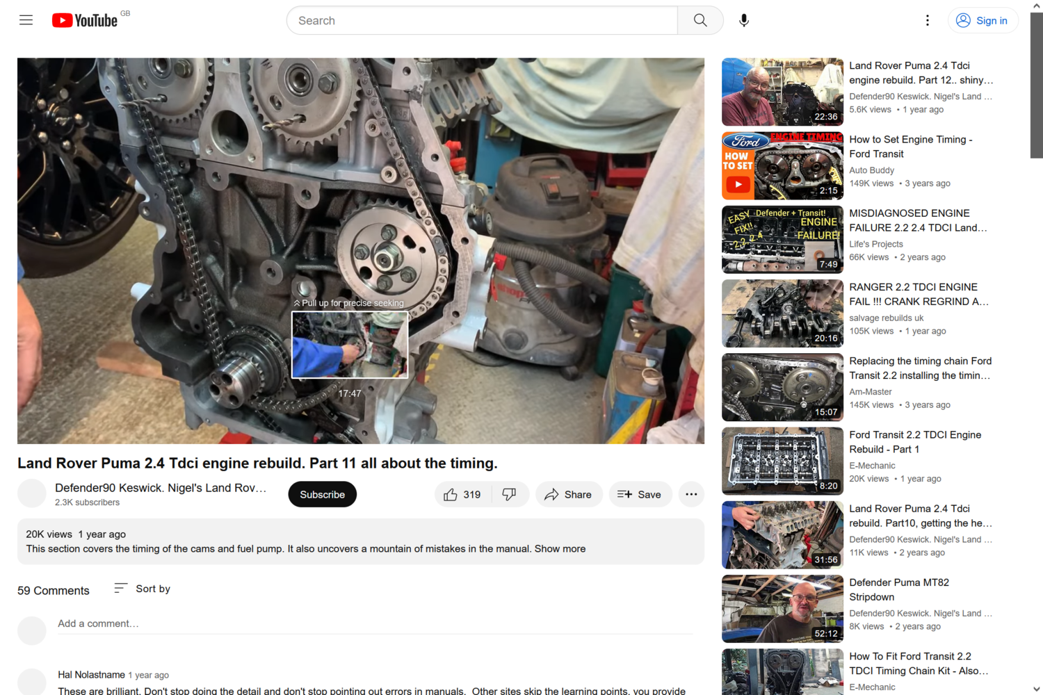

From what I remember, the pump flange/sprocket was essentially a carryover from the 2.0/2.4 TDDI's, so still had the timing holes/slots.Same for me - I do remember pretty much every PSA/Ford diesel HP pump had to be phased correctly or risk belt/chain breakage or stretch, the only exception was the 3.6 TDV8 'Lion' which has 120 degree opposing pistons rather than the more common 180 degree ones.
ETA - as much as I hate 'youtube for everything' this screenshot shows the timing link and the corresponding drilling on the pulley.
As you can see from the bolt pattern even though it's a keyless taper, the bolt pattern is 'key' to getting everything in the right place.
