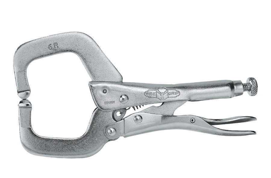

C clamps is something I would like to avoid because I think that is worst design ever
The screw is meant to bend
Other concerns about clamps are the sizes I don't know which size take
Ok these are what I call vice grips or better autolocking pilers (straight translation from Italian to English) this are ok they are useful in any size ,and I can take them cheap or expensive but I will probably get some good ones not this specific model but the simple because they are pretty handy when you have to deal with seized bolts and broken screwsNot sure what you think c clamps are, but I think they are one of the best clamps to have for versatility, you can't have too many.
