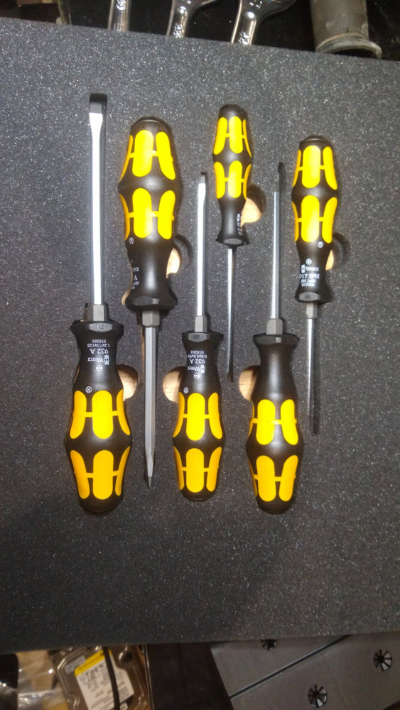

Take pictures of the things you want in the drawer, move them around on the screen, and load the file into a CO2 k40/etc laser cutter and cut the foam from generic foam you can buy in bulk cheaper than fancy tool inserts.
Here's the outcome with a set of screwdrivers to fit my generic cheap topbox.
