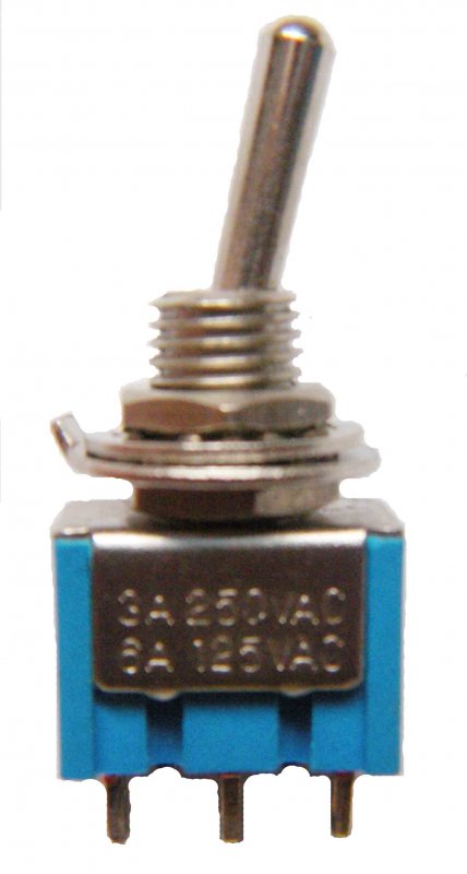

yes with a meter but why do u want a switch unless the one u have is knacked??then if it is u cant test itThanks, is there a way to test?
I stuck a meter on it and it was on, off, on.piman said:Hello Wheresmejumper,
if it is a three position switch it will likely be a simple single pole double throw on - off - on.
RS components have a huge range of such switches, but ensure that you select the correct operation as above and of suitable current rating :- http://uk.rs-online.com/web/?cm_mmc=UK-PPC-0212-_-Google_General-_-0_RS_Components_Brand-General-_-r_s_components_Exact&gclid=CjgKEAjwkpacBRCNlprWw-u-nBwSJACwHiw-d-AlXxoObPDcuAXD64Clu9yqzH28DVXA577UV2wrH_D_BwE.
Type toggle switch spdt in the search bar.
Alec
There was no part number, just vac rating.Is there a part no on other side, some of those switches have a momentary in one direction
