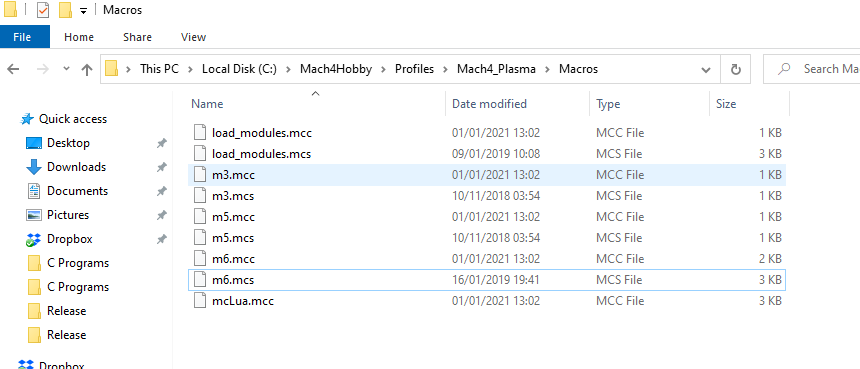

I’ll try and find it when I’m back in front of the laptop. Where would I look? In the Program files or within the SwiftCnc (Mach4) program?You'd need to look at the M12 macro, and try and work out what's causing it to get stuck.
Mach 4 will only be doing what it's programmed to do. It's likely to be something not responding how it should (output not activating/input not switching), which just causes the macro to hang waiting for something to happen. Which would actually mean whoever wrote the macro done a rubbish job, as they should have programmed in timeouts with corresponding error messages to aid with diagnosis, rather than just the machine appear to randomly hang. Or cynically, they done it deliberately so you'd have to rely on (aka pay) their support to fix it.
If you can find a copy of the M12 macro, I'll have a look and see if I can tell you what you need to check.
It will be similar to this.I’ll try and find it when I’m back in front of the laptop. Where would I look? In the Program files or within the SwiftCnc (Mach4) program?
I seem to remember that is the case but like you it has been a while since I used it so.......The only thing is, they may have added an option to compile macros, so they can be protected.
