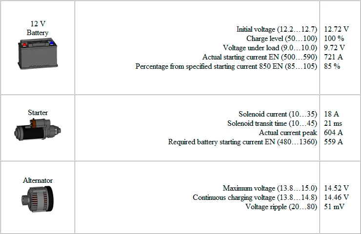

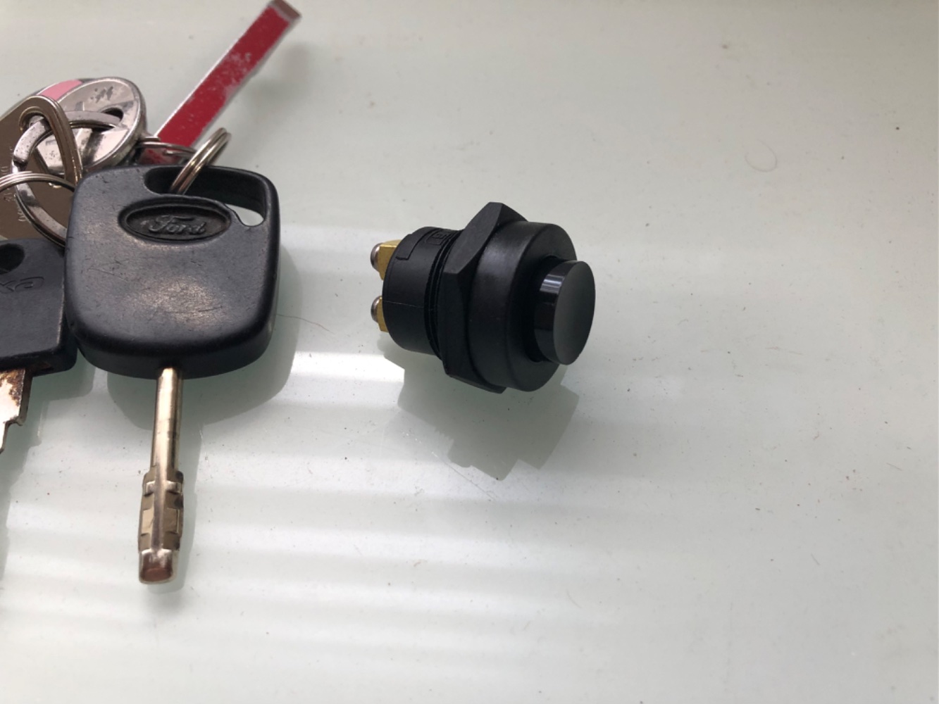

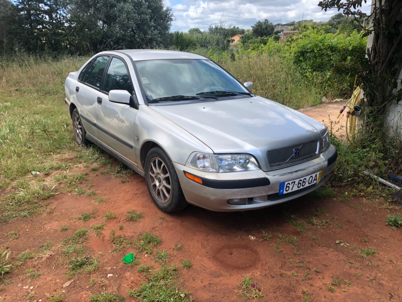

Hi folks.
I'm looking at an elderly Volvo S40 belonging to a neighbour.
Due to odd failures I'm wanting to fit a "Push to start" button to activate the starter solenoid.
The preferred choice would be to use a push button that can handle the power for the solenoid..
An alternative would be to fit a low power switching circuit with a relay that will activate the relay but that makes things more complicated.
The signal feed wire at the solenoid is a different colour to the starter circuit at the ignition switch so I suspect the car already has a solenoid...
I'm hoping I just need a low power push switch but would appreciate info from anyone who know these cars (no guesses please - I'm looking for solid info, I can make educated / uneducated guesses myself)
The question is, what amps will my new push switch need??
Many thanks
