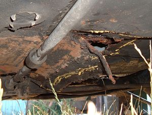

I need to make a new one of these as the one on the other side is way too nasty and crusty for Mr MoT man, its a body mount on my 91 lwb Isuzu Trooper
Cut the old one off (not very hard most came off with a prod!)
and found a hole between the old fixing points so decided a big 3mm steel plate would be the best bet.
Welded it on
