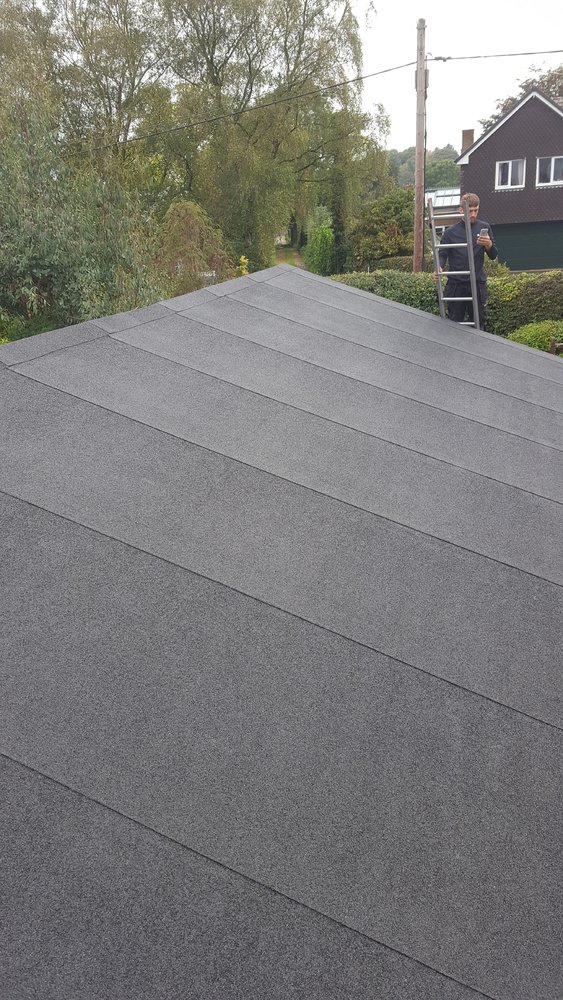

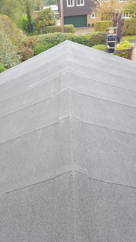

Good to see he's got 3 points of contact on that ladder![]()
61, whippersnapper what were you hanging about for making a meal of it
40 years plusLooks a tidy job, whats the life expectancy of that ?
He has..2 feet and 1 handGood to see he's got 3 points of contact on that ladder![]()
Really ! what sort of felt is it ? Does the fact its a slope rather a flat roof make a difference to the life span .40 years plus
Full SBS type felt over a base layer of SBS 2mm underlay.Really ! what sort of felt is it ? Does the fact its a slope rather a flat roof make a difference to the life span .
or cold blackjackFull SBS type felt over a base layer of SBS 2mm underlay.
Just pulled this from Google as it can spell better than me
SBS modified bitumen roofing is a material made out of asphalt and synthetic rubber, making it an exceptionally flexible material for flat roofs. ... This material works best on low-slope commercial roofs, and many manufacturers use glass, polyester, or composite reinforcements.
Torch on.what is it torch onor cold blackjack
