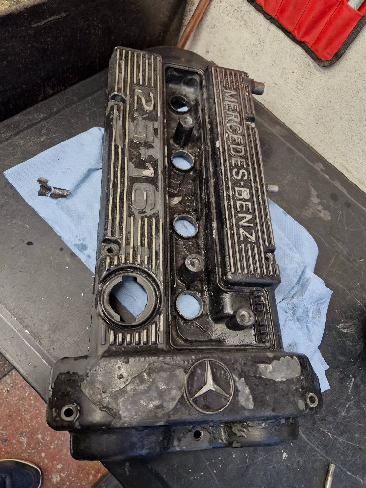

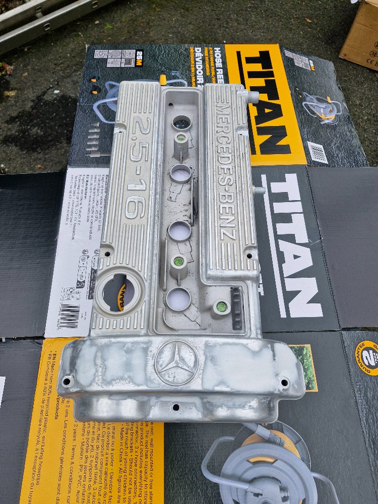

Its pretty amazing isn't it. The shot blasting process. You can take old gnarly looking rusted parts and blast off decades of grot revealing a shiny part below.
Just finished with this old magnesium valve cover. It had many layers of paint and a super tough original coating of paint.

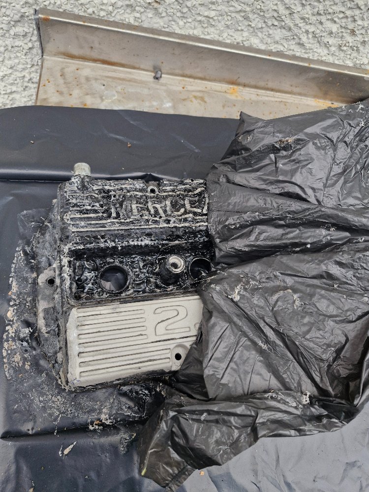

I started shot blasting it with recycled glass bead and it was taking way too long to break through the old paint. So I lashed it in paint stripper, covered it with a bin liner so the stripper wouldn't dry off and left it all day. The remaining old paint was loosened

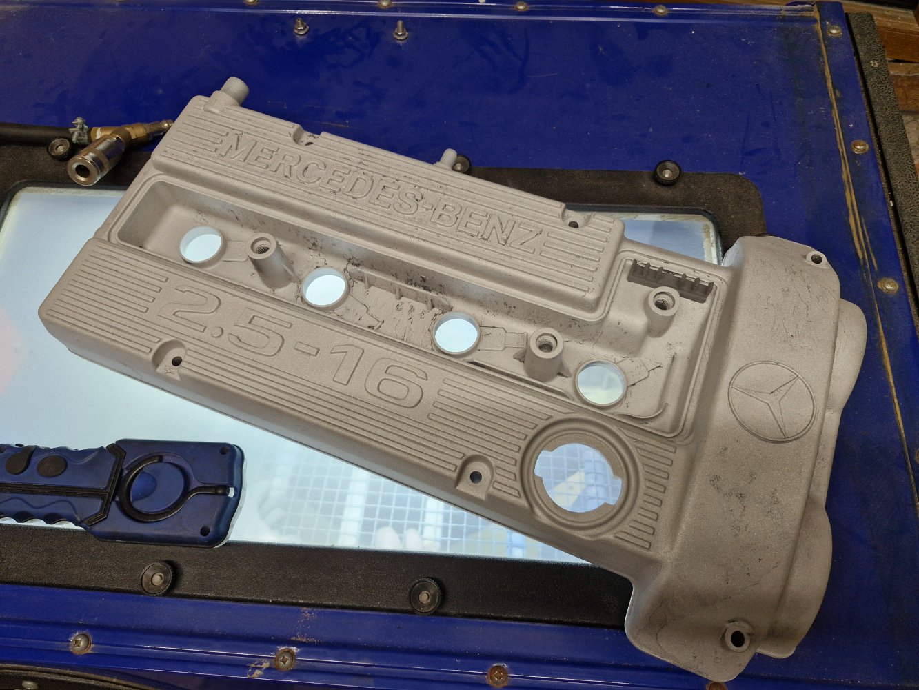

I then used my Lavor hot diesel washer and a 15 degree nozzle and blasted off as much paint as I could. Then about 1 hour covered it all well in my shot blast cabinet

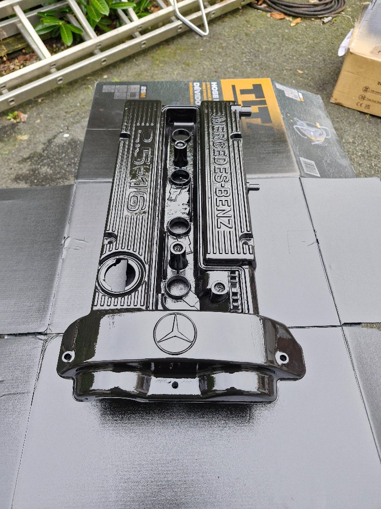

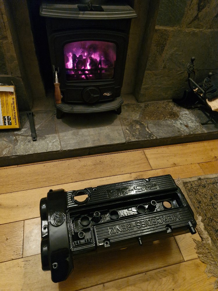

Some imperfections are showing so tomorrow I will use a small qty of body filler to fill those and spray it with several coats of gloss black high temp caliper paint.
