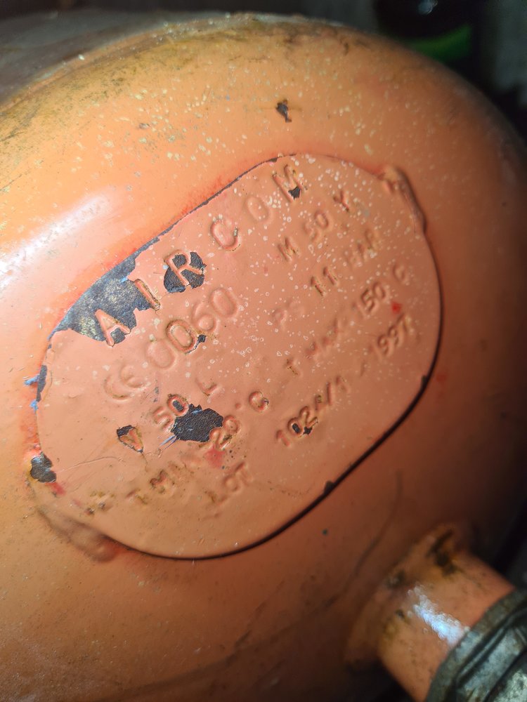

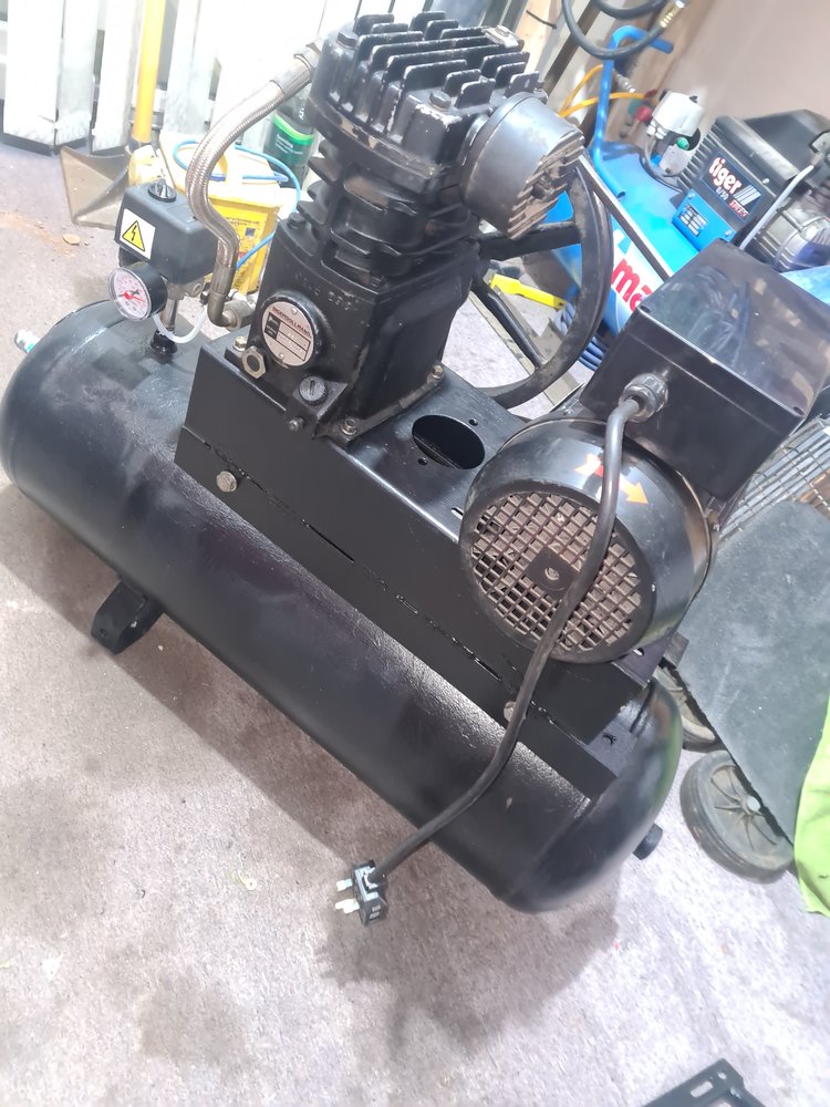

How much pressure should I test a tank at I'm looking at getting one of those hand water pumps one I'm looking at goes to 25psi I think
The real cheap ones go to 25Bar mate not psi - plenty of pressureHow much pressure should I test a tank at I'm looking at getting one of those hand water pumps one I'm looking at goes to 25psi I think
50% above rated pressure.How much pressure should I test a tank at I'm looking at getting one of those hand water pumps one I'm looking at goes to 25psi I think
swl ?25 psi is about the bottom of car tyre pressure range, so that would be no good!. 150% of SWL is normal.
as above ?50% above rated pressure.

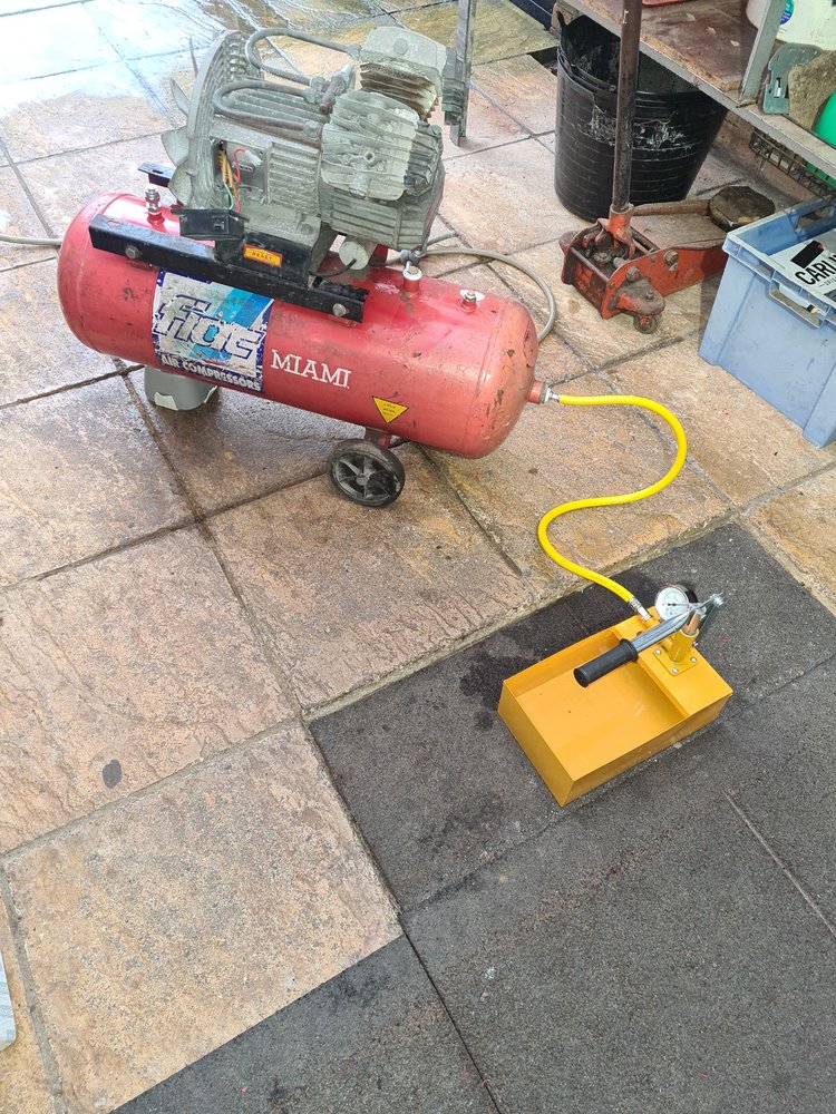

Don't forget to remove all the fittings and bung up the holes with with BSP black iron bungs (from your local plumbers merchant etc)
Fill the tank from the tap, using that pump to fill it might take days and your arms will still fall off before it's full.
You don't have to get every last cc of air out, but the more you do the less pumping.
I've got the plugs that I was going to test the old tank that failed so hope most of them I will have fitting forDon’t stand in front of any plugs when testing. If one fails, it will be ejected like a bullet. Covered with something that would absorb the energy of any flying plug would be good

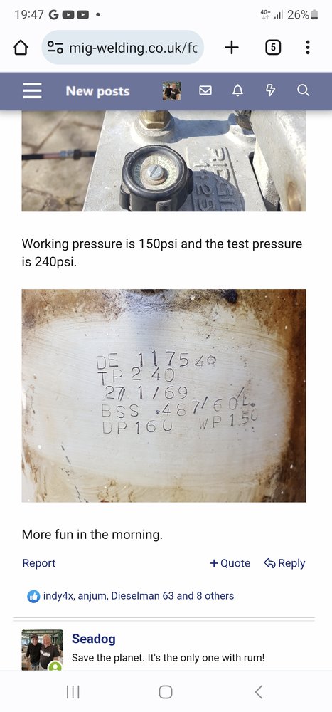

That 240psi test pressure would appear to be 50% above the safety valve (pressure relief) blow-off pressure.
and whats thatThere will be a maximum pressure-loss limit, in a prescribed time period, to pass the test. If it passes , empty the water and good to go with air, in order to test the safety relief valve is operating correctly. If that is OK, it should be good until the next test - providing the tank is drained as per operating instructions (or according to good operating practice).
