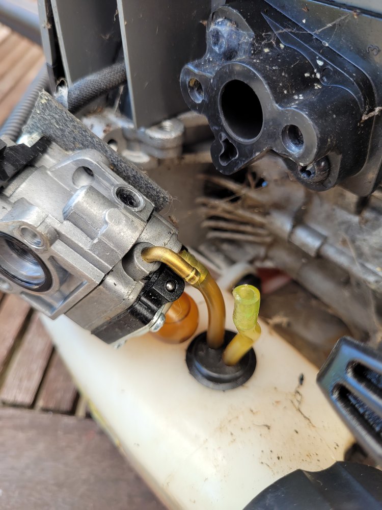

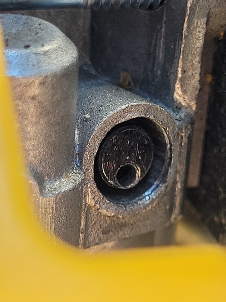

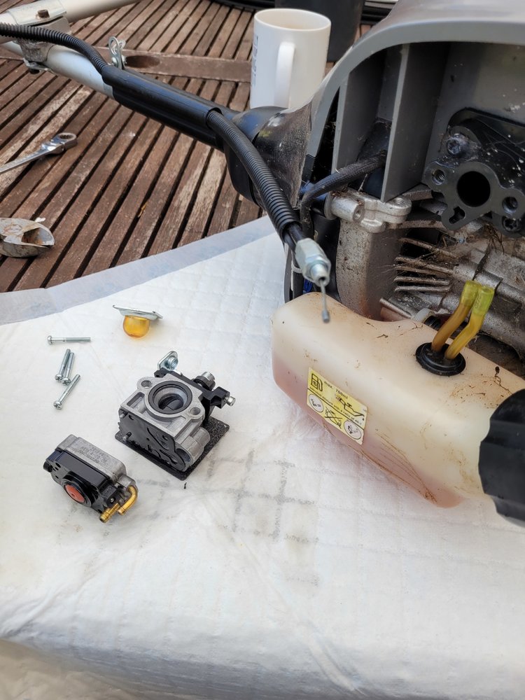

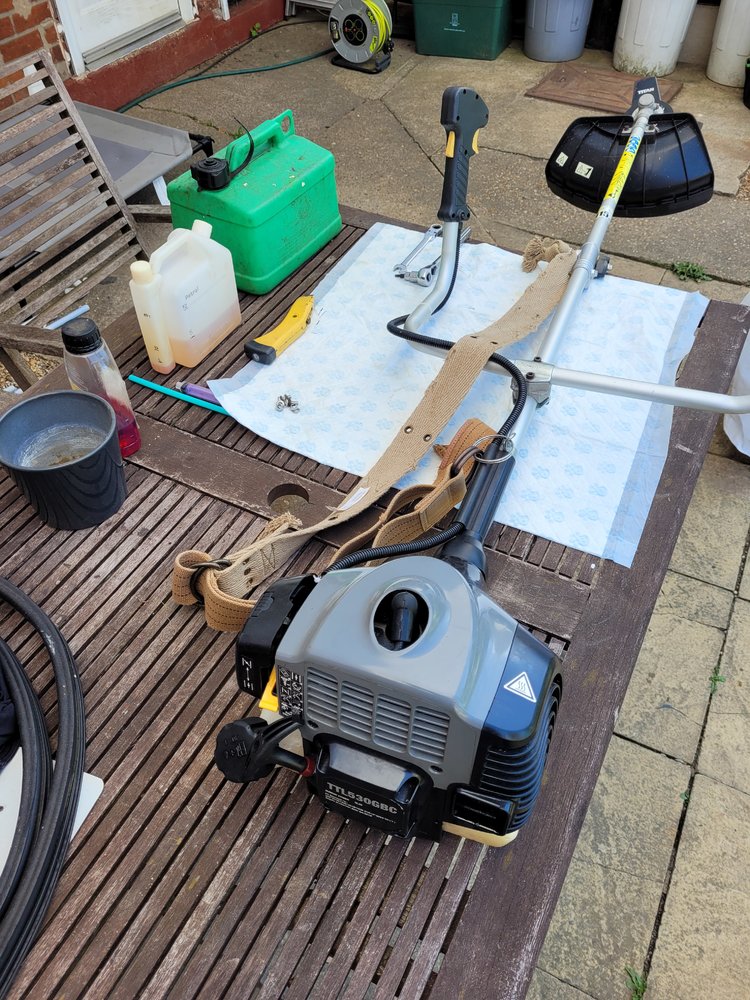

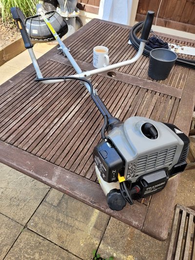

Thankfully not mine but dad brought this titan TTL530 petrol strimmer last year...used it once and sat it in the shed for a year. I get the phone call that he wants to use it but can't get it to run properly...so I had it for the day. Carb apart and everything else. Blocked jet and fuel filter full of crap. Sorted all that. Reset plug gap ect. Got it running OK now. Dad been mixing the two stroke oil wrong so was smoking while running. Hopefully that be that...faffn thing.
