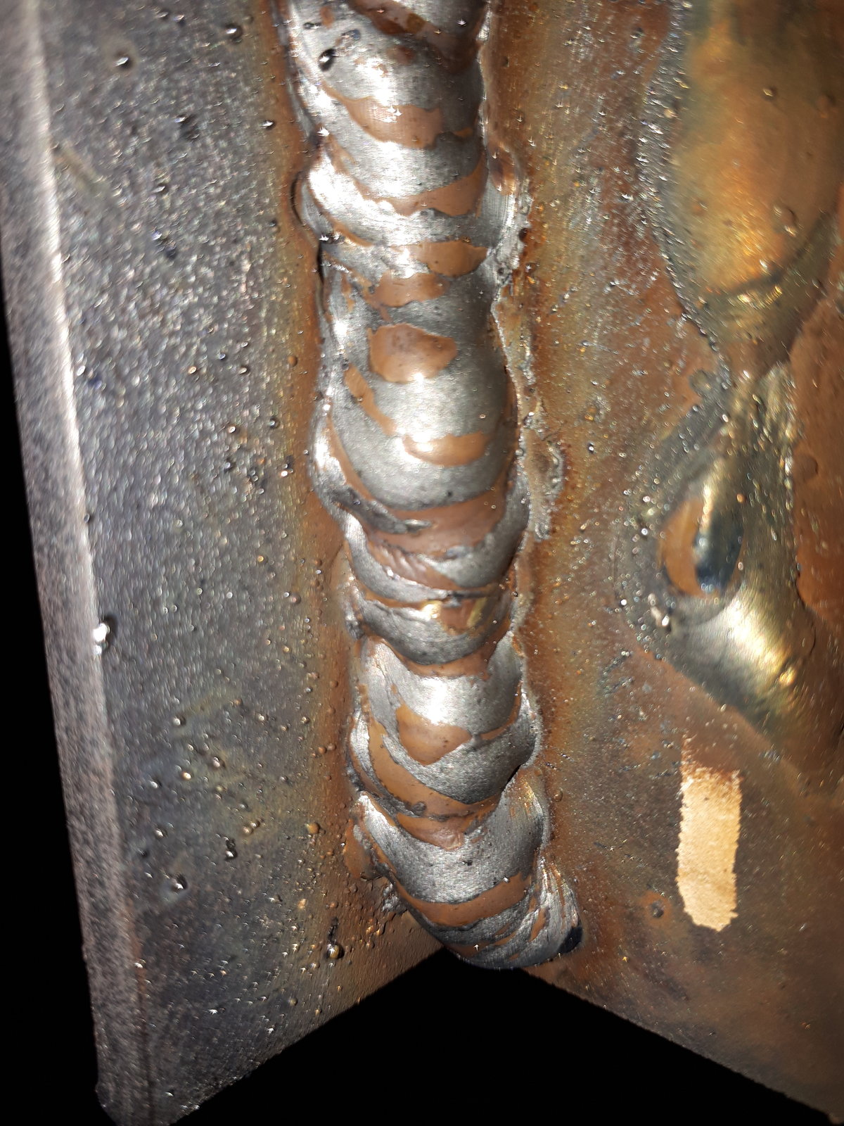

Thanks this helped, I'm struggling on uphill Mig or as my instructor says "it's **Language**ing Mag not Mig"You could use 0.8mm wire which makes it a little easier. Other that it just takes practice, you need to pause longer than you think on the sides otherwise it just crowns you in the middle.
You can measure wire by holding trigger for 6 seconds and then X10 to give m/min. That’s assuming your machine doesn’t have a creep start, if it does then you need to measure the actual wire dia on the reel then X by pie to give distance and then take an average time of 3 revolutions, divide the distance by the average time and then x60 to give mm/min. If that makes sense![]()
