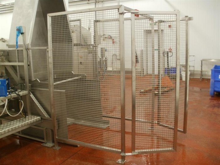

Installed this today, customer has a rather old and unguarded box tipper, when its elevated its possible to walk straight under the lifting carriage with up to a tonne of meat in the blue dolav,
So I made up a simple cage with some interlocked doors, all stainless of course,
The frames are straight, the camera has distorted the image.
