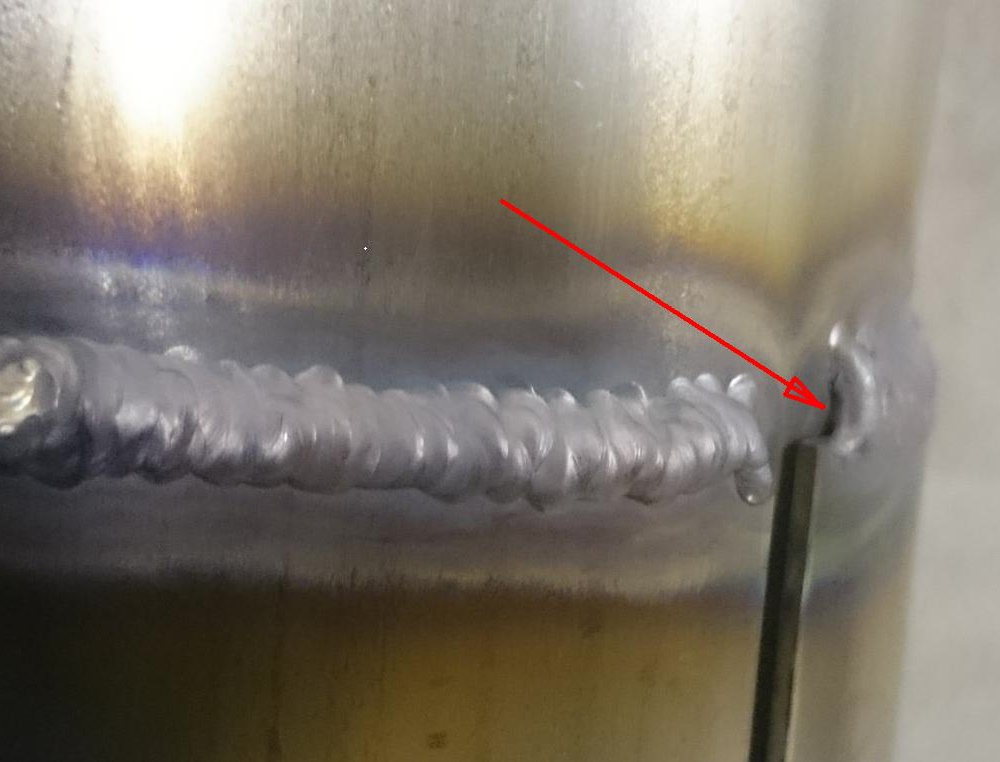

Alan, stop weaving and concentrate on practicing maintaining a SHORT arc length. Ideally no longer than the dia of the tungsten
Arc length is covered in the tutorials, also look at these threads http://www.mig-welding.co.uk/forum/threads/arc-length.7862/ & http://www.mig-welding.co.uk/forum/threads/tig-welding-stainless-manifold-help.23592/
With the correct arc length and no weaving you'd have one small weldpool at the point where the two parts meet instead of a large void bridged with filler metal (red arrow). Heat input would be lower for a given amperage too and the weldpool will much easier to control

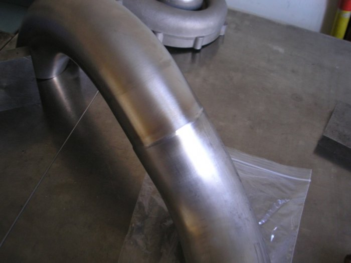

FWIW this is 3" dia 1.5mm wall welded with 1 or 1.2mm filler wire after brushing the colour off (no point on exhaust stuff, this was for something else)
