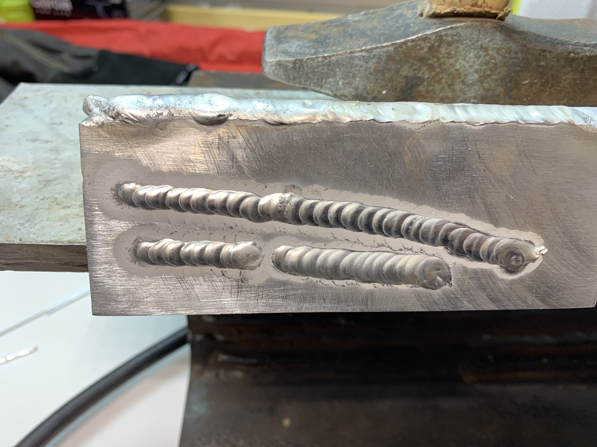

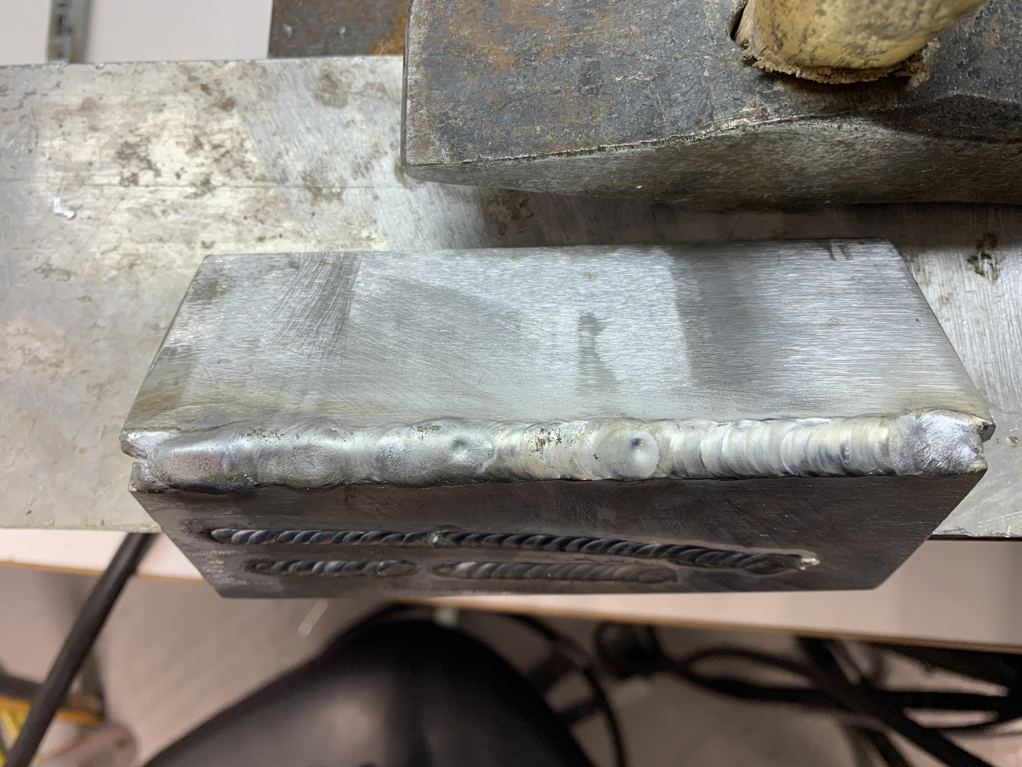

Trying to teach me som aluminium tig welding. My problem is heat. I get a lot of it. How do you weld to get less heat? I don’t have a pedal yet.
The outside corner was 135a/120hz/40% ac balance/10lmin/ceriated 2,4 tungsten/ nr6 gas cap
