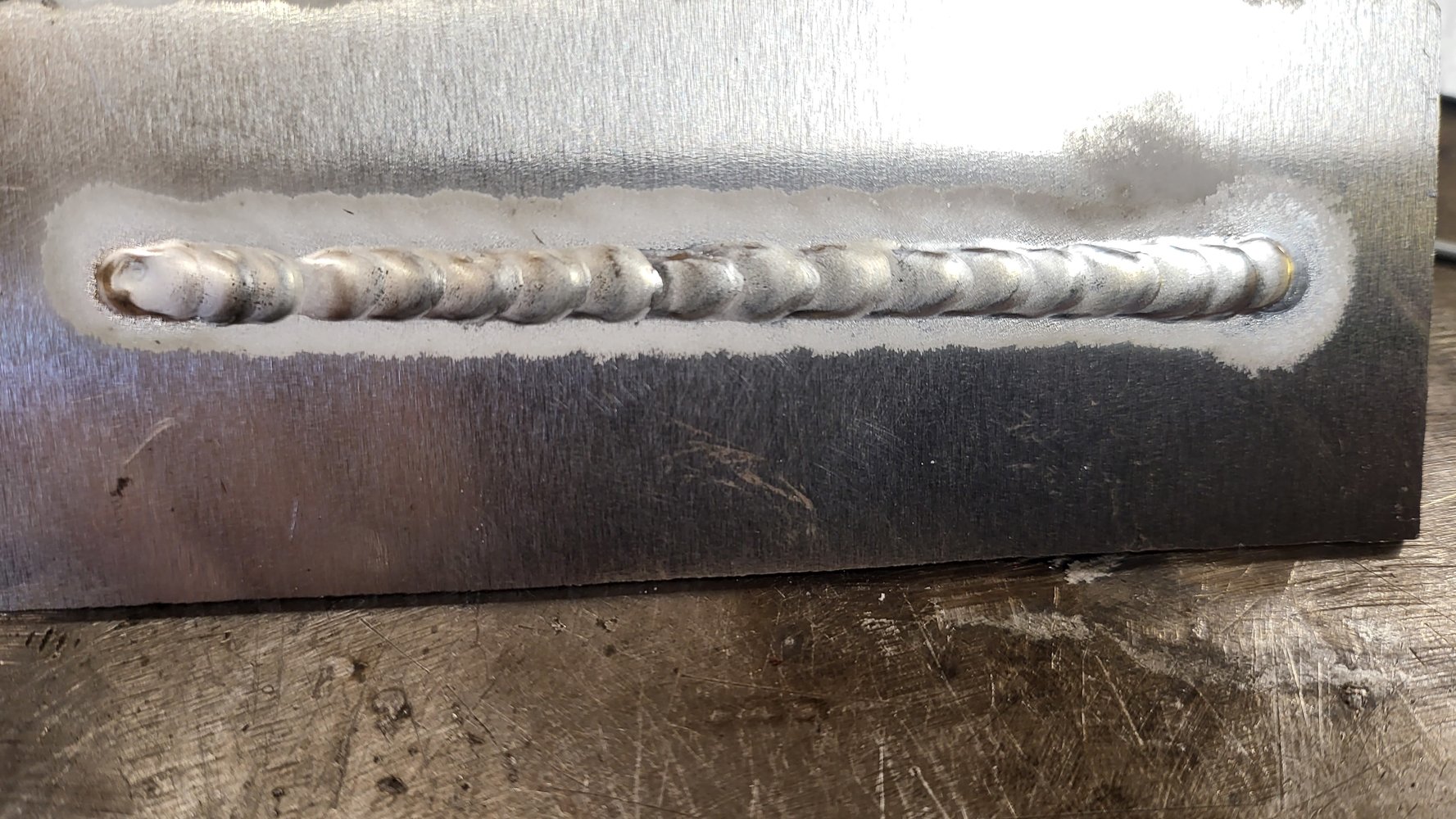

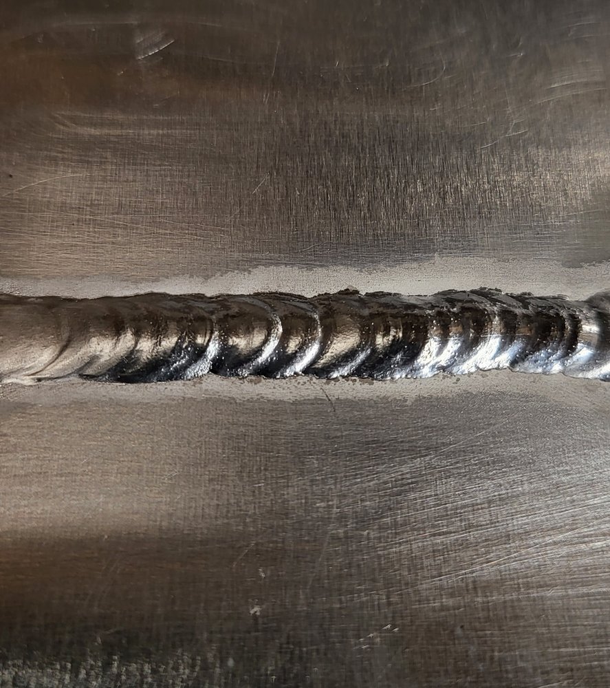

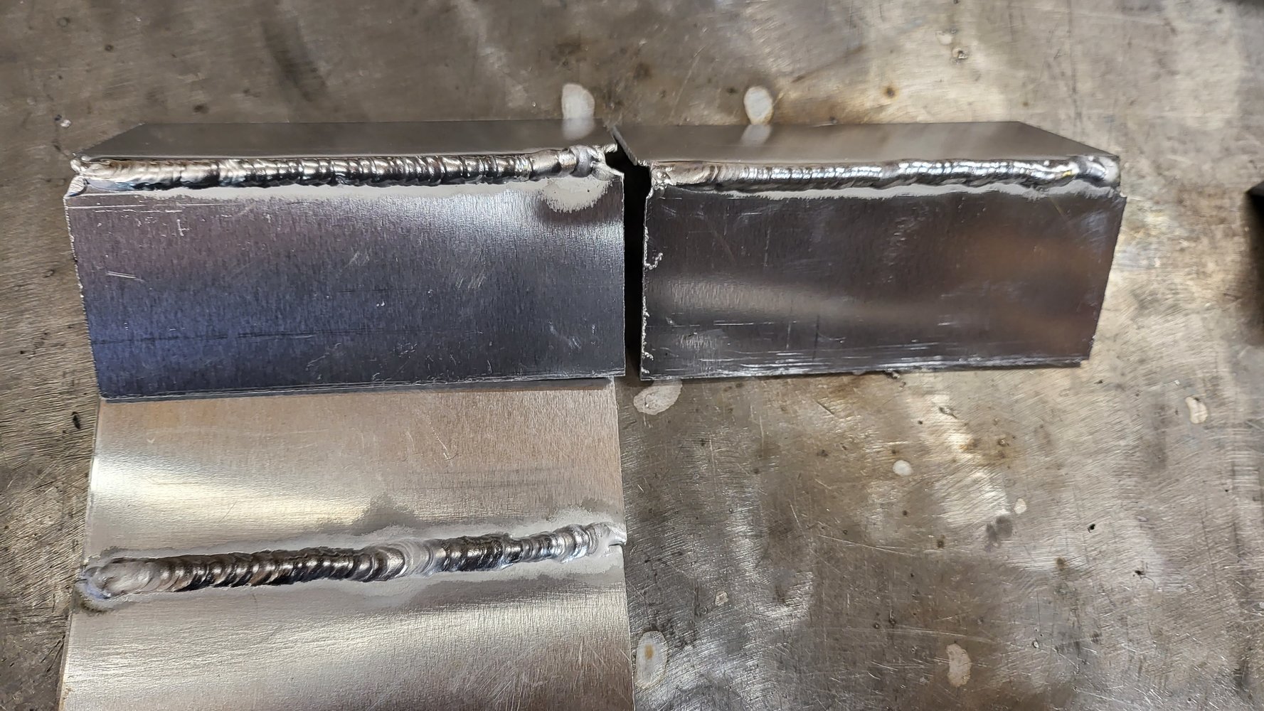

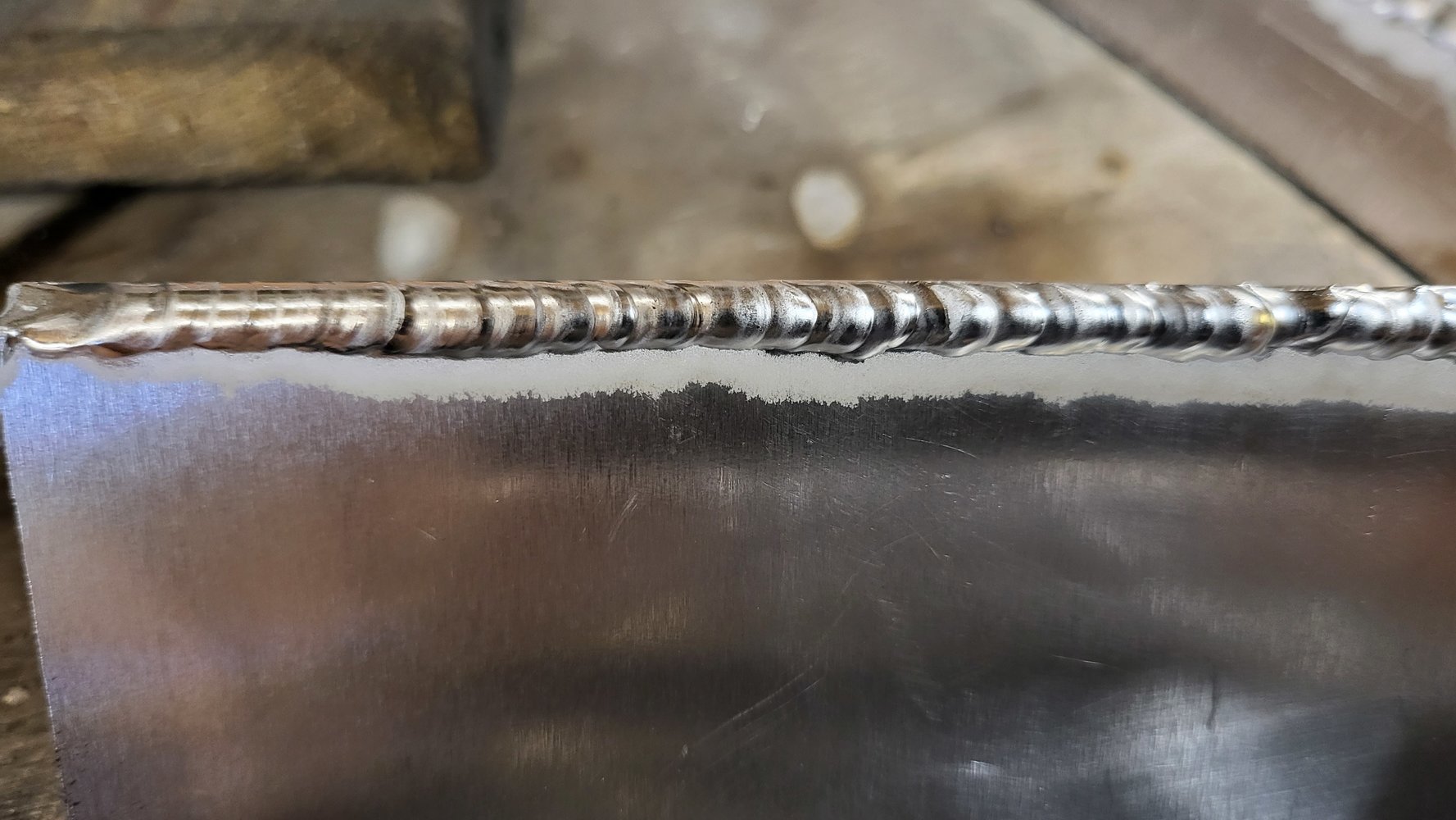

Ok thanks, I'll give that a try. I'm holding the torch as close as I can without dipping the tungsten but could be lifting as I move along I guess!I used to really struggle tacking ali, till someone told me to up the current to double what Id run with and do it really quick. Then reduce it back down to weld it.
Another issue could be your arc length is too long, so creating a larger heat zone.
