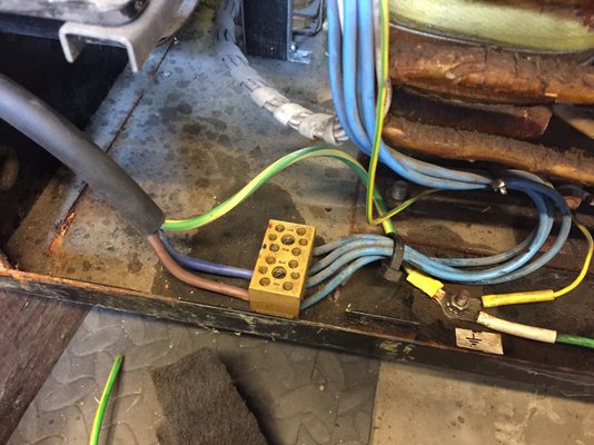

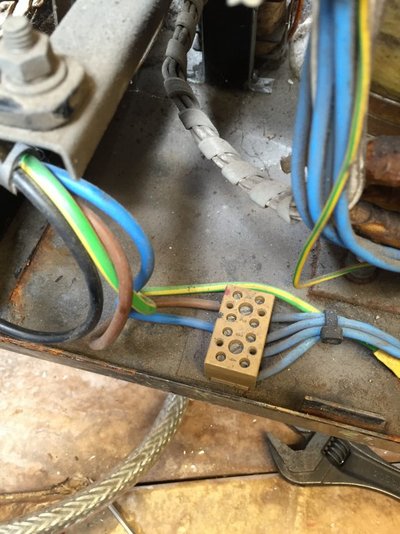

The selector switch is used instead of internal links (Miller style) and the power switch is on the front. Isn't it?
Yep, power switch is in the front, three position DC-off-AC.
On the back is a 240v - 415v selector switch. The connector block runs up to the selector switch.
The blue is carrying a phase. Brown-L1 Blue-L2 and Earth (black not connected either end).
