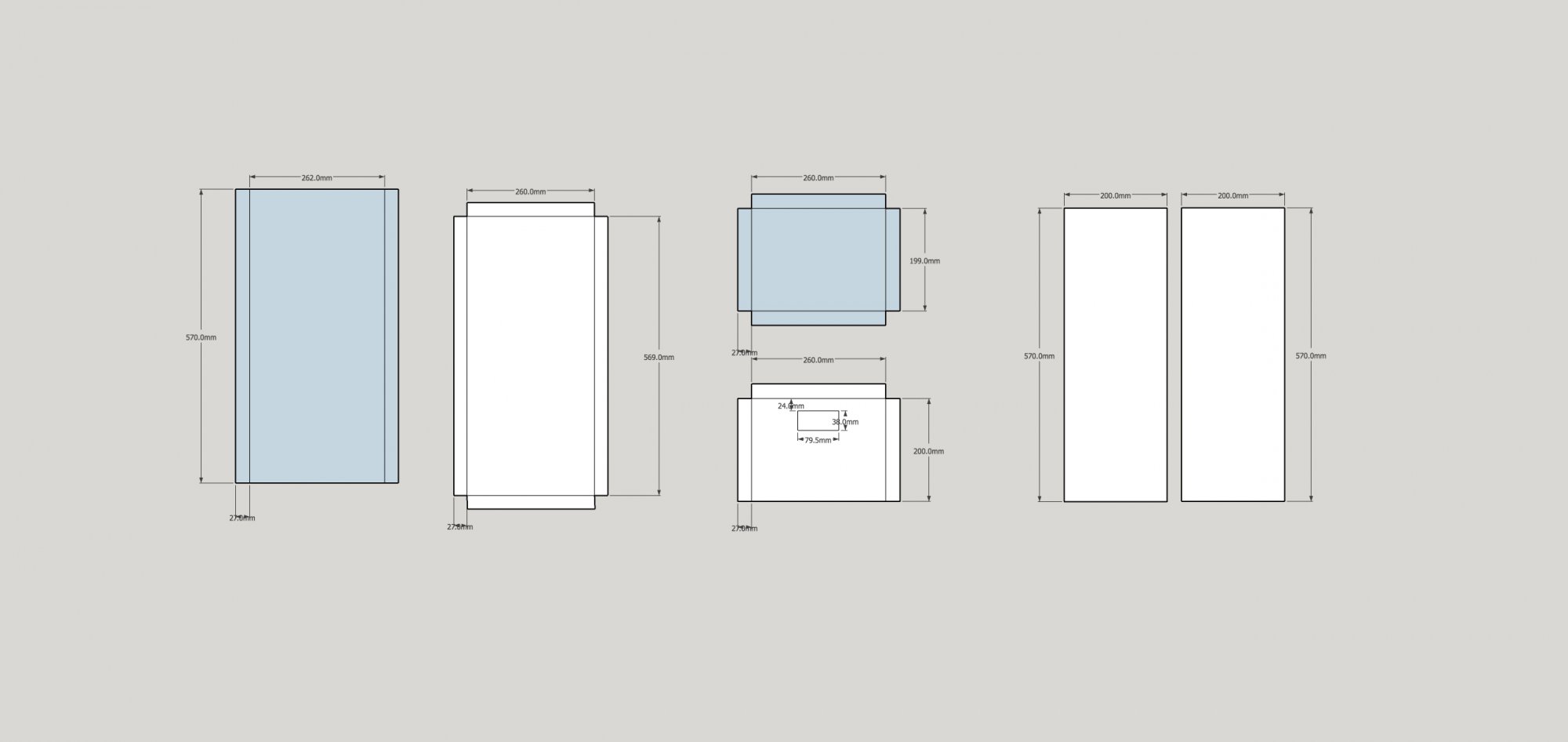

Cheers guys, the only thing im not sure about now is making the case, £60 gets it made or i can buy the metal for about £20 and make a brake from some angle.

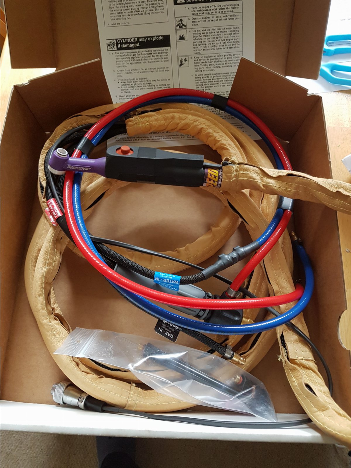

Cant wait to try out the sw320
nice box, got any plans for it im still trying to decide on how im going to do it, i'd like to put it under my welder like you have so it needs to be quite strong but still easy to access.
Jim needs to up his game sending out those girly purple tig torches. My first one was blue. He's turning us all into Jessie'sDo you think it would be possible to make something like that with a homemade bender? I'm talking about the angle iron design that fixes to a bench. I'd have to make some of the folds shorter in length to fit it in though. I'm not sure a homemade bender would be accurate enough, let me rephrase I'm not sure a homemade bender made by me would be accurate enough.
Oh and the post has just arrived
Big thanks to @Jim Davey for getting it out to me so quickly even with all that's going on with the website updates ect...
I have a home made folder. It's good for 1mm stainless across its 600mm length.purples cooler than blue
should be getting it set up and tested soon. cant wait
Hey Richard, what do you use to bend your cases?

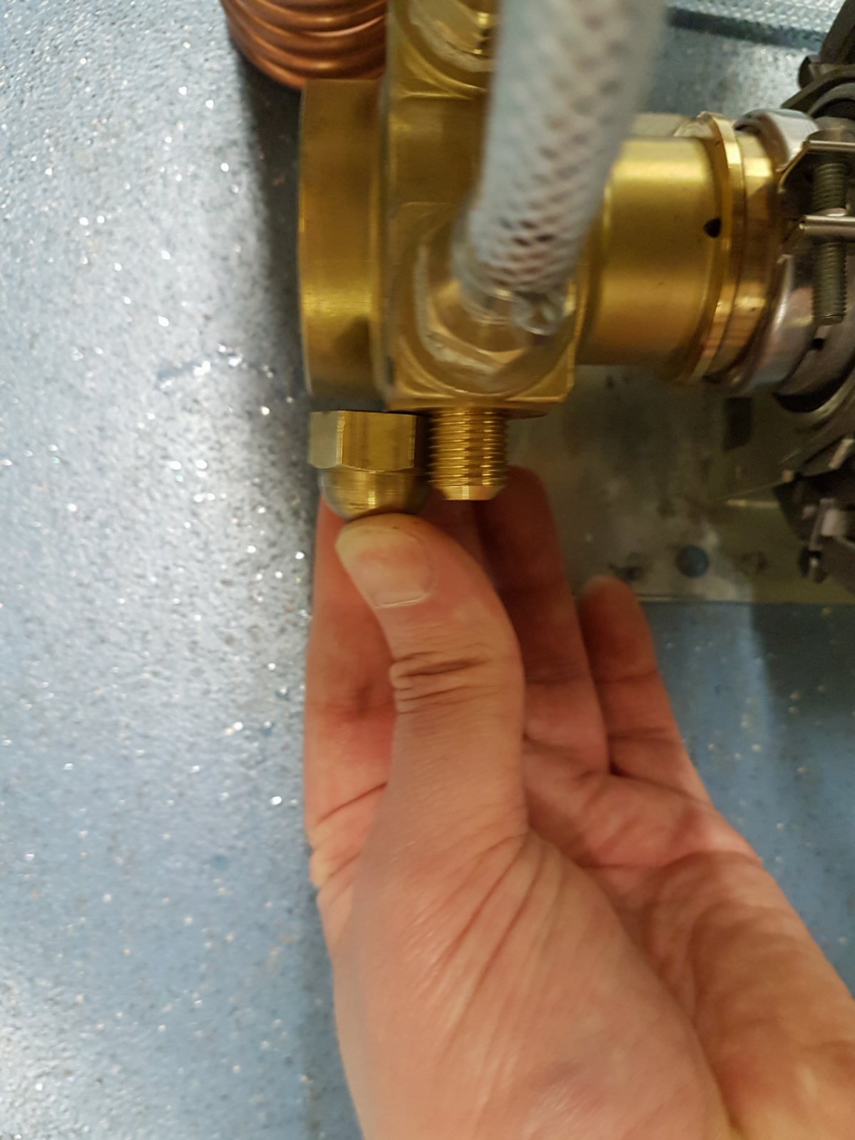

Wind it in more. You'll find the last few threads don't do anything to the pressure and like I say turning it up isn't gonna hurt anything. Go for 2lpm and don't worry about pressure.ok cool, i was just worried i might damage the torch as the maximum coolant pressure is listed as 50 psi and also, i didnt know if having the pumps relief valve fully unwound might damage the pump or wear it out quicker, its literally one turn from falling out.
I pressure test all my torches to 60 psi and even crap ones don't fail. Some of Binzel's new hoses are holding over 300psi in destructive tests so I don't think 1.4 bar is going to trouble your setup. The weakest link is the red and blue pvc extensions but they are internally braided and will comfortably cope with more than 60 psi warm.
You'll have no troubles.
Don't cool it across the side. Cool it up the **** end. You want the air flow to get in the vents at the back. That motor won't come to any harm getting hot but it will heat up the brass head and anything else close by.Upped it to 2lpm and ran it for an hour with no leaks, cant wait to try it in action tomorrow.
It took less than 1 turn to add .6 litres , no doubt its a powerful little pump.
