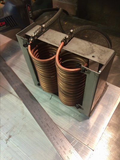

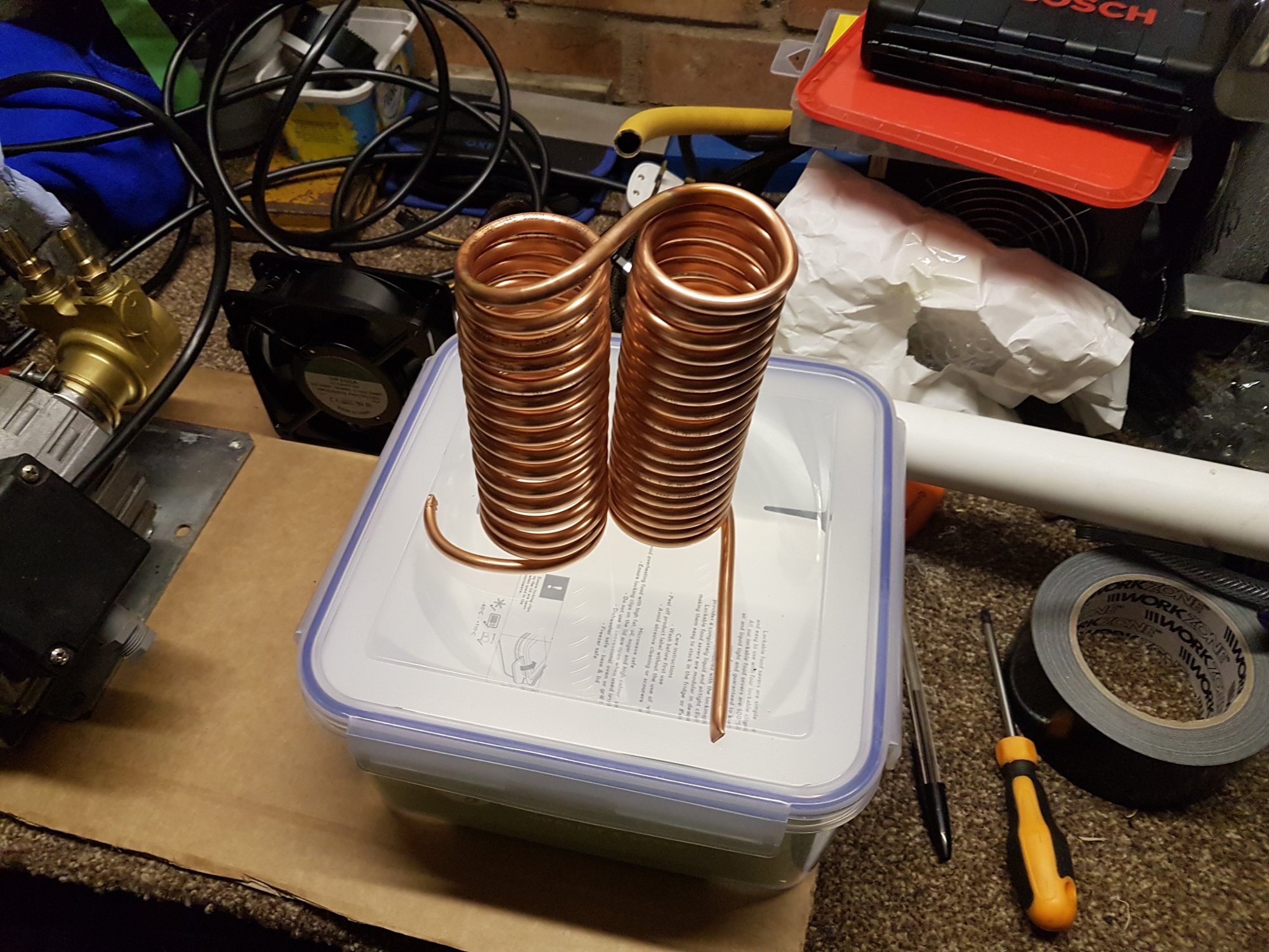

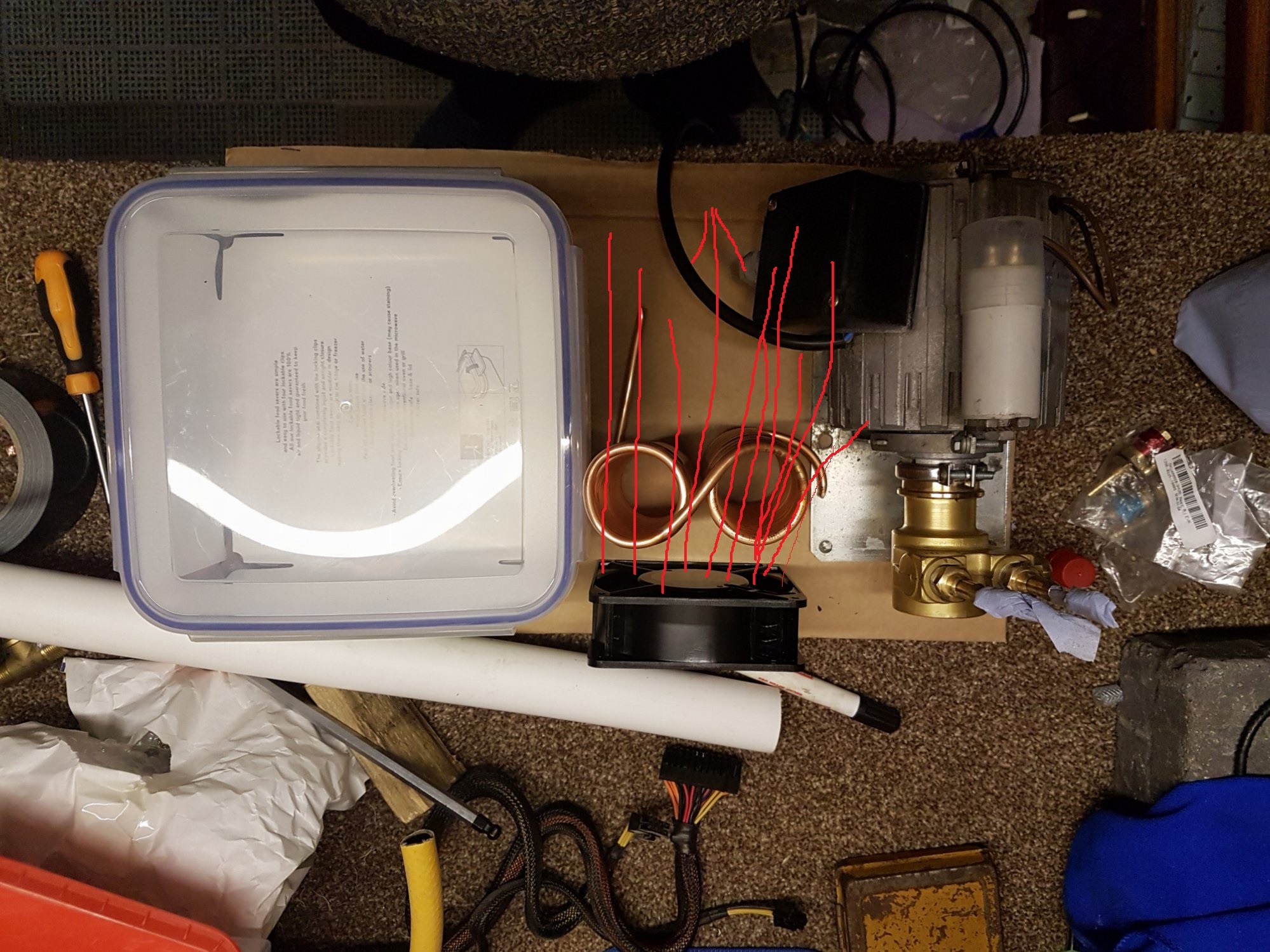

Unless you must box it up ie the welder needs to sit on it and free up some space I would suggest you make it into a tidy open Chassis job. It's gonna be more efficient all round if you do.Had the cooler running all day today with no problems at all, I was only welding up to 145 Amps but i did run a big pad of beads and it coped fine. Its open air atm so i may have to add another fan when i do the case.

1) recirculating from a closed system is far better than pouring good clean water down the drain unnecessarily. That's just a bloody waste especially when there are kids through out the world drinking from puddles.
2) its a well known fact tap water corrodes copper and will over time reck your torch.
3) tap water has conductive properties that can cause corrosion and HF leaking
4) portability
Building a proper cooler is not over thinking things it's been smart.

It'll look a lot nicer when i get round to boxing it up. It works brilliantly, takes up very little space and if you're patient and watch ebay etc you can build one for under £100.
