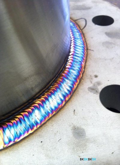

I must admit. .I got my self a stool.as to sit on in my workshop. .didn't have one before.but now can relax while trying to tig and is better...Stack of dimes is all about increments of movement and timing , it takes practice and a steady hand , get comfortable first , its no good standing over a bench and wobbling around !

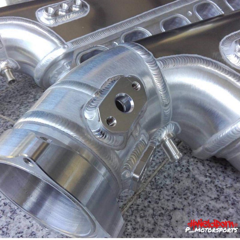

I enjoy Alu work too. Not cast mind that stuff is a chore. I swear I must be under charging for welding that stuffI would like some more Alu work , dont do enough of it to get real good at it !![]()
 I'll be honest I'm not very good at it as I've never had the work for it. It's got a couple of uses I believe. 1) it's used a lot on thick wall section pipe where Tig is The meathod for filling a joint all the way. As you can imagine that's a slow process. Cup walking speeds up the process a lot over free hand. Looking forward to it mate...Well your welcome to have a blast with the Alu on sat. We can do some pedal work also. You'll enjoy it I'm sure. If you've not done it before you'll see just how differently it behaves under an arc when compared to ferritic type metals.
I enjoy Alu work too. Not cast mind that stuff is a chore. I swear I must be under charging for welding that stuff![]()
 dunno whyThis is what I would like to be able to do/achieve one day..I am a million miles away from that sort of quality. .love aluminium fabrication work...View attachment 72521
