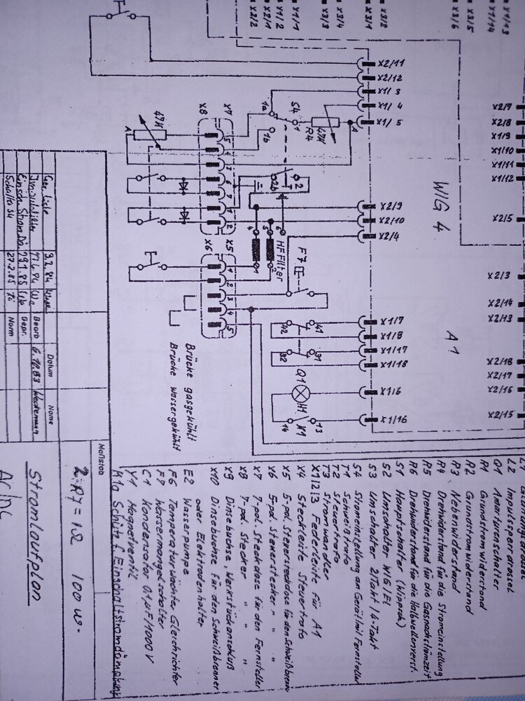

I have a Smitweld/ESS Thyrotig 220ac/dc for which I would like to make a pedal.
Connector x7-> x8 is the pedal, and it only needs a pot and one switch.
The switch connected to pins 6 and 7 isn't connected(?)
Should the switch be intergrated in the pot or a separate microswitch?
Can anybody say what diode to use?
I did measure the voltage and it was maximum 12.25 volts, but I still have to figure out the pin numbers on the welder.
