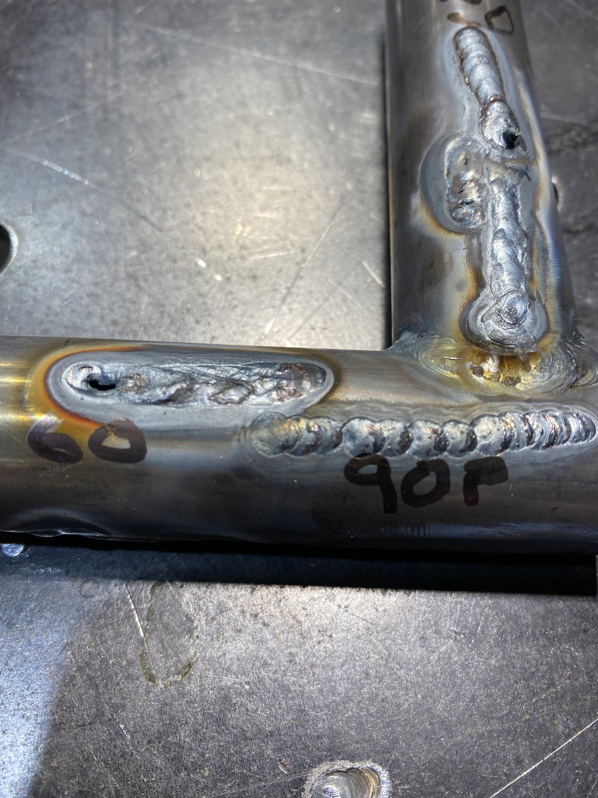

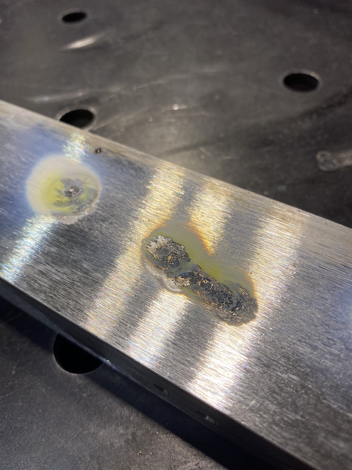

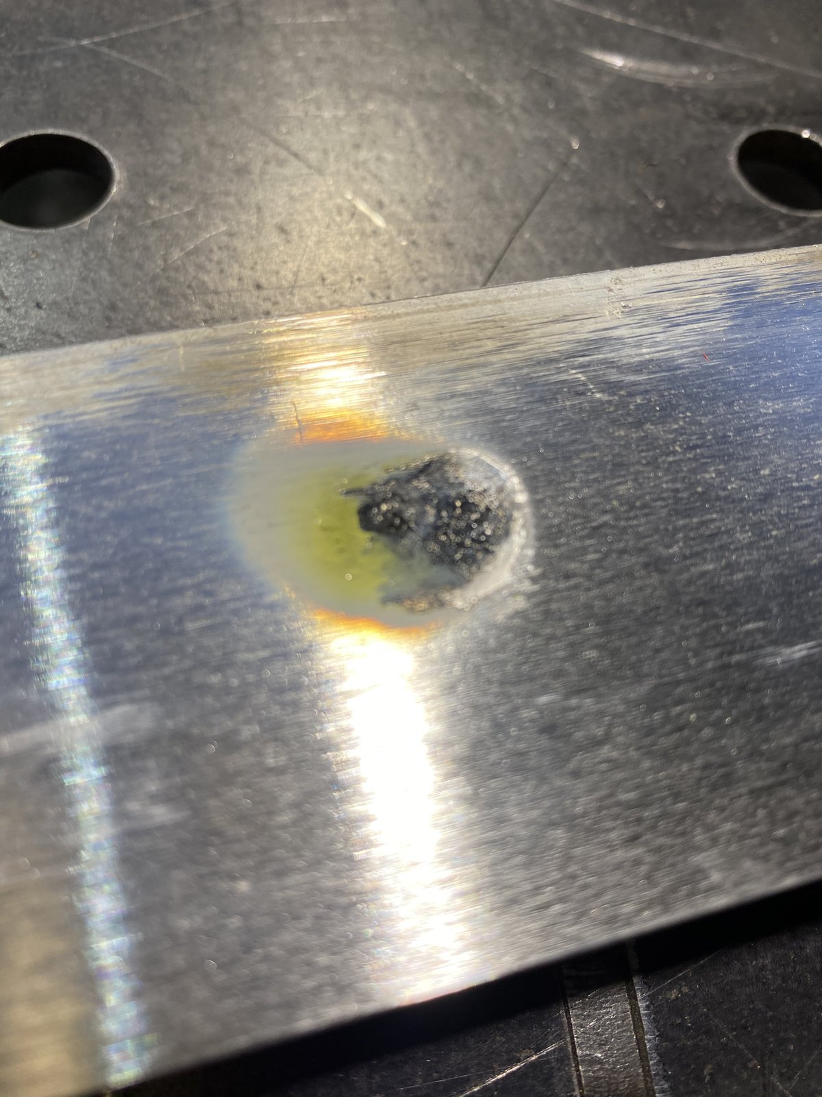

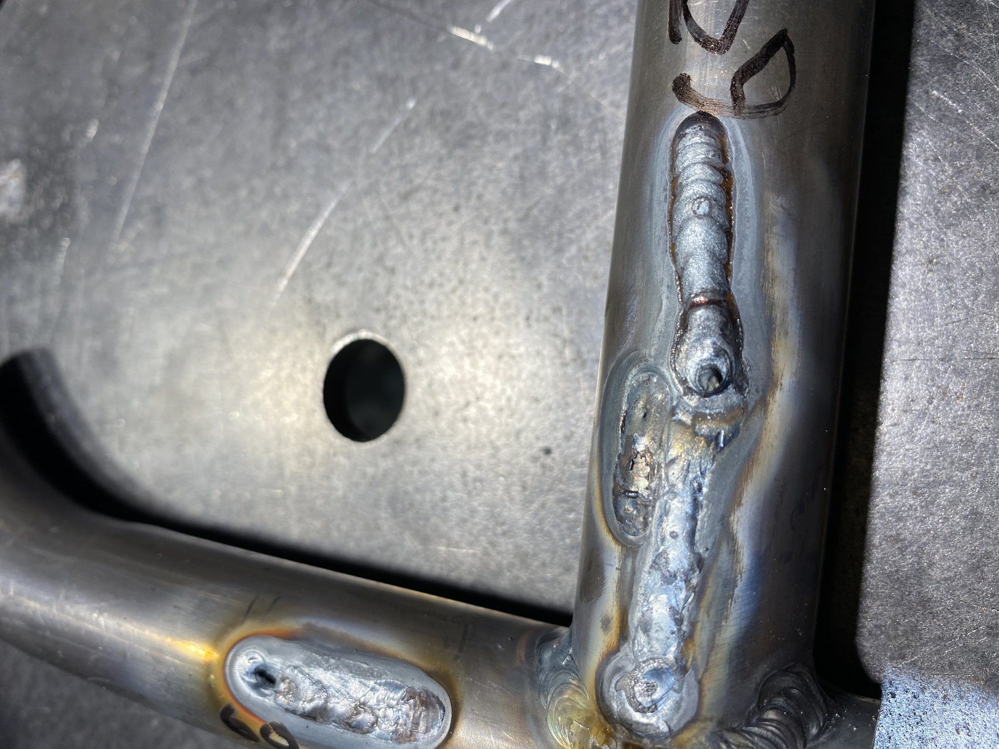

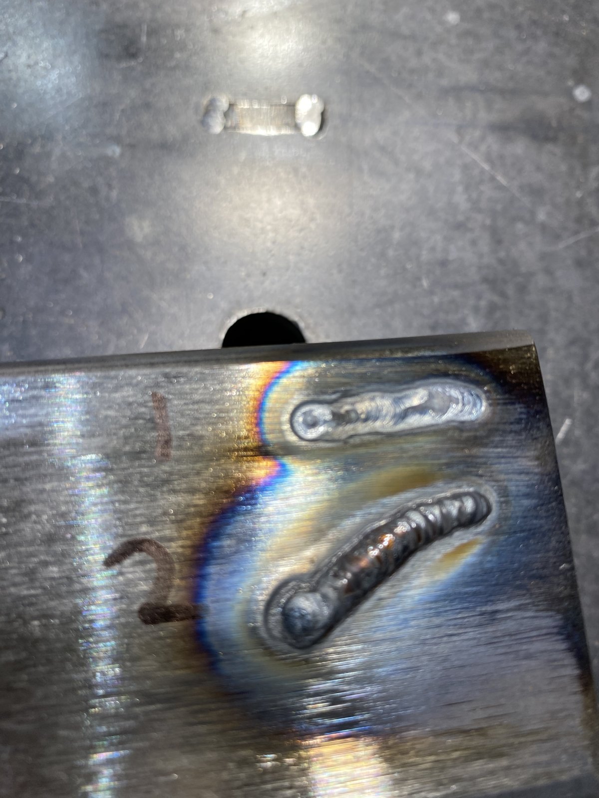

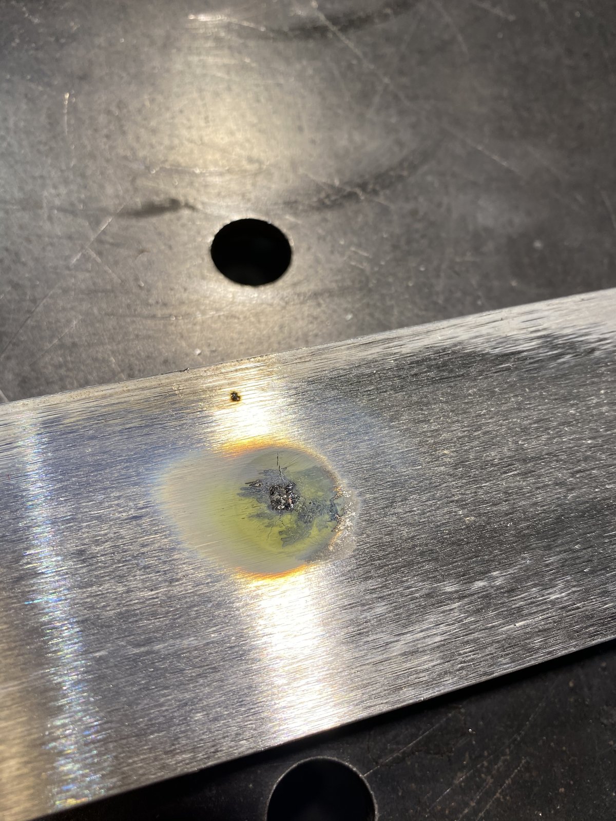

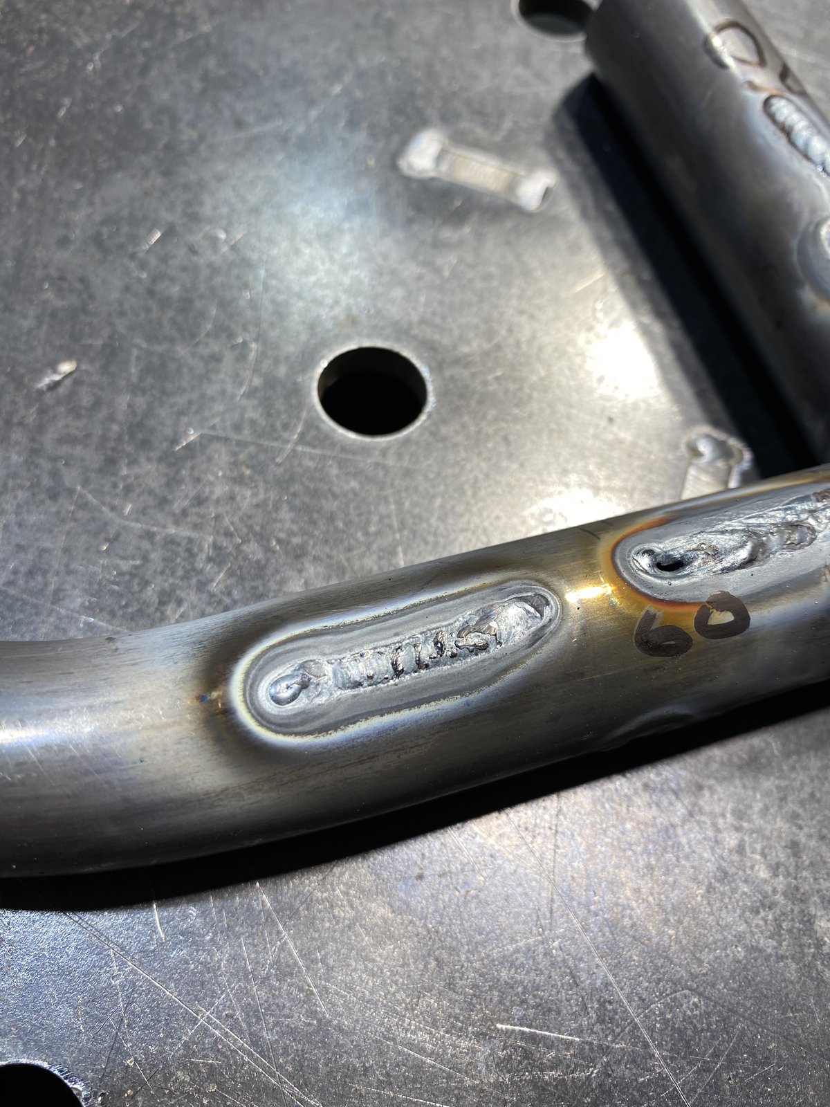

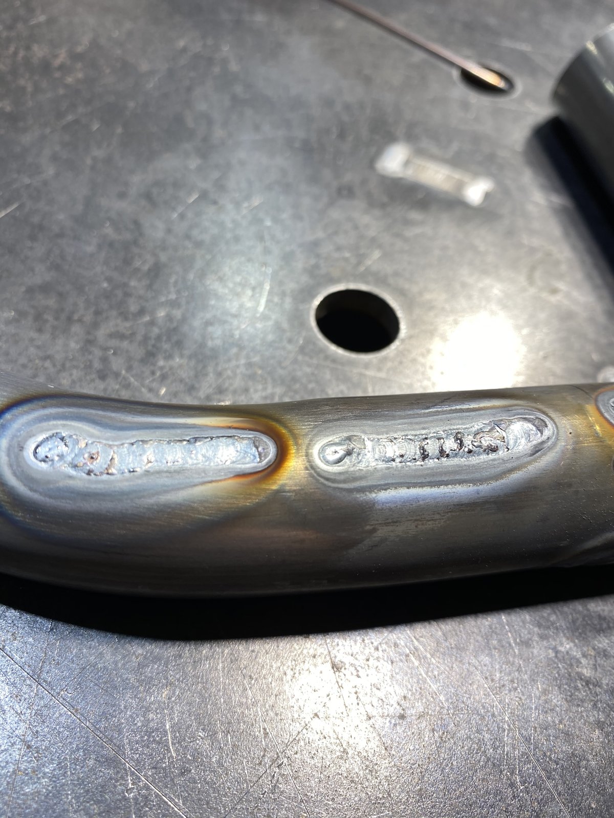

We have a loan machine 170amp ac dc machine whilst ours is away being looked at
thing is, we are experiencing the same issues that the other machine had

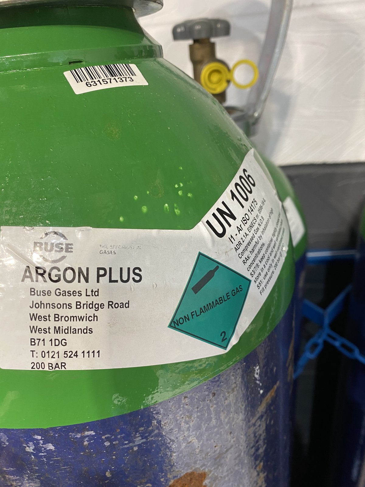

we have brand new bottles of argon 200 from a local welding supplier

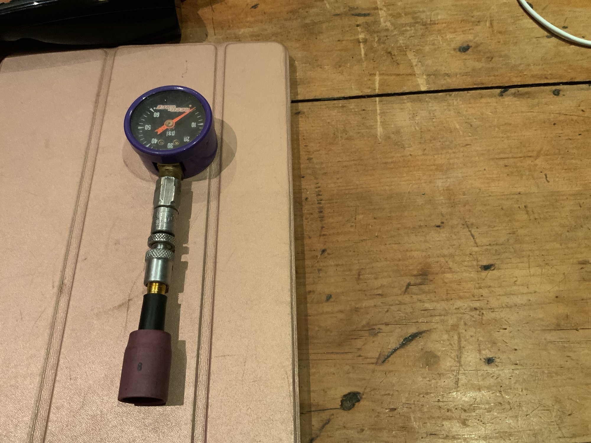

Iv tested the bottles, regulator(x2) and swapped the torch over but to no avail

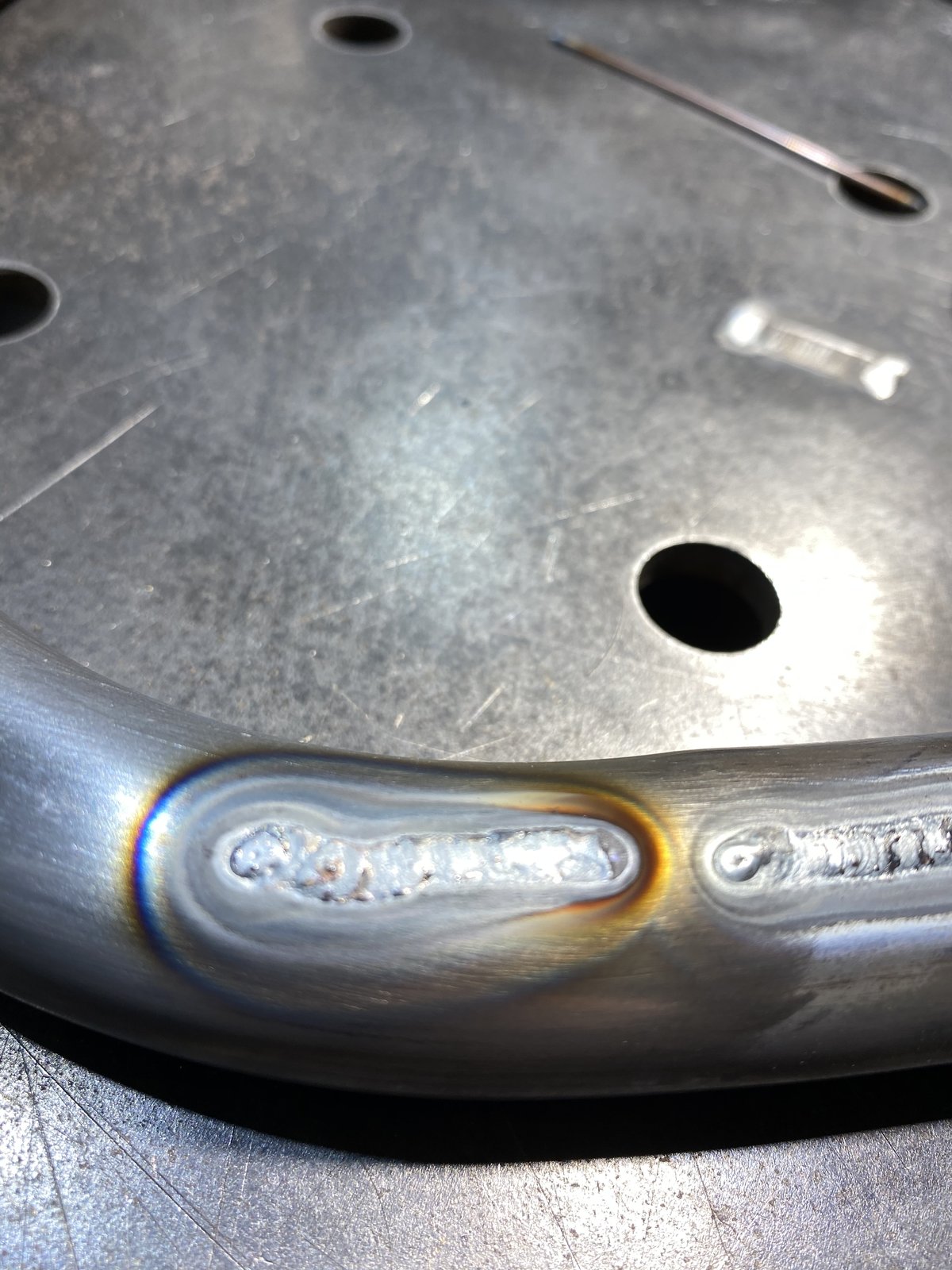

I think it’s a gas issue but not sure. The first 6 welds are on T45, cleaned with a brand new brush and wiped with acetone left to dry for a few mins then welded.
The tungsten was brand new out of a fresh packet and both the T45 and then the Ali was brand new
any suggestions?
