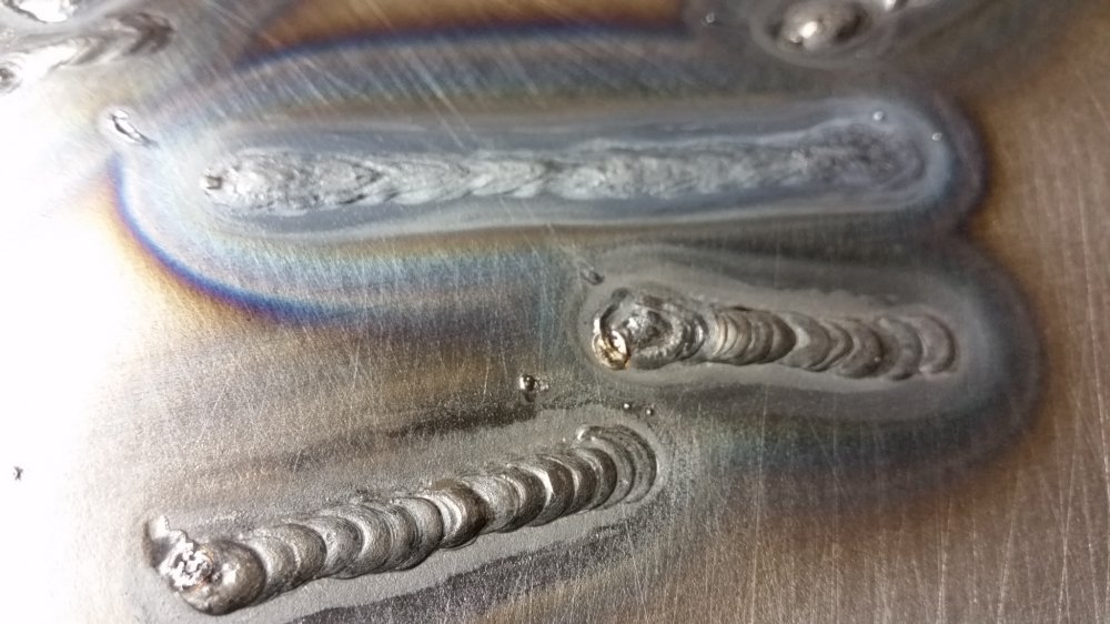

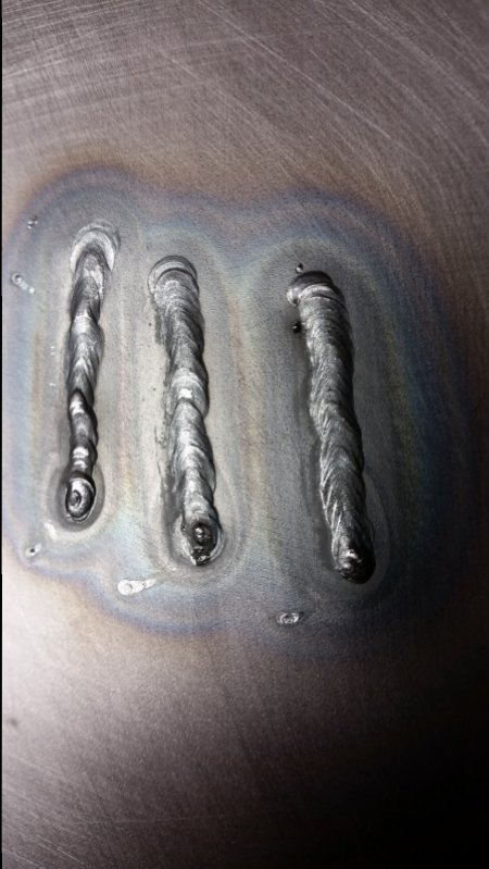

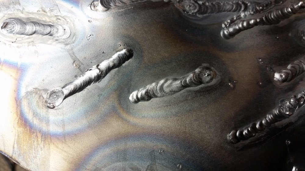

Far left, too much filler/not enough heat/travelling too fast. Other two are getting there, although I can't see an enormous amount of detail on my phoneTonight's effort
Having looked again, far right is getting the idea, a bit more consistency with the filler at shorter intervals and you'll be away
If it's a small piece that's becoming quite heat soaked it can cause your welds to sink. Allow it to cool a little and work on bigger bits.
