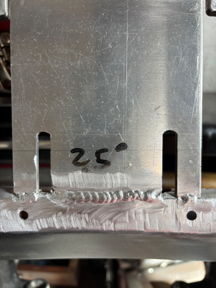

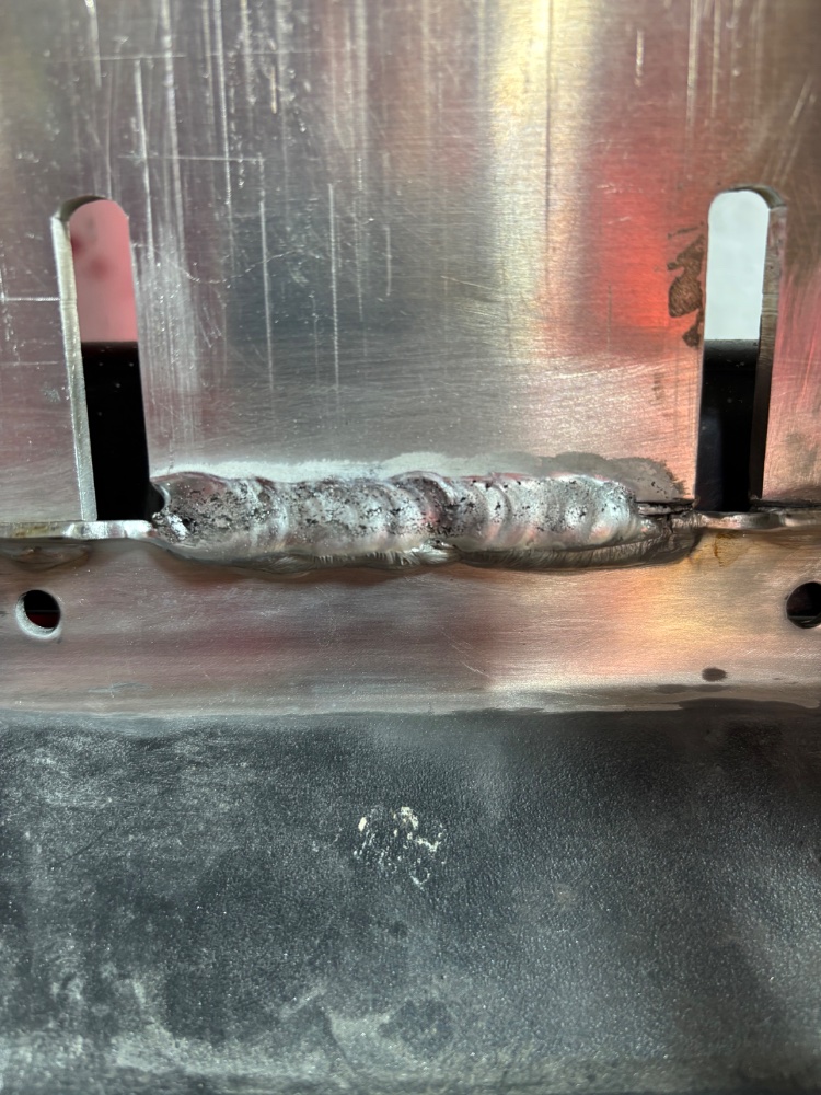

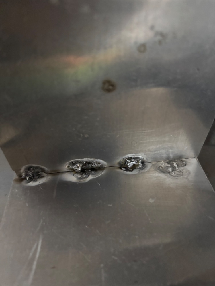

I know this must come up all the time but I’m stuck with tig on aluminium. I’m not a total noob at this and have managed to attach bits of aluminium to each other in the past with an amount of success.

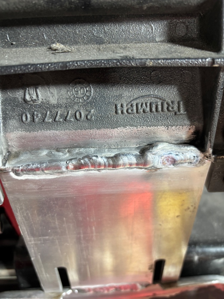

Anyway I have been trying to weld a brace plate into a subframe as per these pictures which you can see is just awful. Full of porosity, messy, it’s sagged in places and I’ve actually warped the whole piece:

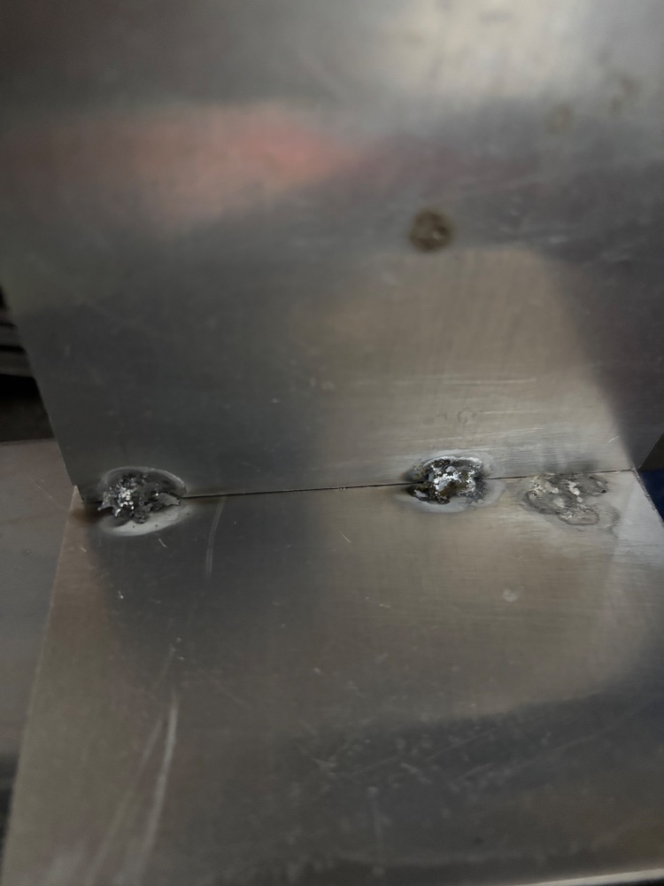

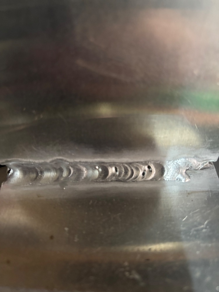

Not happy with this, I thought I would do some practicing on bits of plate clamped into a fillet but I couldn’t even tack weld them together. When hitting the root with 185 amps a puddle would barely form and after forcing some filler in there I got 3 horrible yellow black and green tack welds which a stiff breeze would blow over:

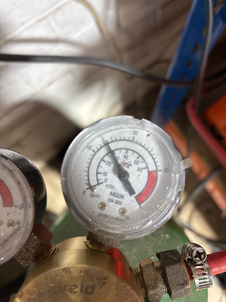

I had cleaned everything with dedicated stainless brush and then solvent wipes first, including the filler. The plate is 5mm thick 6082t6, tungsten is 3/32 (2.4mm), gas flow is around 30cfm pure argon. Filler is 5356. Ac balance is set at around 35-40 percent and is enough that the tungsten balls slightly when given some decent current.
I don’t really understand where I’m going wrong unless my gas is contaminated or not flowing as much as my gauge reads but it hisses pretty healthily when I trigger the pedal.
Any suggestions welcome
