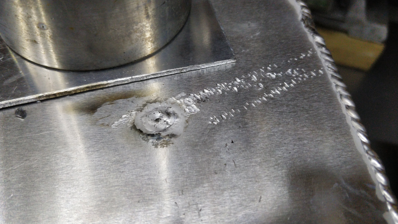

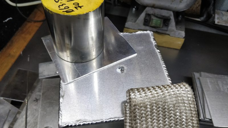

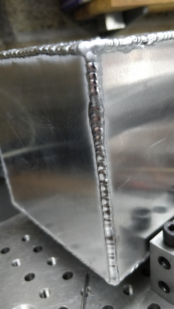

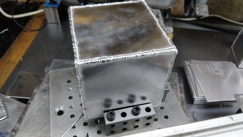

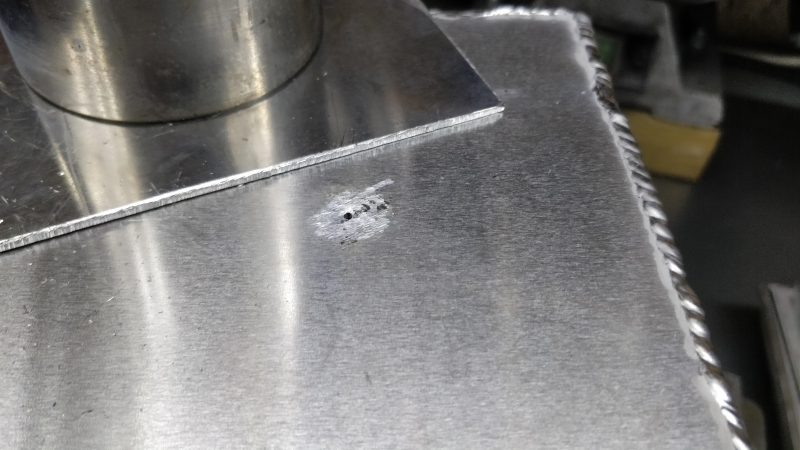

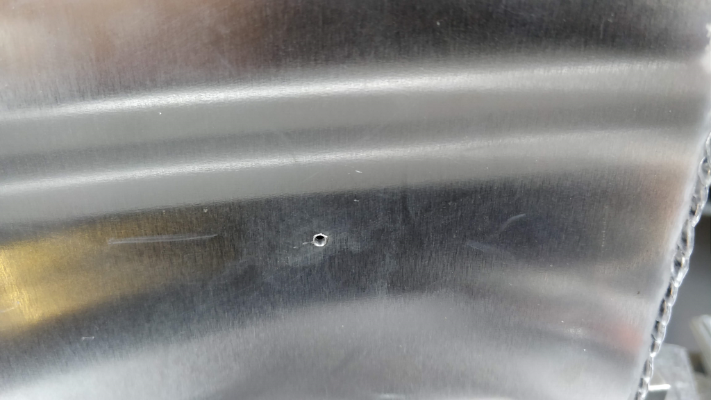

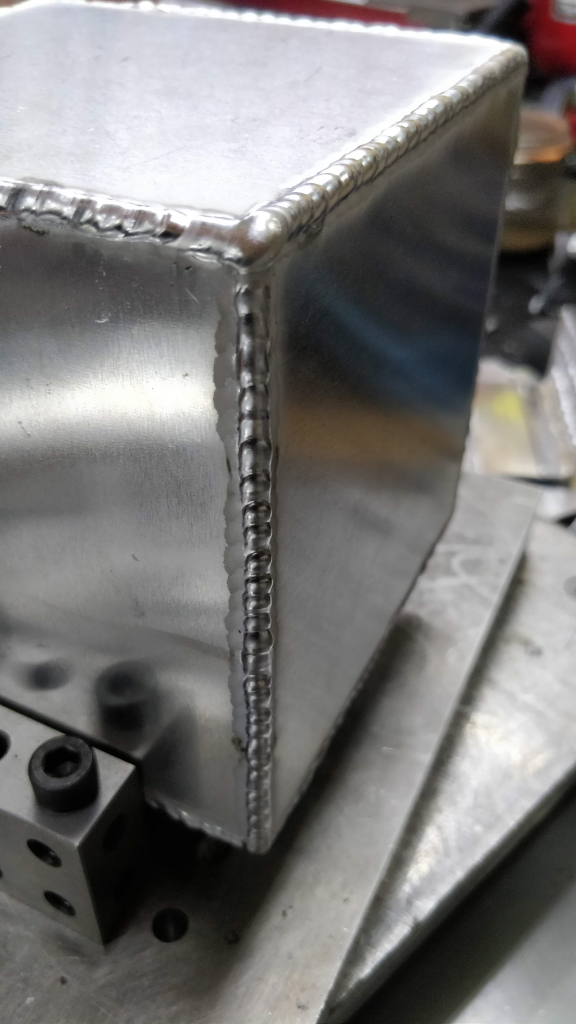

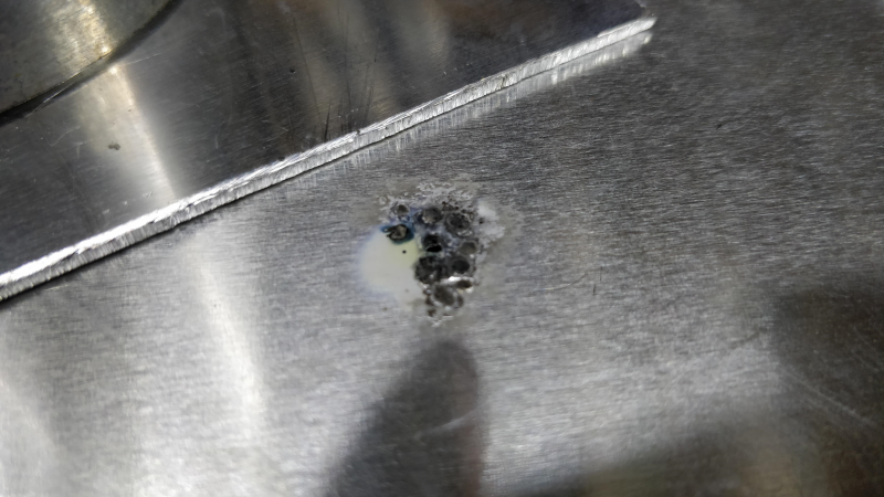

Your argon flow or balance is off. Or both.
What torch setup you running? Gas lens or standard?
Are you cleaning the edges of the material and wiping with acetone?
The 4043 is looking grainy because of heat build up. I’d use 1.6mm filler rod on 2mm material
