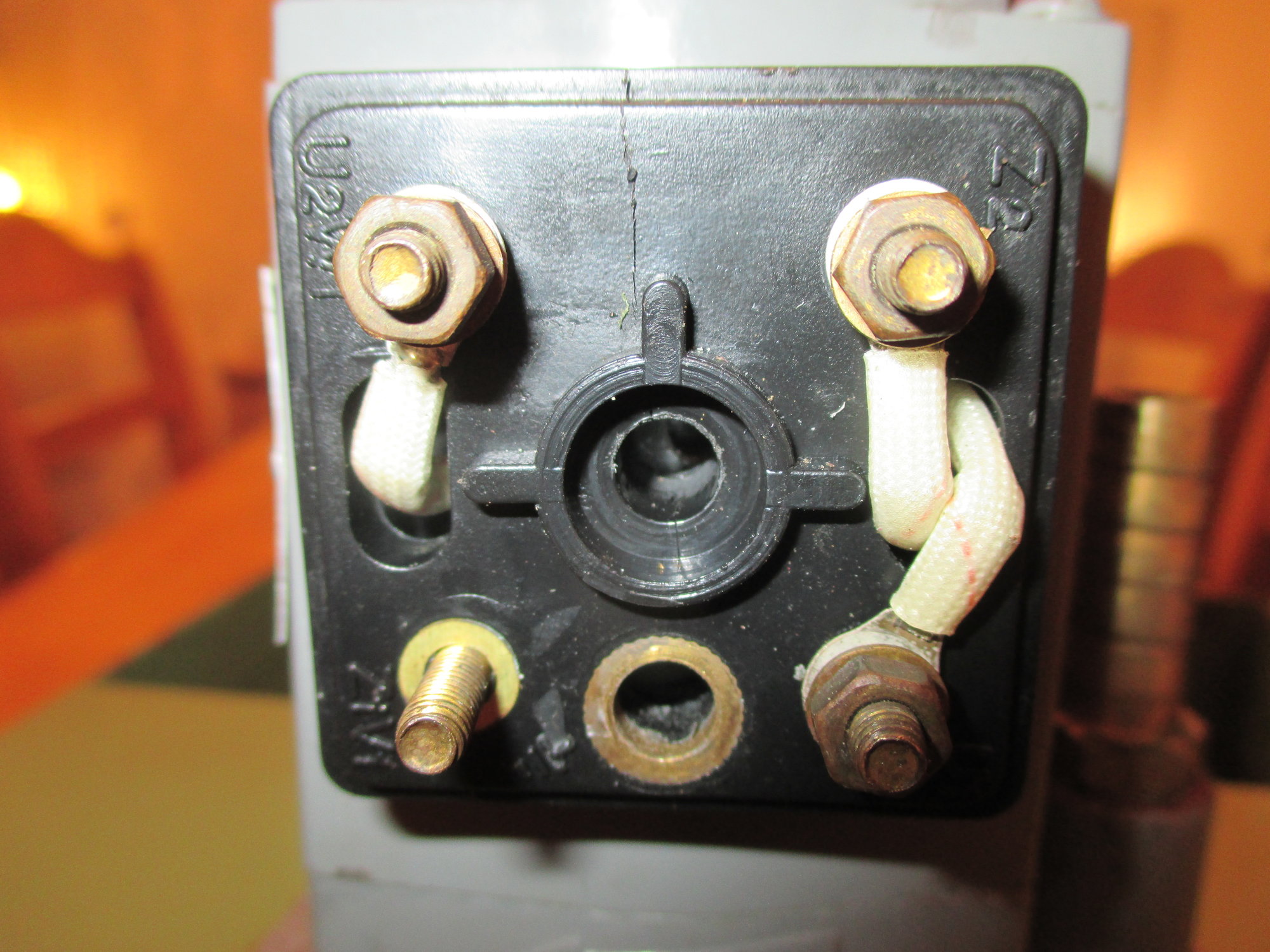

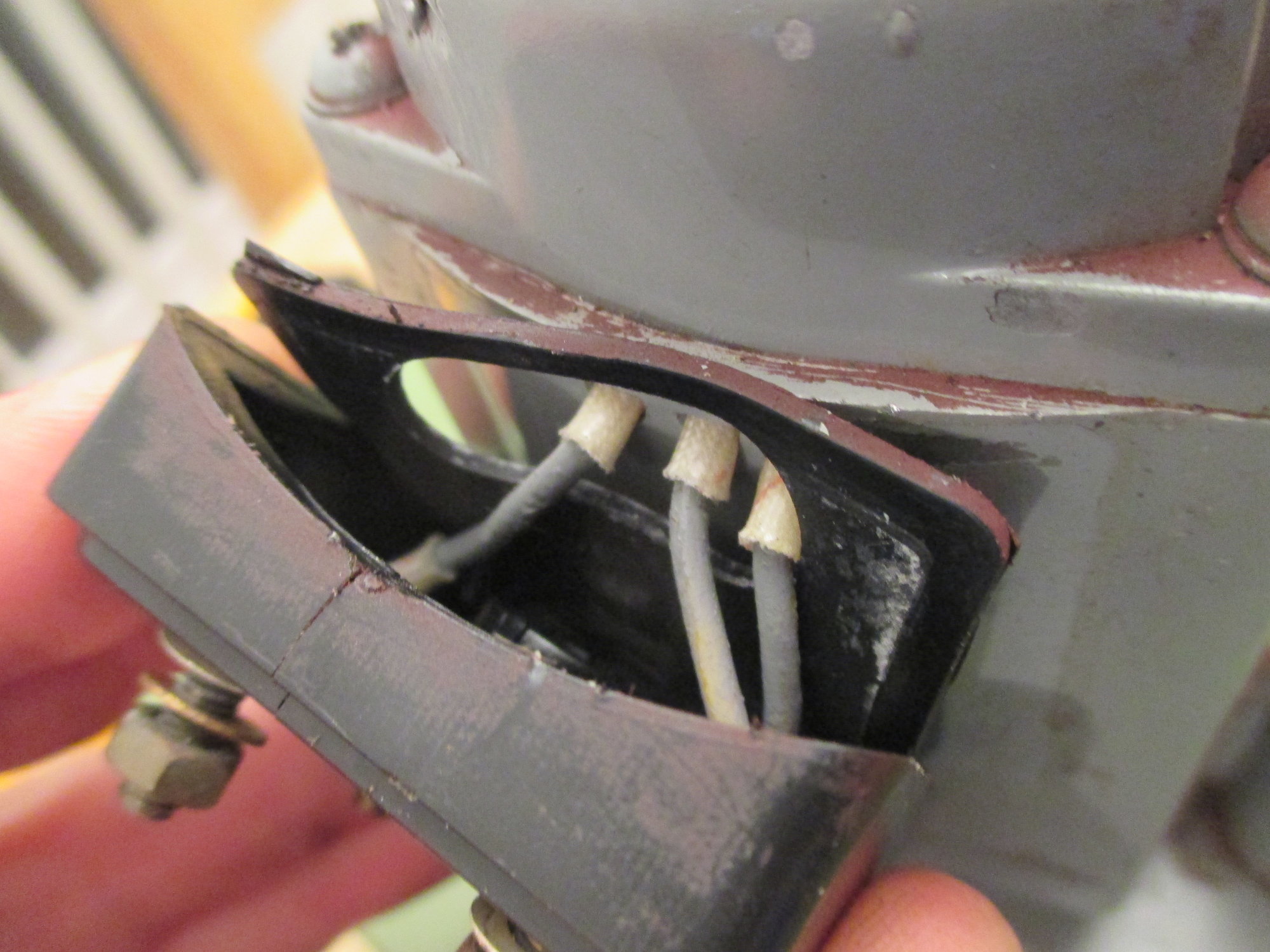

As to the suds, check the plate on the motor - make sure it is three phase.
Assuming that it is get a capacitor from a flurecent light. There's three wires into the motor, connect any two to the mains and put the capacitor between the third wire and one which you connected to the mains.
If the motor then turns the wrong way change any two of the motor wires round.
Now, to do things properly you should measure the voltages across the phases and then fit a capacitor of a slightly different value to balance them out. However from my research I found that they're usually ok with a cap from a flurecent light, keep an eye on it as if it's wrong it'll run hot. When it's been running a good while without excessive heat you know it's near enough.
