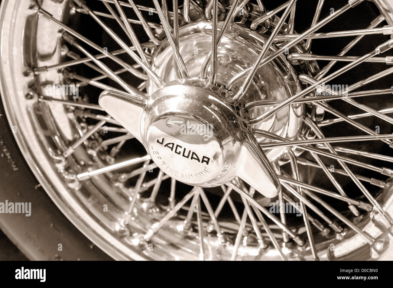

And then you get in the worry that I think Lotus tweaked the design, and reversed the usual mechanism of them self-tightening in use, so you have to fit them on opposite sides to what you might be used to.
