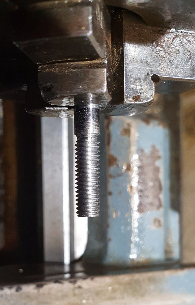

I've been calling the cross-slide the topslide ....sorry for the confusion ,my badJust to check, you're not bringing your compound out on every cut are you? You are only put cut on with the compound?
Sorry Richard ,of course I meant "cross slide " not topslide !!I can't see anything wrong with your setup, but could you elaborate on this. I believe the compound and top slide are just different names for the same thing.
You're maybe right..... There was a guy on FB said the same ... strange how it will cut 1.5,1.75 but not 1.25 .I bet the 1.25 thread doesn't work with the thread dial.
See my lathe you can't do a 1.75 thread with the dial. You have to keep the half nuts engaged. I've got a 4mm pitch lead screw. You've got a 3mm pitch. I bet you can't do 1.25mm threads
It's to do with the pitch of the lead screw and the gearing. There will be pitches that can't work out with your 20T or 21T dial thread indicator.You're maybe right..... There was a guy on FB said the same ... strange how it will cut 1.5,1.75 but not 1.25 .

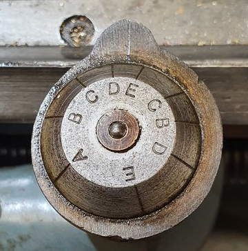

Which do you have engaged - Pete's chart says 20T for 1.25mm and 21T for 1.75mmYes , a 20t and a 21t
Because I just cut the 1.75 pitch m12 I have the 21 /position 2Which do you have engaged - Pete's chart says 20T for 1.25mm and 21T for 1.75mm
My apologies for possibly insulting your intelligence, but the threading indicator is spinning when the half nuts are disengaged, isn’t it? (I don’t know the lathe, so don’t know if it is possible for it to be disengaged.)The threading dial I know nothing about it so will have to research on this
I was tight for space because of the live centre being in the way,your point about starting away from the piece makes sense .My apologies for possibly insulting your intelligence, but the threading indicator is spinning when the half nuts are disengaged, isn’t it? (I don’t know the lathe, so don’t know if it is possible for it to be disengaged.)
The 3mm pitch leadscrew will be in synch with a 1,25mm pitch every 5 turns, so 4 times per revolution if you’ve got the 20T threading indicator gear.
The only other thing I can think of is to make sure that you’re engaging the half nuts well clear of the work to give the carriage a bit of space to settle down before the tool starts cutting.
A 1mm pitch will be in synch with a 3mm leadscrew every turn (of the leadscrew) so wherever you engage the half nuts will be OK - still points to something related to the threading indicator giving a problem with the 1,25mm pitch IMHO.M6 1.0 turned out perfect
