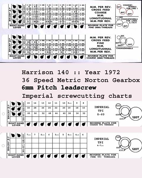

You'd need a 63T gear as a minimhmGood morning
Wanting to try some imperial screw cutting on metric 140 ) gears on the lathe are 100 80 25
My other gears I have are 120 80 60 50
Advice on what I would need thanks
My lathe has run 3d printed gears for a while now no issues at allAs mentioned above, you need a 127 tooth change gear. They can be quite pricey but an alternative might be a 3d printed gear that woyuld fit onto say a 80T or 100T change gear.
e.g. https://www.thingiverse.com/thing:1808219

First, a 127t gear is quite large, so may not fit in the space available. Hence, unless you know for sure that a Harrison 140 will accommodate a 127t gear, the statement may be problematic.
Second, as stated, the machine is a metric machine cutting imperial threads. That means the 127t gear would be a driver, not, as is usual the other way round, a driven gear, directly on the leadscrew. Being a driver, it has to be higher up in the train, making the physical space challenge above even harder.
The manual linked to above and the thread linked to above would also seem to disagree with your suggestion.

This website will tell you how close you can get with your current gears.
