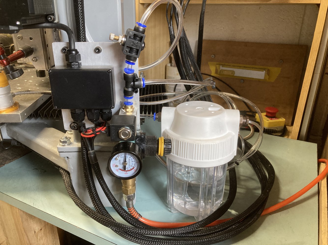

I think you have the wrong end of the stick. You absolutely don’t want a squirter! It won’t be a drip as the pump is used to dose a compressed air stream with a tiny amount of oil pointing at the tool. The oil provides the cutter a little lubricant and the compressed air cools the cutter and blows away the chip.
