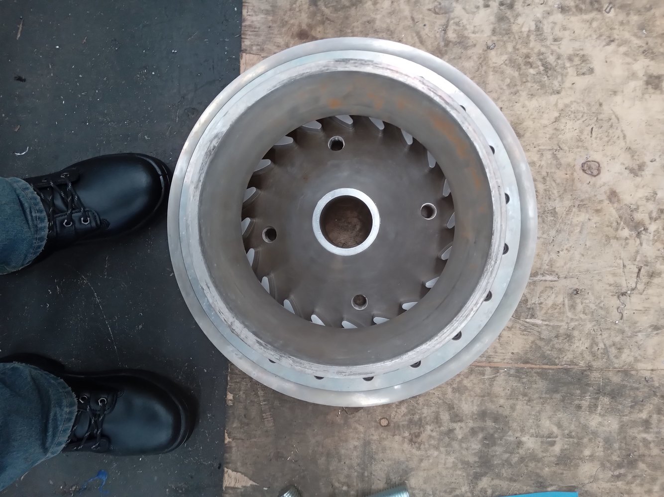

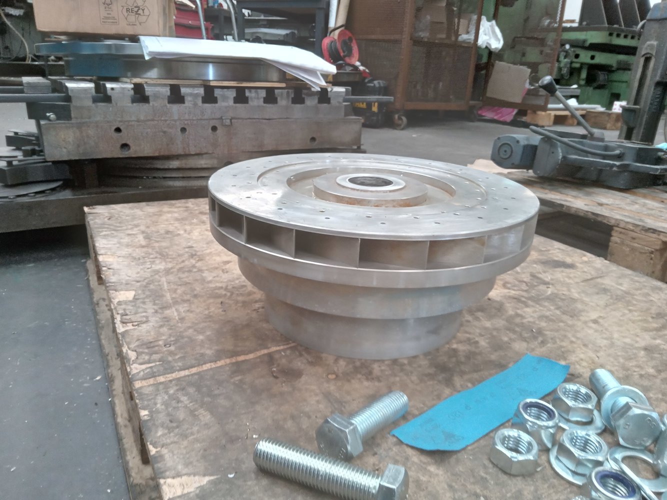

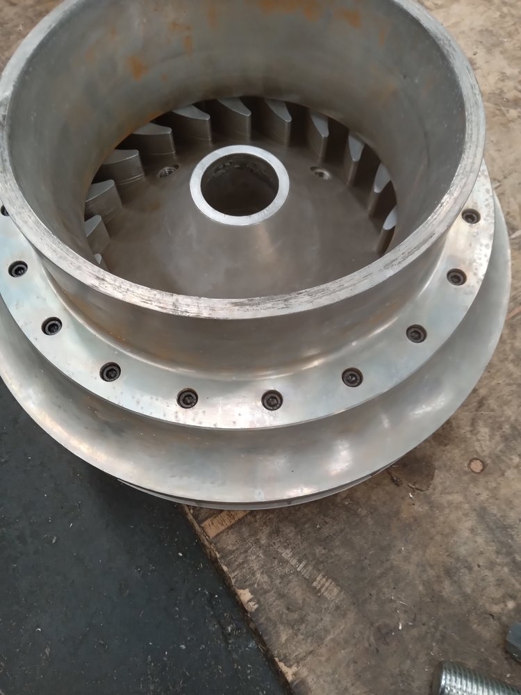

Fing big borer in the background!Couple of pics of the inside bit that spins around as the water flows through it. And to answer @addjunkie s question, the guide vanes are indeed adjusted to allow more or less water through as it runs. It comes in at the outside of the spinny thing (called a runner, not an impeller), out the middle.
View attachment 354359View attachment 354360View attachment 354361
Office boy boots!!Those aren’t working boots? Lol
Looks like new boots day! Not mine.Those aren’t working boots? Lol
I was only yanking your chain my friend.Looks like new boots day! Not mine.
The borer is what they used to bore the centre out of the turbine once all the stainless rings had been welded in. The runner is a one off test piece in aloomium, the actual ones will be stainless steel two piece with stainless internal guide vanes - something like 22 piece, plus bolts. With any luck I can polish it up and hang it on a wall somewhere.
