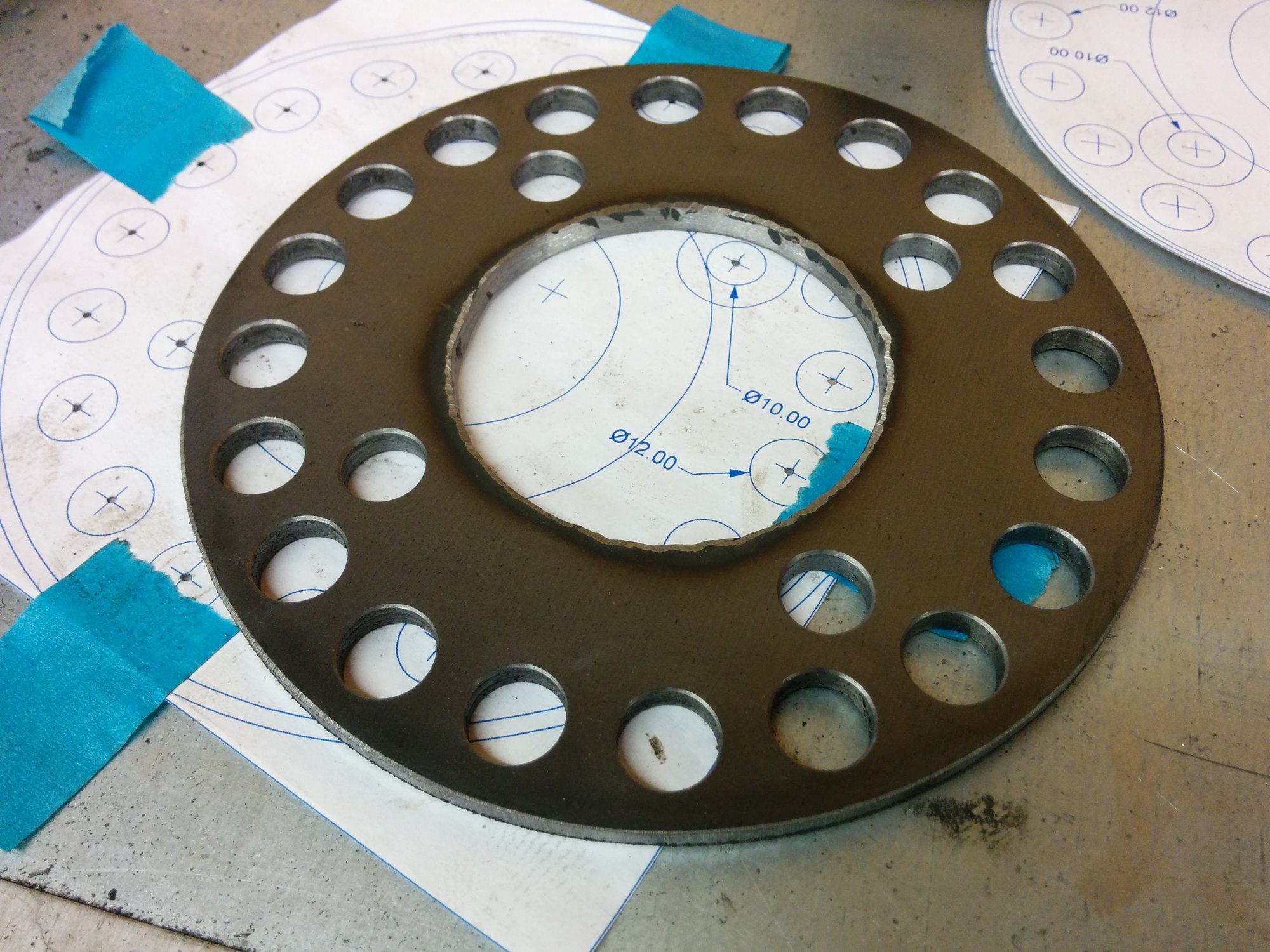

What make were they & where did you buy them from?I bought 2 sets of 3 step drills - about £7 per set, one imperial and one metric. They've performed really well drilling a couple of these indexing discs in 5mm mild steel.View attachment 132770
I should have said that I pre-drilled with 6mm jobber before going through with the step drills to 12mm and 1/2". Benefit is they also edge-break nicely.
