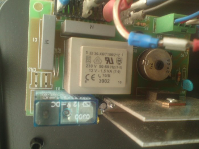

you shouldnt need to press the trigger either there should be power to that transformer as soon as the welder is switched on
Good to hear, many don't post back any final result.
Also a bit of an upgrade. The stock is something like 300ma. So will not work as hard driving the relay.
We'll have to remember the part for other SIP/Cosmo welders.
