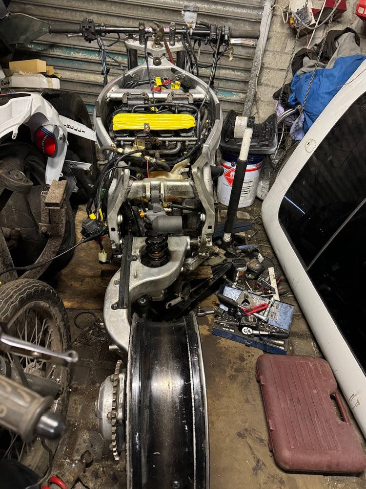

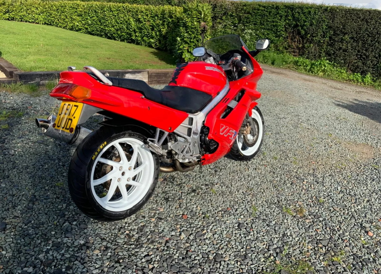

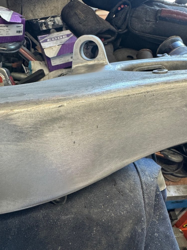

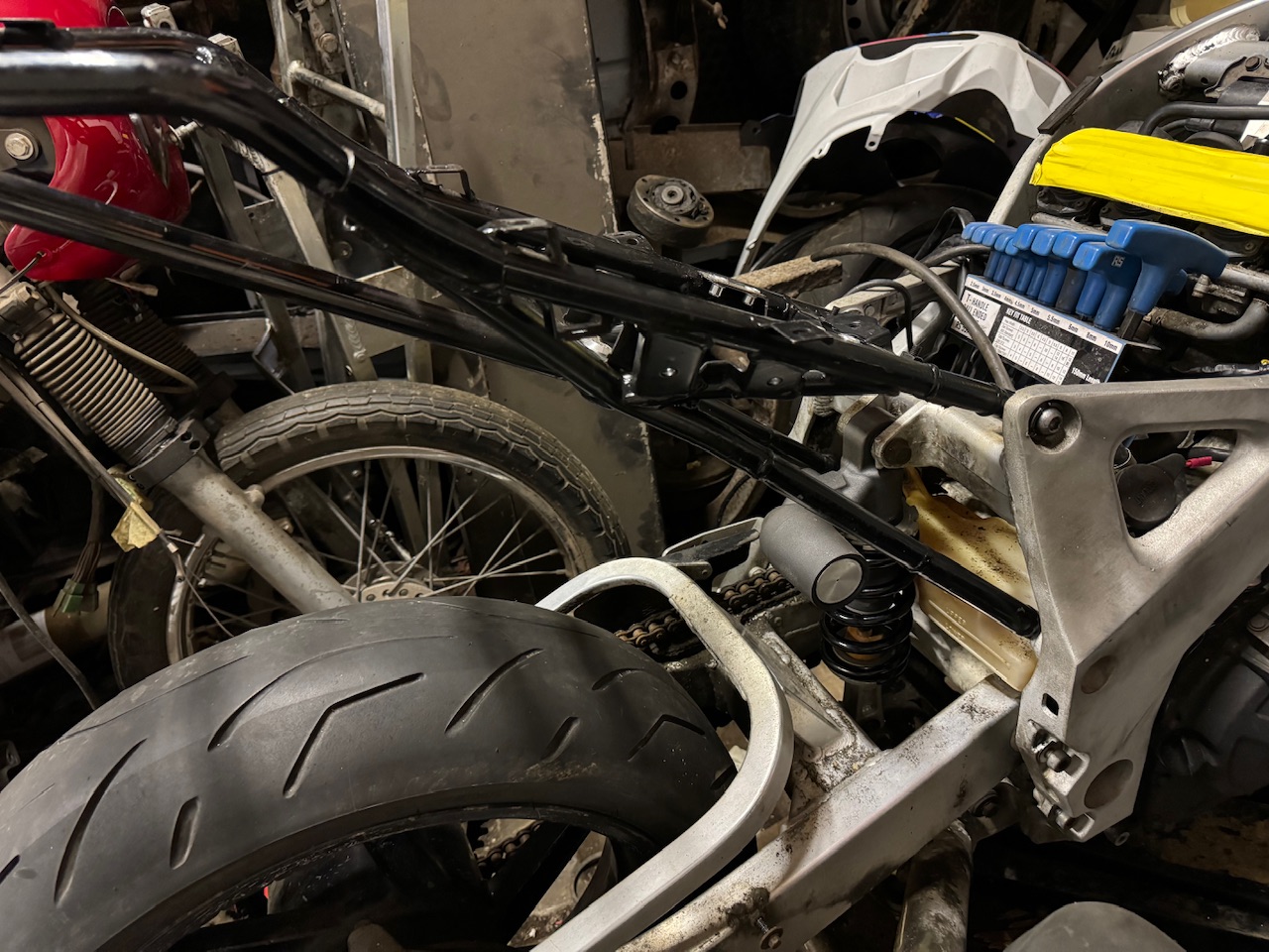

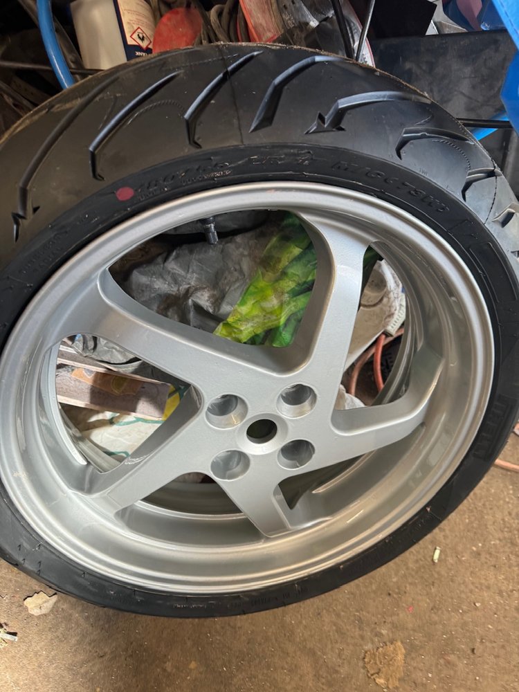

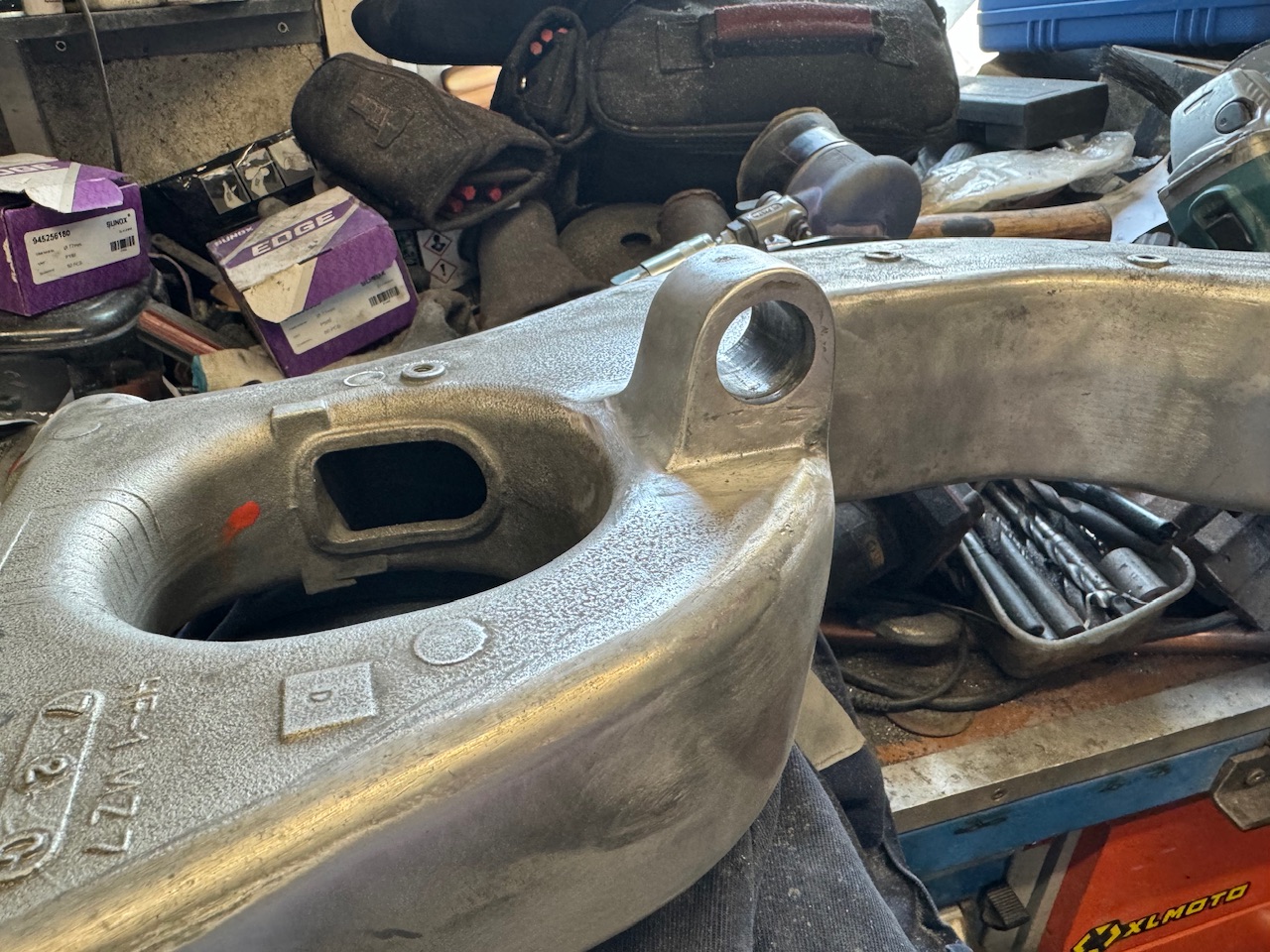

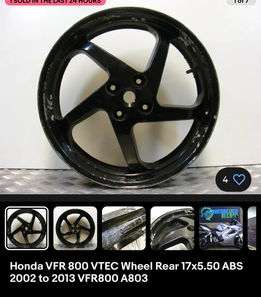

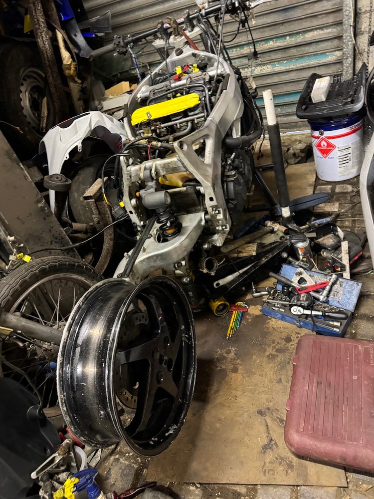

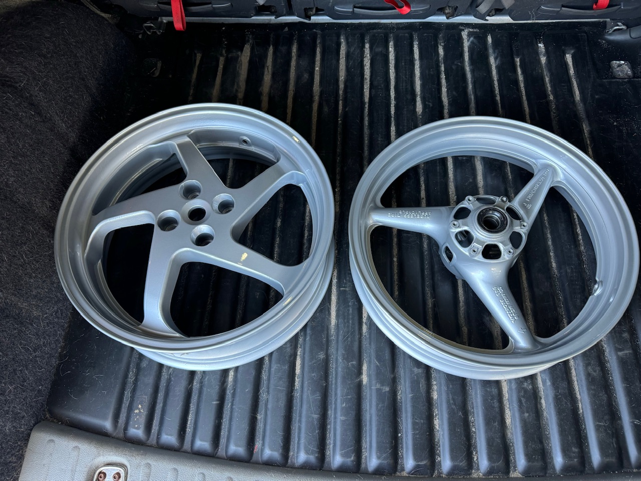

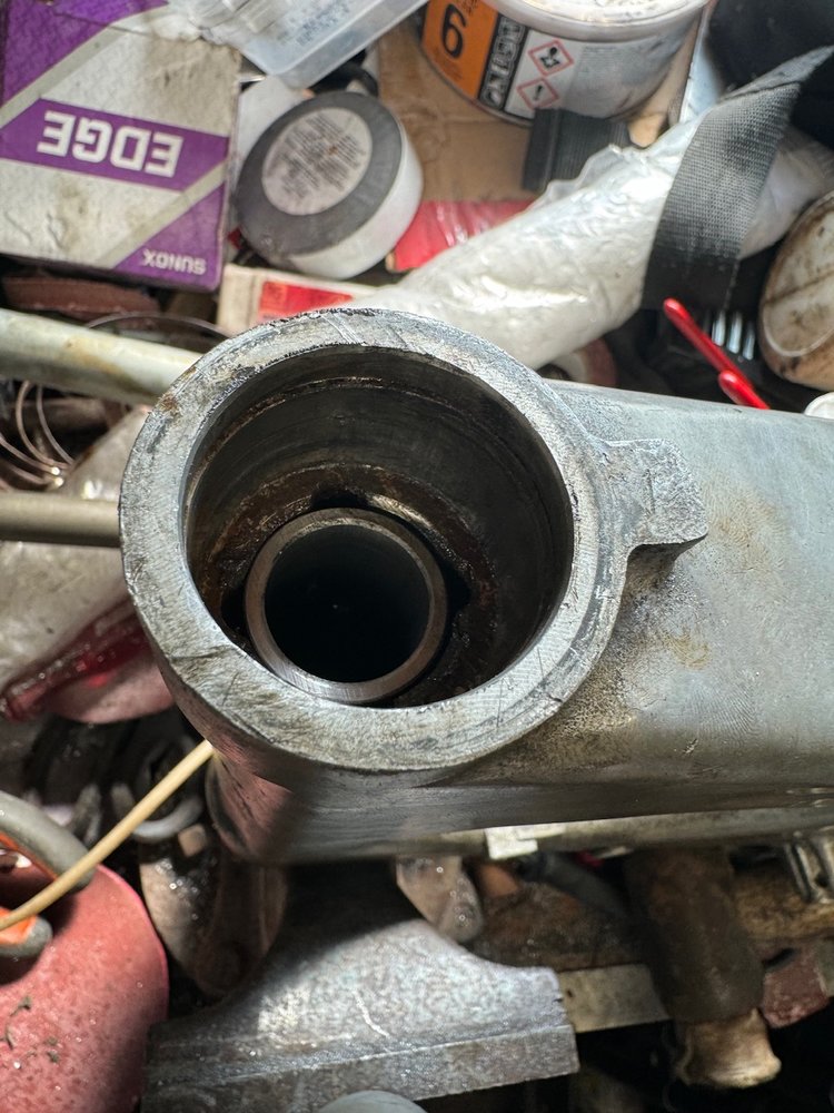

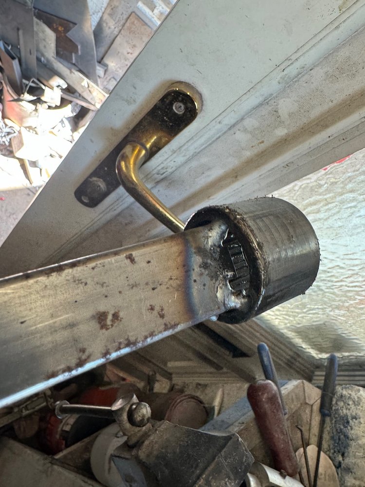

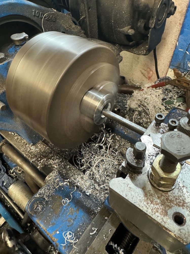

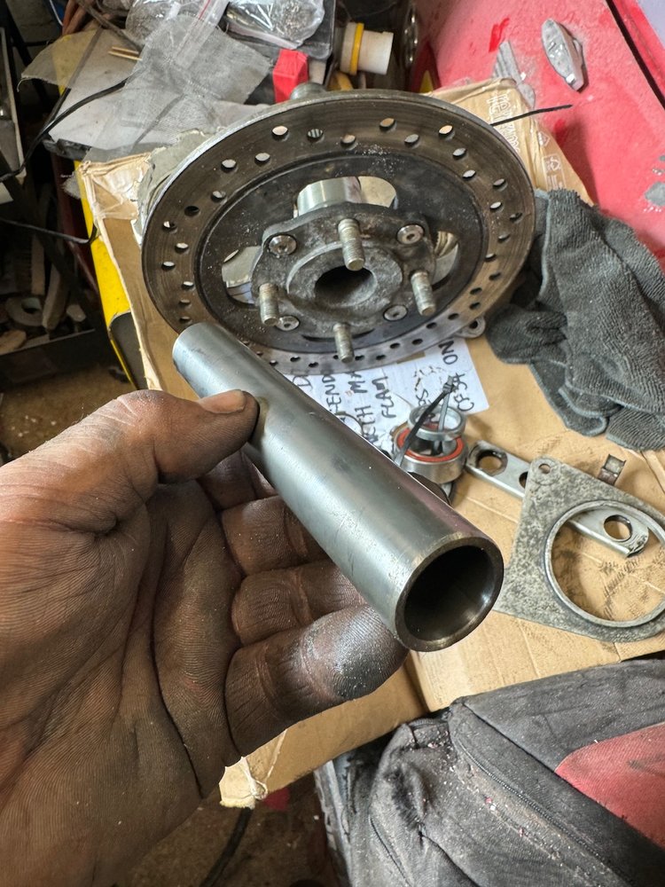

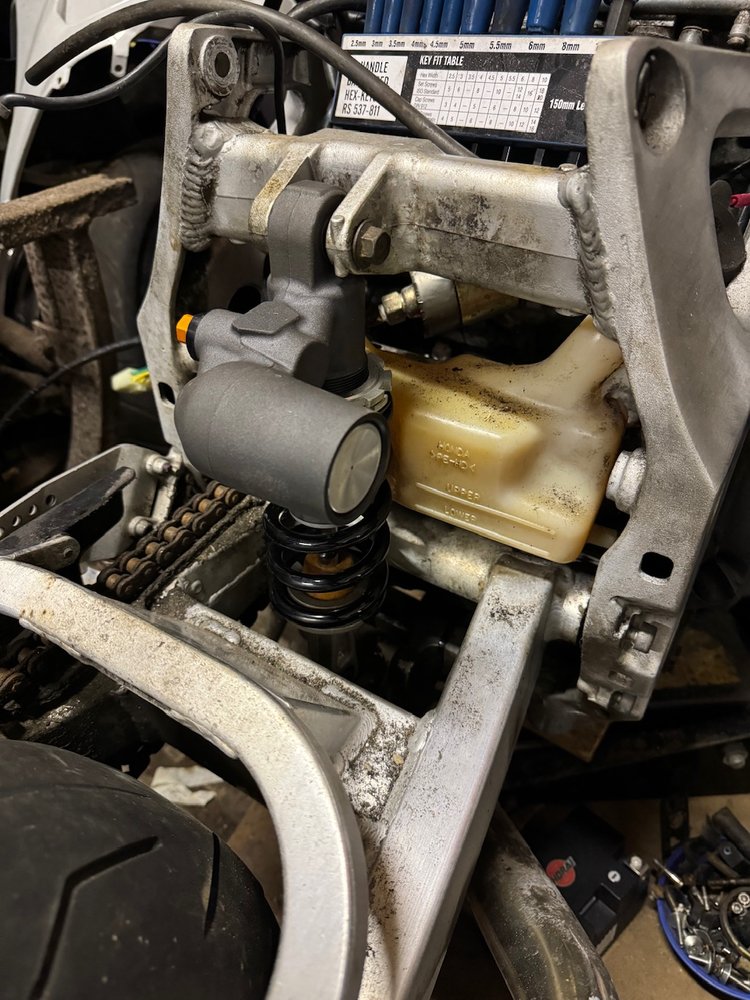

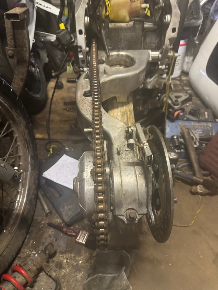

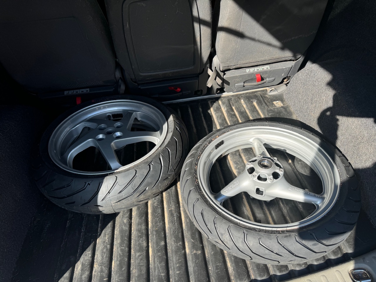

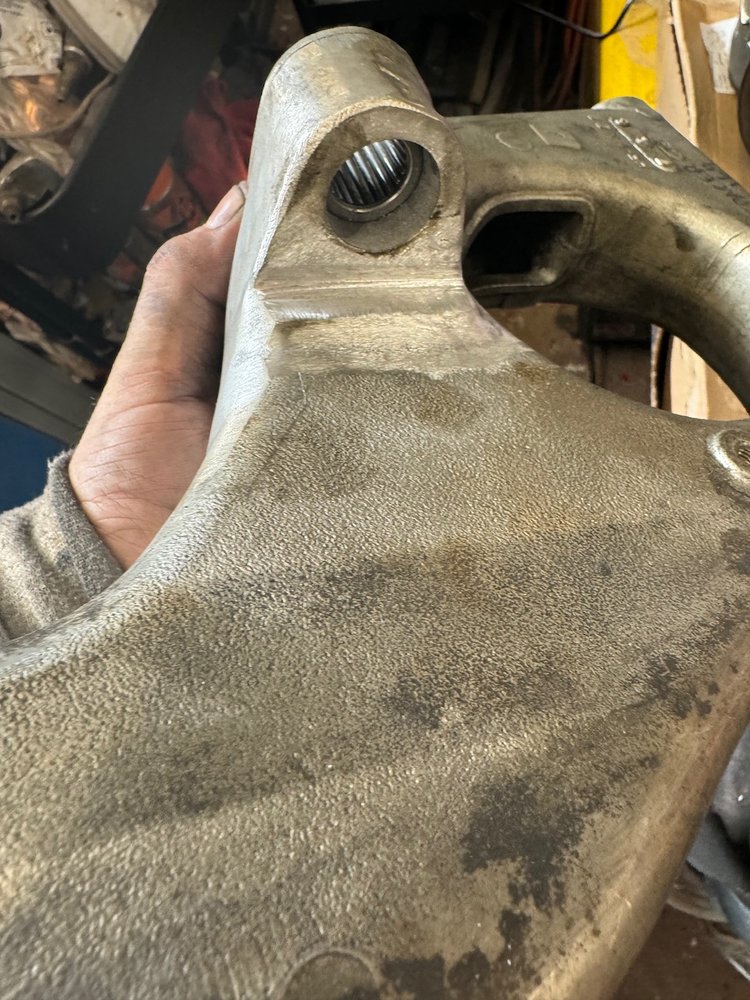

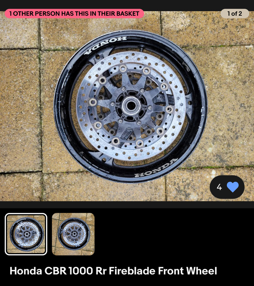

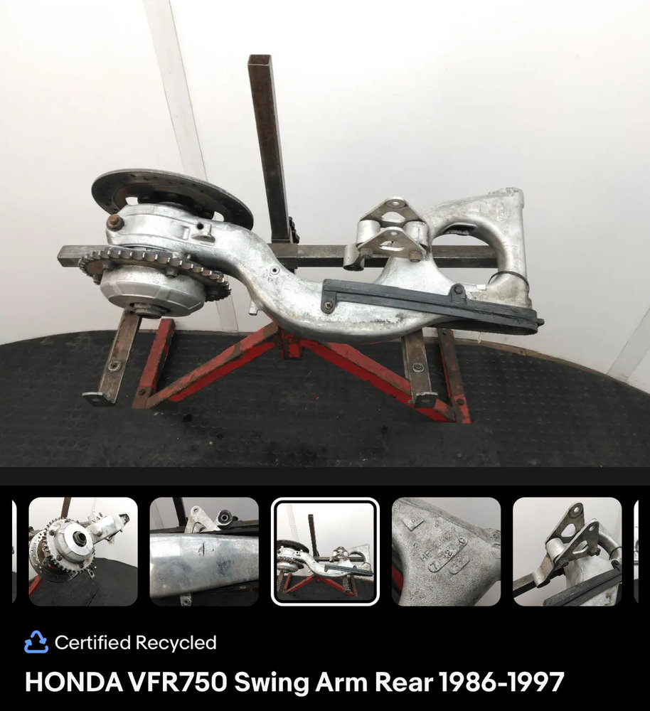

Just bought a 94-97 VFR750 swingarm (has to be the 94-97 for the 94 blade and bonus is the Blade shock fits straight in) and I bought a 97 on VFR800FI 5.5” five spoke rear wheel but I really want the earlier 90-93 8 spoke wheel but there’s not many spares about for them. Weirdly the 94-97 wheel is 5” which is smaller than the standard FireBlade wheel so that just won’t do.
Anyone got anything kicking about?

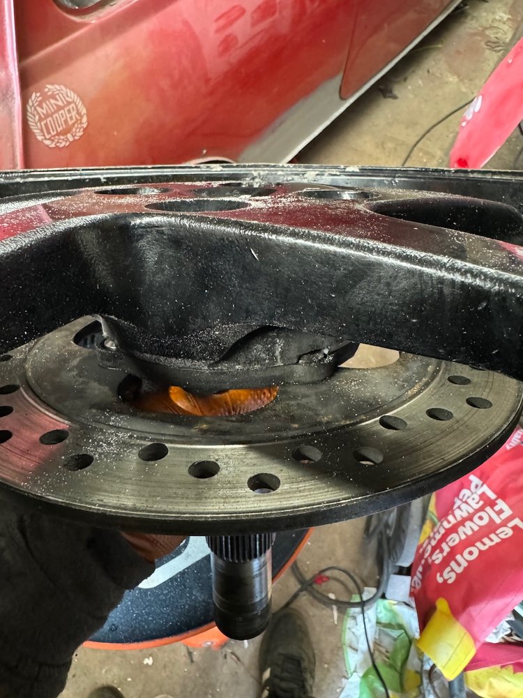

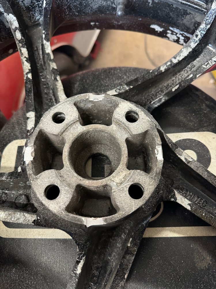

This is what I really want but the fiver will do me until I can get one. I’ll need to buy Ti countersunk BMW brake bolts to swap out the VFR ones as the earlier wheel is notched for the nuts on the hub but you can fit countersunk bolts and fit the nuts at the rear.

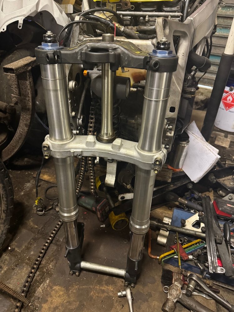

. Apparently a 1000RR front wheel fits too with minor work.
