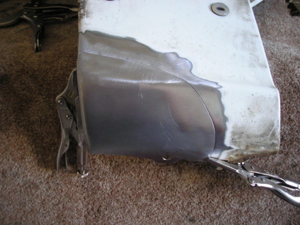

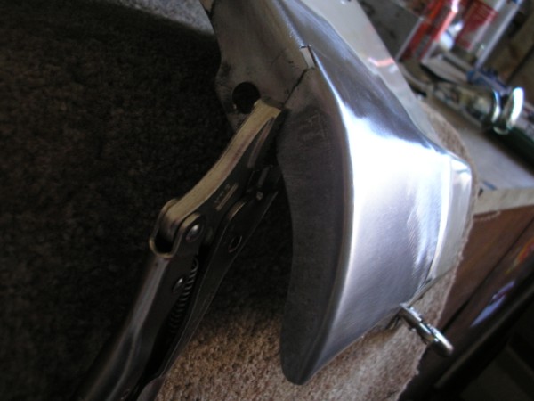

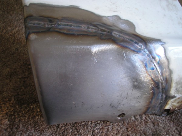

) got closed up a bit after tacking the patch in but while gaps can be bridged you REALLY want a daylight tight fit
