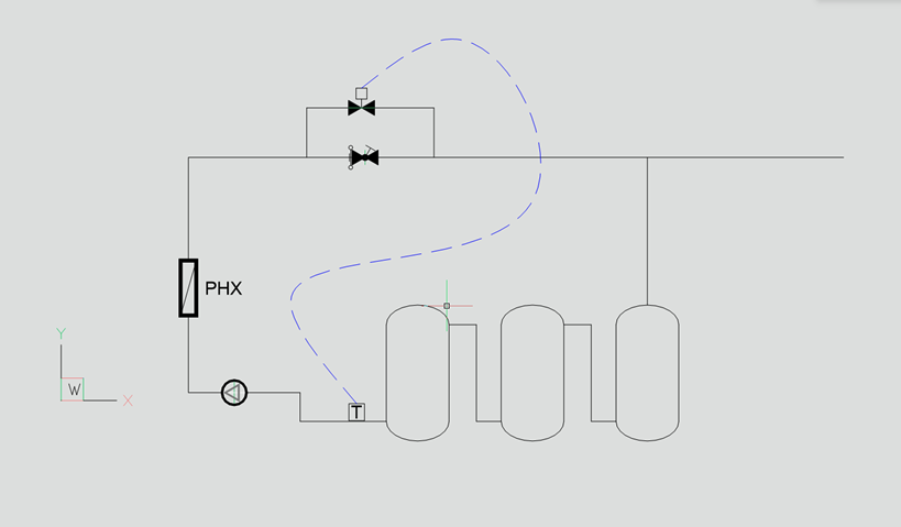

The more you describe to system the more It needs more than just a simple valve. Youve multiple variablesI'll try Herz tomorrow
my problem is the flow rate will change depending on the water temp into the heat exchanger... cold mains water the flow will drop right down, but when it's just circulating tank water (no draw off) the input temp will steadily rise... soI could do with increasing flow to match and keep the boiler working 100% and reheat the water asap
I figure a valve that's opening/closing to keep water tank at 80'C will solve all my problems
Can you clarify that my understanding of this is correct-
You need to restrict flow, so that only 80degC water comes out for use?
However if that temperature is being met, you want to divert excess heated flow into the tanks?
