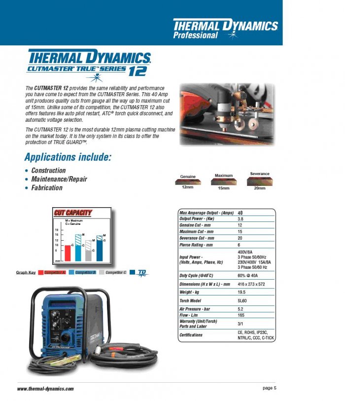

Hi,
I'm new to the forum and am after some advice on the above machine.
Reading the datasheet for it (which hopefully is attached if I've done it right!) it says:-
"- Input Power - 240V/400V 15A/8A 3Phase."
From this I read it as selectable for 240V Single Phase use. Is my understanding correct or is it 3phase only?
It pretty much suits my needs down to the ground, but I only have a single phase supply. If this is only for 3 phase, can anyone recomend a good single phase equivalent in this sort of price bracket?
Any other help or advice welcomed, I've noticed you guys don't mince your words, which is what I need!
Cheers
James
